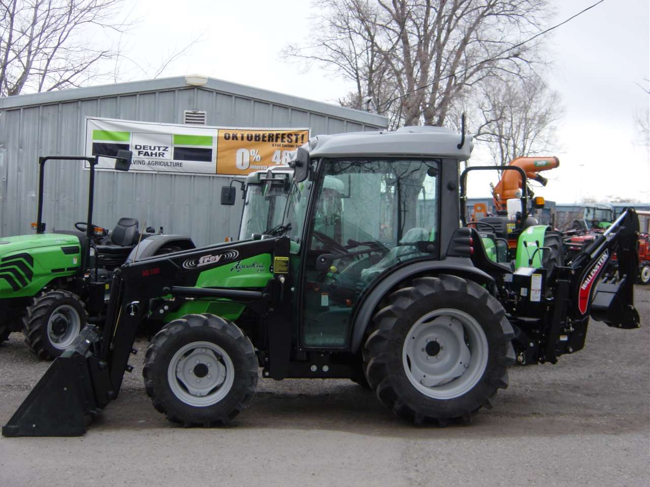

I have a local Deutz dealer now and finally got a chance to stop in and look at their Agroplus S series. It was too narrow for my use and they have three Agroplus F sereis tractors coming in next week that I am going to look at. The one I am interested in is the 100 with front lift and pto. I will get some pics when they arrive.
What are you looking to run off the front? Just remember front PTO hp is half of the rear. The Frutteto version (fruit) is still going to be quite a bit narrower than a field version, are you using it in an orcahrd or vinyard application?
Buck
/ Deutz Tractors? #58
Buck
I will use it mainly in my vineyard and orchard but also for haying.
Depending on the added cost I have been wanting a front hitch to hang a mower off of so I can mow while spraying. This does two important things, one less trip through the rows and more accurate spraying as I know exactly which rows have been sprayed so there is no missed or double sprayed rows.
I have also though about hanging a 3pt boom sprayer on the front so I can keep an eye on the sprayer easier. Ever since I hurt my back it is hard for me to keep turning around so the more implements I can mount in front the better. One thing I would love to try is to hang a post hole auger on the front as I could then have the trailer with post behind me and the auger in front allowing me to steer the auger into the row a lot easier then when mounted on the rear as the front tires don't hit the vines and wire as easily as the larger rear tires.
I would go with the Agroplus F 100 if I did get the front lift option as it would give me plenty of power for my use/operation.
