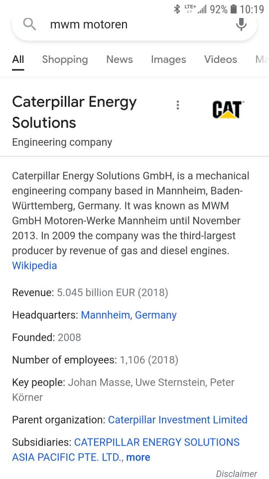

their water cooled diesels are very similar to MWM?
   / Deutz vs SAME vs SDF? #13
Can't confirm that. Don't know enough about both. I once read through the history of Deutz. There were a lots of aquisitions until they finally became SDF.
   / Deutz vs SAME vs SDF? #14
Just did a quick search for MWM. apparently CAT took them over.
