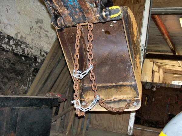

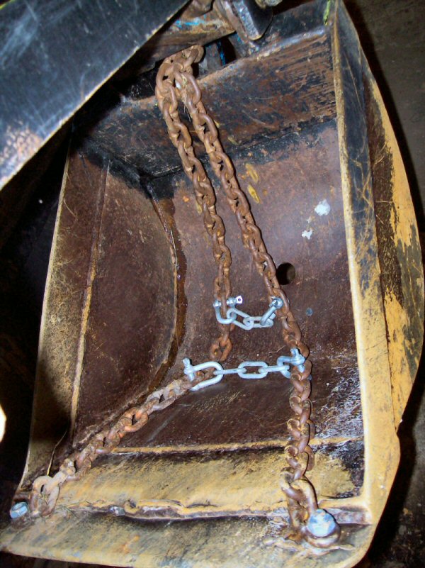

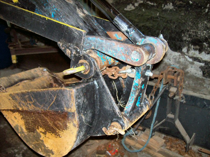

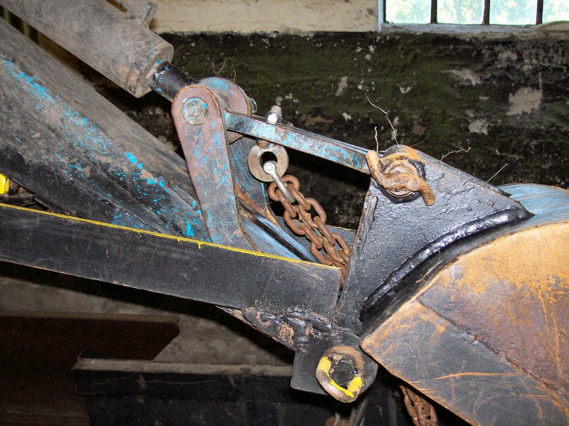

After the advice I received and some study of the patent applications I fitted a chain to my bucket. After testing in heavy clay I found that it was very effective in emtying the bucket :) allthough not 100% effective!

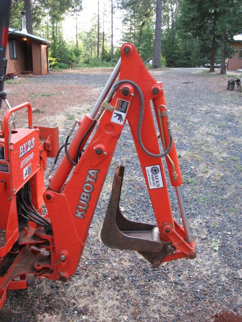

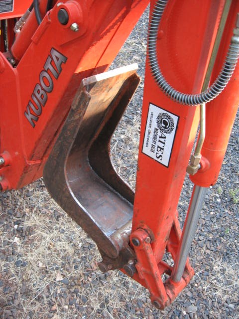

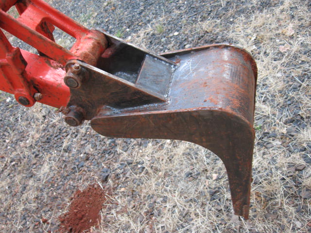

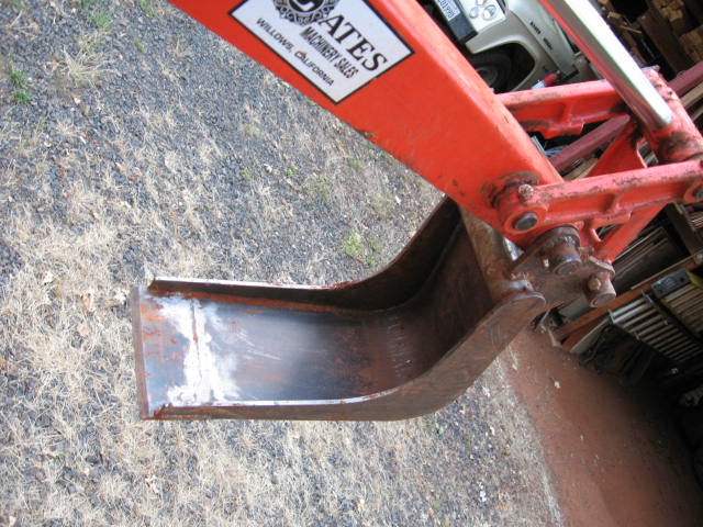

I had that thread a while back which was mentioned earlier in this post
http://www.tractorbynet.com/forums/build-yourself/112977-ejector-bucket-design.html

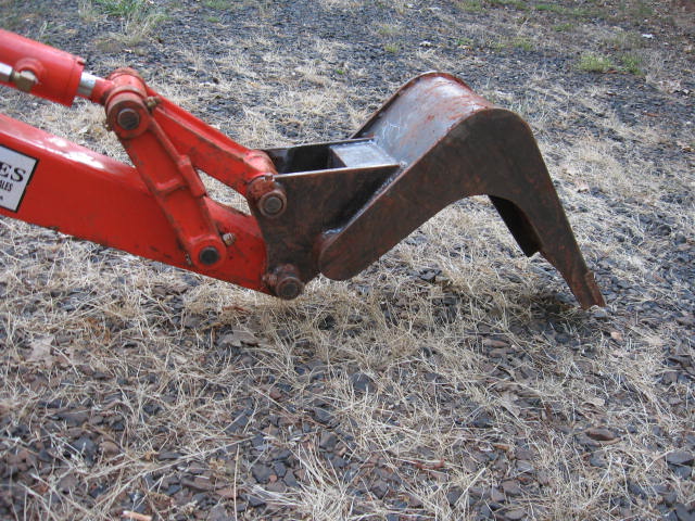

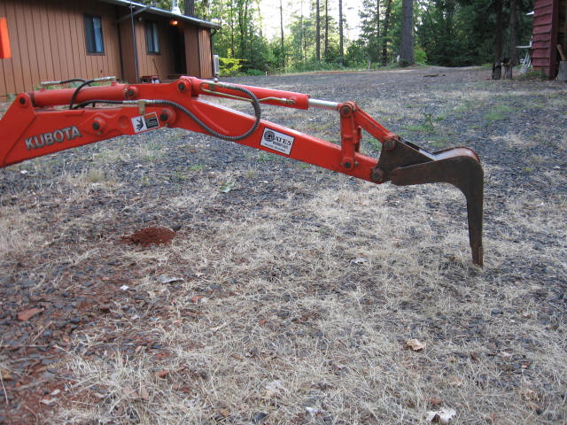

I ended up building the "banana bucket" and I have found it very satisfactory for my clay.
If I start digging too early in the spring when the clay is still very wet I'll still get some sticking in the bucket but even then just a bit sticks in the back of the bucket and I can still dump most of the load. In two years digging with it I can't recall needing to get off the tractor to clean the bucket. In late summer I'll have trouble keeping a full bucket after the dirt has dried out and crumbles. But between mid "early" spring and mid "late" summer the banana bucket works great!
I found I needed to revise my digging style a bit because I sometimes have to "balance" the load on the bucket as I am swinging to dump. The balancing act gets more pronounced as the season wears on and the clay gets drier and crumbly. It reaches the point where I want sides on the bucket and this winter I'll build some bolt on sides. It was actually on last winter's list but I built Kitchen cabinets instead :(.
The main purpose for building the bucket was needing a narrow bucket for trenching. I think I built it 7in wide. It is most effective when I'm digging a trench, ie. the side walls hold the dirt in the bucket until you clear the surface. I've put in hundreds of feet of trenches with it and I'm quite pleased.
If I needed to do more open excavation in clay I'd still consider building a wider banana style bucket; it was neither a difficult nor expensive build.

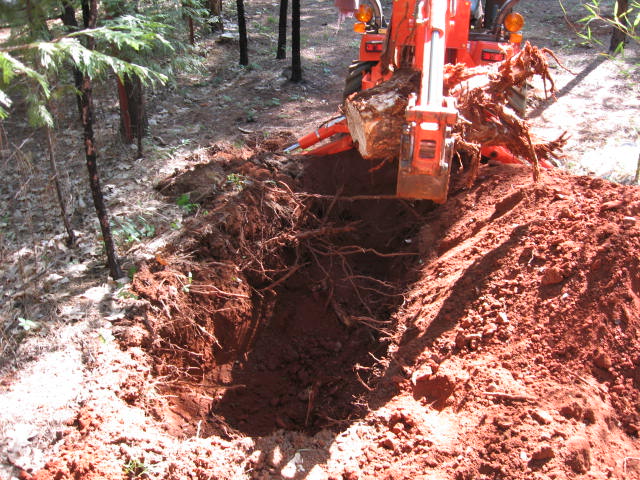

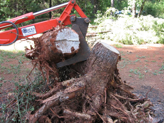

I have also found in many cases I prefer the banana bucket over the root tooth I built for digging stumps especially medium to large stumps (12" - 30" dia). I can remove much less dirt from around the stump than with my 12" bucket and I CAN remove dirt whereas I cannot with the tooth. The no-tooth beveled edge of the banana bucket also cuts through roots.
For the build I just used mild steel from the scrap pile, even the cutting edge, and I have had no problems with it. The cutting edge now needs sharpening but the rest is as good as new although I've tortured it in the occasional rock nest and powered up to the max pulling stumps.

Thanks for the compliment; but design was merely an eyeball copy of a design submitted on the above mentioned post. Ain't TBN great!
I am surprised too that the mild steel has held up so well. The banana bucket was an experiment and I did not want to spend much for something that might not work well. But no tweaks at all and I don't baby the thing when the rocks or stumps get stubborn. Mind you, I don't have too many rocks to deal with :). If I did I'd likely upgrade to a hardened cutting edge but I think I'd leave the rest as built.
So the mild cutting edge wants sharpening every hundred hours or so! Big deal! Pull out the grinder and give it it a dressing. Run out of grinding space; replace the edge.

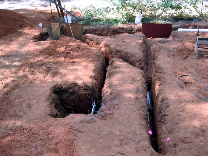

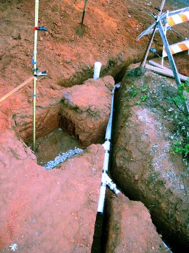

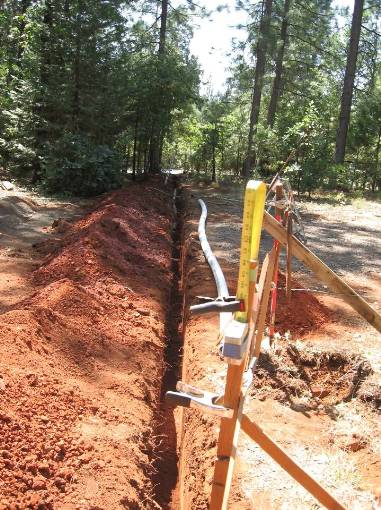

The following photos are from a project a year ago when I was preparing our orchard holes. We planted this spring. The dirt was pretty dry but you can get an idea of the nice trenches the banana bucket produces.
With clay soil we don't have very good drainage and I wanted good dirt in the tree holes. The problem with just digging holes and putting in good soil is that in the winter/spring the holes fill with water and literally drown the roots. Ah, this is not the first orchard I've attempted. So this project was not only digging the tree holes but also putting in a French drain into each hole and daylighting the drain about 80 ft away. While I was at it I continued the drain line past the orchard to the house and attached a couple of roof downspouts to it. The square holes in the photos are 3ft x 3ft x 3ft that I dug with the 12in bucket Then switched to the banana bucket for the trenching. I'd do a section, back fill, then do another couple holes, backfill, continue.
Here is the main trench out to daylight
And some tree holes with connecting drainage.

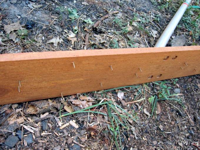

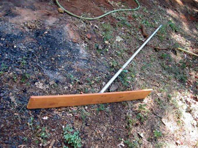

But...For us beginners trying to get an even bottom trench is a challange and another learning experience. I built a trench grading tool to smooth out my ups & downs. It is just a 3ft to 4ft length of 1x6 attached on a hinge to a swimming pool pole. I ran screws through the board to act as a rake. It worked great and ended up with very nice flat bottom trenches despite my learning abilities. I've gotten better now with trenches. I can keep the bottoms fairly flat. This summer's new learn was creating a flat bottom excavation for a concrete patio. But that's another story.
Here's the trench rake.
