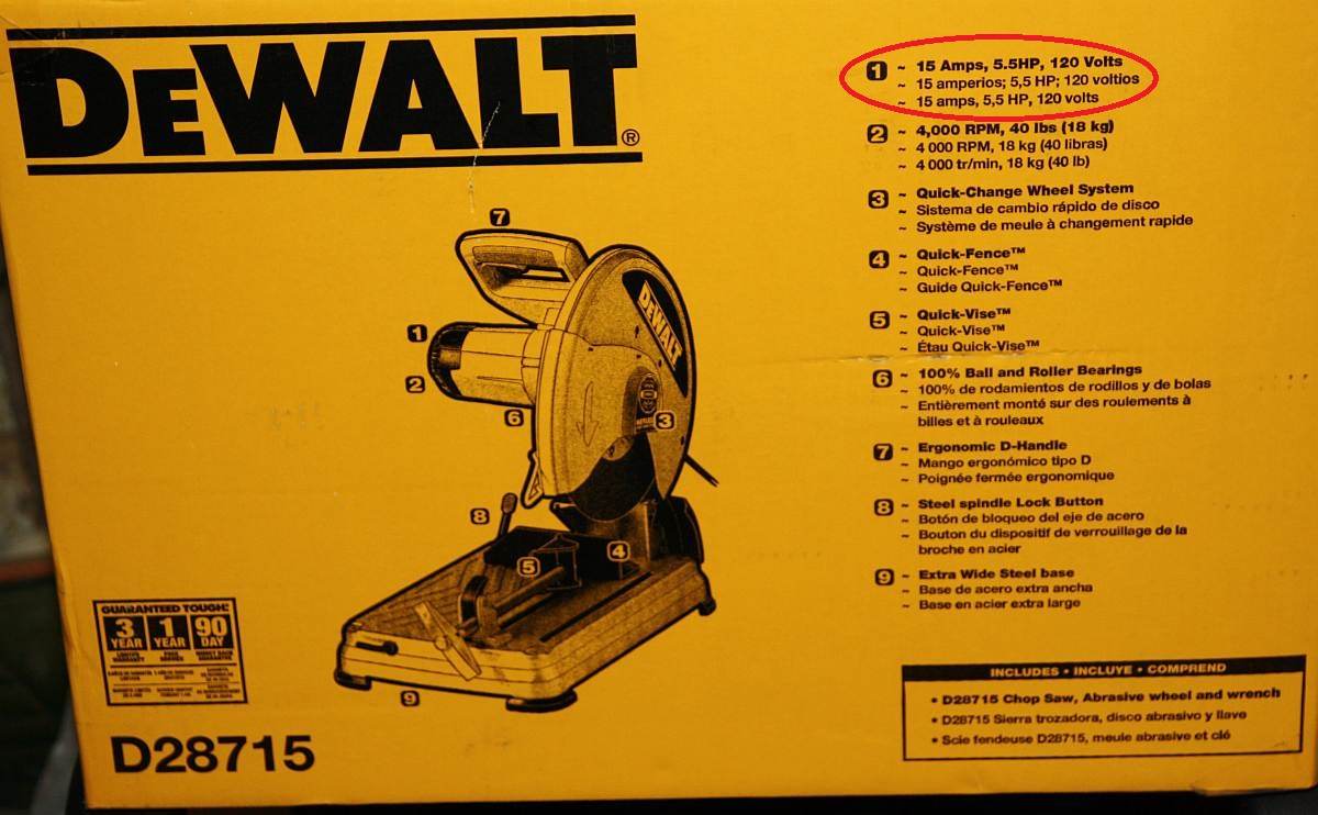

Where did you get 5.5 hp? Its listed as only 3+ hp (15 amp). Its essentially the same as my Milwaukee. There's a 2 : 1 difference in price between aluminum oxide wheels for these saws.

A buddy of mine and I went in on a Dewalt 5.5hp 14" chop saw from Lowes so we could make more accurate cuts for our little projects... my tractorette and his toyota offroader.
The first thing I cut was some 2x2x1/4 square tube and it seemed really slow, especially on the top flat and bottom flat. I cut some 1.25IDx1/4" pipe also, and that seemed slow to me.
Are all abrasive wheels made equal or is there a brand of wheel that performs better than the dewalt standard that comes with it?
thanks,

The box it came in.. :)
Looks similar to the inflated HP that the compressor manufacturers tried to feed to consumers.
15A @ 120V is 1800 watts. At 746 watts/HP, that equals 2.4 HP and that's before the efficiency of the motor is factored in. Once the efficiency of the motor is taken into account, it will probably be about 2 HP at the most.
