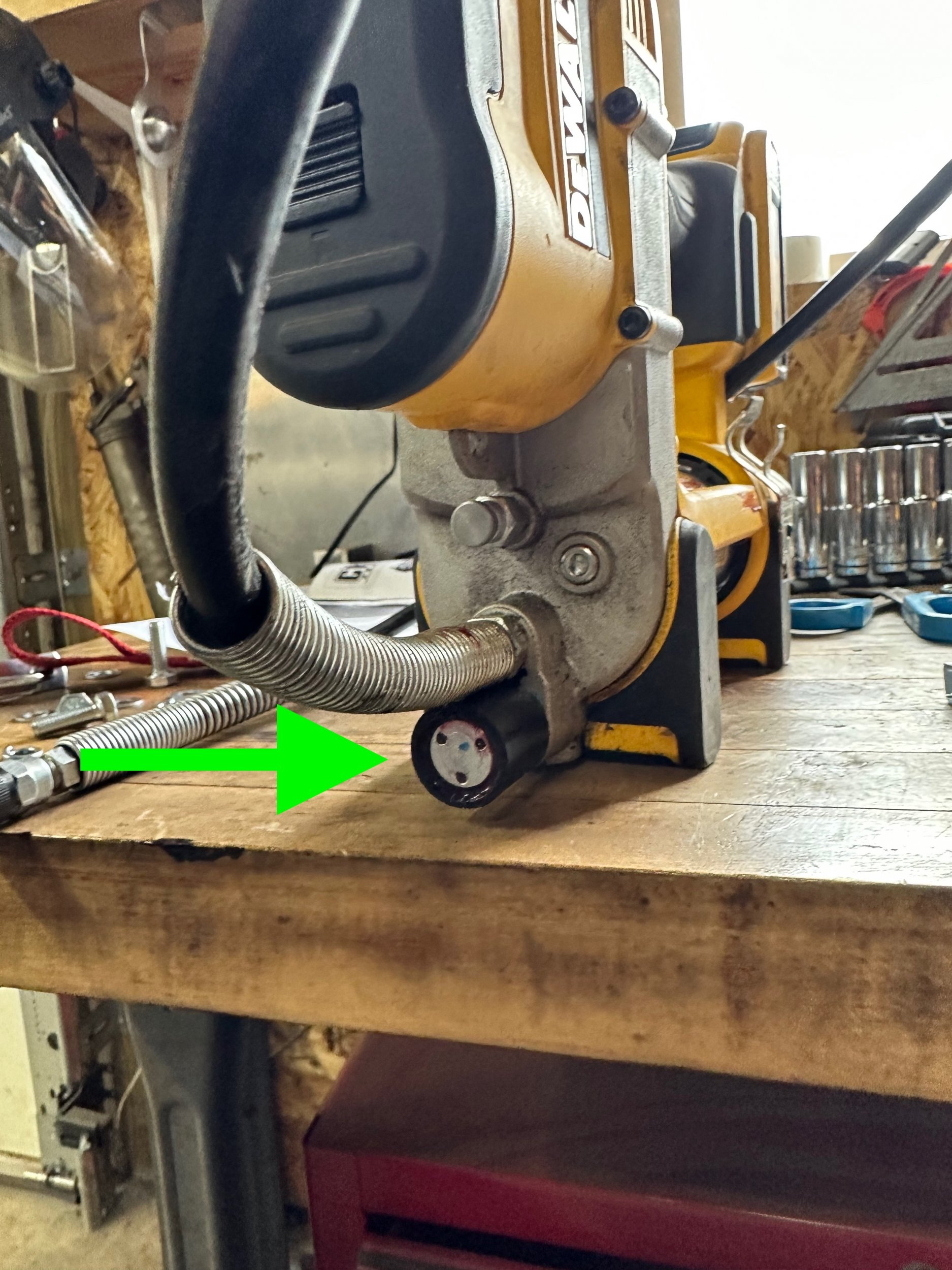

Does anyone have a problem with the Dewalt grease gun leaking here (please see arrow in photo).
Any idea how to fix it?

It's the pressure relief valve. Mine pumped a load out once when the zerk fitting was blocked. If it's leaking under normal use try getting on to dewalt as it likely faulty.
/ Dewalt grease gun leaking #11
Thanks - the gun sounded under a lot of pressure when I hit the last two fittings so that makes sense. Appreciate it.
