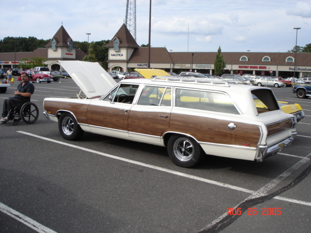

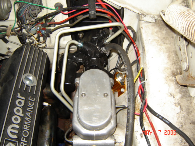

I just did a hydra-boost swap into my bro's 69 Coronet 500 wagon last spring. We used a Chevy/GMC 1500 unit. He researched this for almost a year before choosing the truck piece (over the van & Caddy parts among others). One thing I remember him mentioning was that those small van hydra-boost units have a reputation for being problematic.
Having driven his wagon for the first time a couple weeks ago, I have 2 observations:
First, I don't care if this thing does weigh over 4500 lbs with both of us in it, with 550HP & 590 lb/ft on tap it's FAST!
Second, with the hydra-boost & 11.75"/11" disc/drum brakes brake effort is very light & linear.
