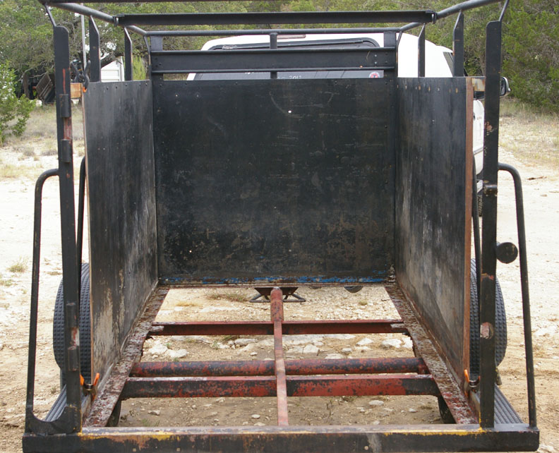

More to chew on. Having read all of your input I was ready to shorten the trailer by 12 inches. I agree that moving the axle would be to much work and trouble.

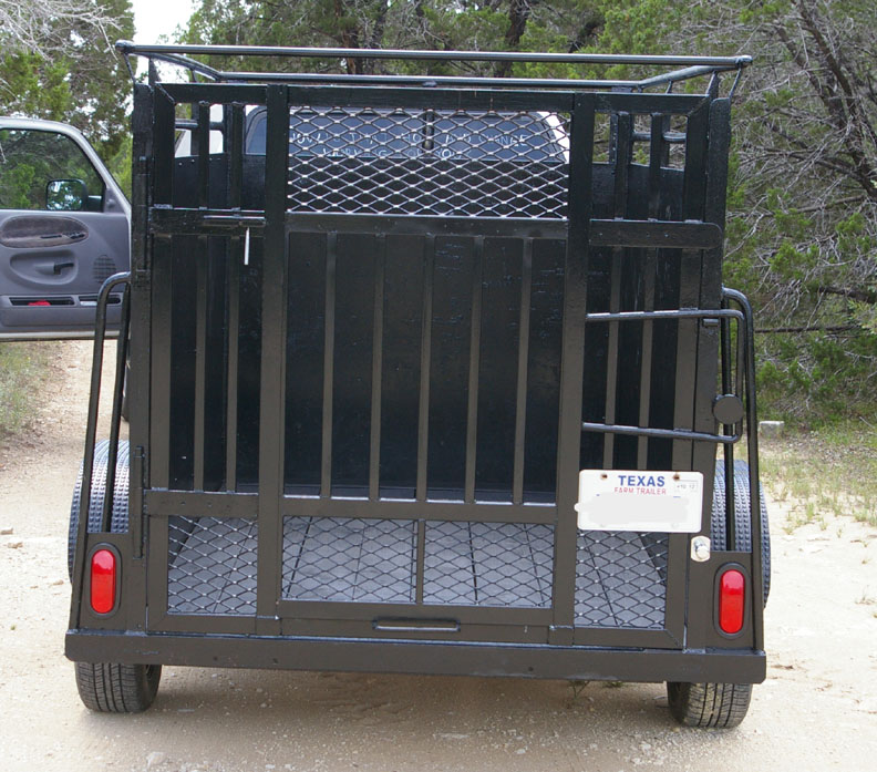

One thing I failed to mention at the beginning was the floorboards had been removed from the trailer (Rear). I am thinking that added to the swaying, but here is what really contributed to the problem. Whoever built this thing was really into building for strength. The gate consisted of two parts; the first part is hinged to swing out (Gate). The gate is build from angle and flat stock all of it 5/16" thick. The gate, as seen in Pic 2, weighs at least 125 pounds. Inside the gate, he added a lift gate (Lift Gate) which I first thought was made from 3/4" OD round pipe. Wrong! It is 3/4" solid round stock. It has to weigh between 75 to 80 pounds.
Once I had removed the gates, I took the trailer back out on the road and it never even tried to sway, even at 65 mph.
I do intend to replace the car tires with trailer tires and the gate will be replaced with a new one built from 14 guage square and rectangular tubing.
For TO-Bud, the spring bushings are definitely not plastic or even nylon. They are steel with grease fittings. Those springs are definitely "Old School".
Thanks for everyone's input. If you are interested, I will post pictures of the completed rebuild. Once finished, I hope to be able to sell it for 1200 and $1400.

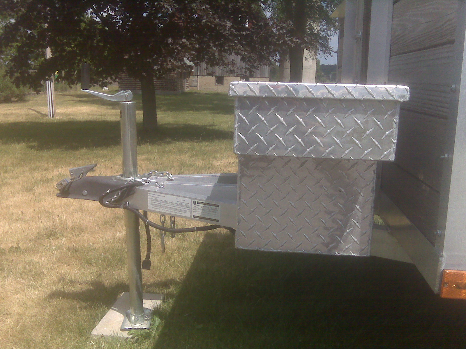

Guys, not to be critical of the suggestions to add a toolbox to the tongue, but it looks rather short for installing one. Attachment below shows the toolbox on my 6X12 utility trailer, I had to use a 12" deep truckbox as a deeper one would hit the rear bumper of my truck during sharp turns. You need a minimum of at least 28 inches, preferably more, from the coupler centerline to the front of the truck toolbox. I had 22 inches of space when I originally installed a standard depth truckbox on mine and the front of the box touched the rear bumper a few times when I was backing up.

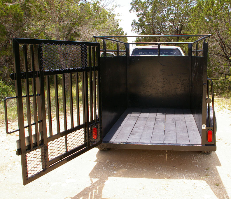

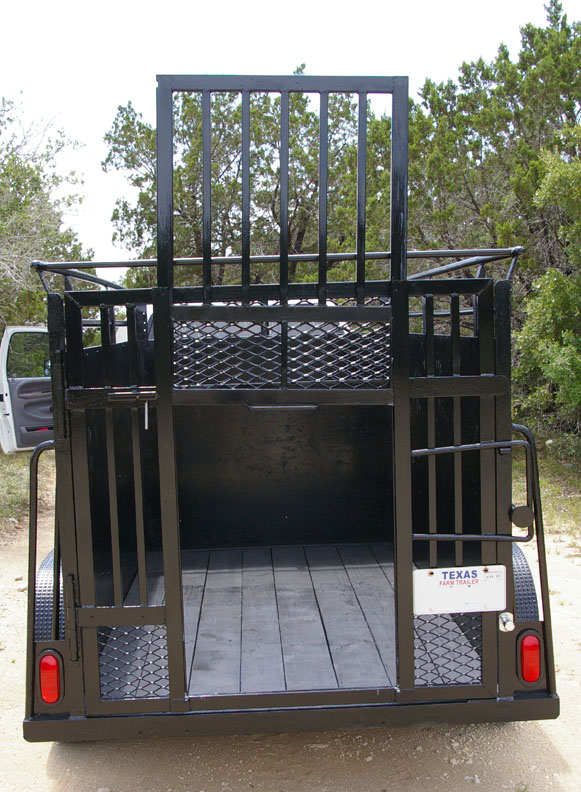

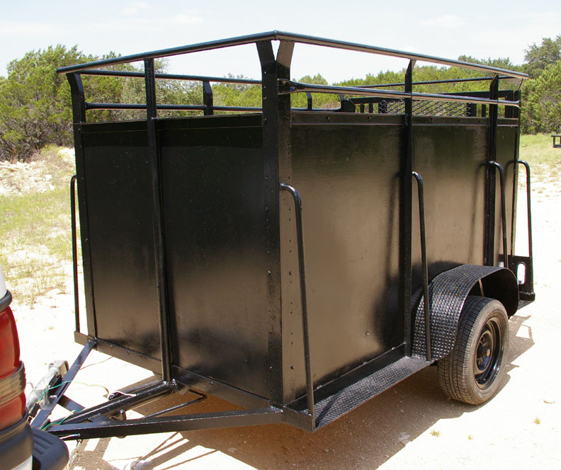

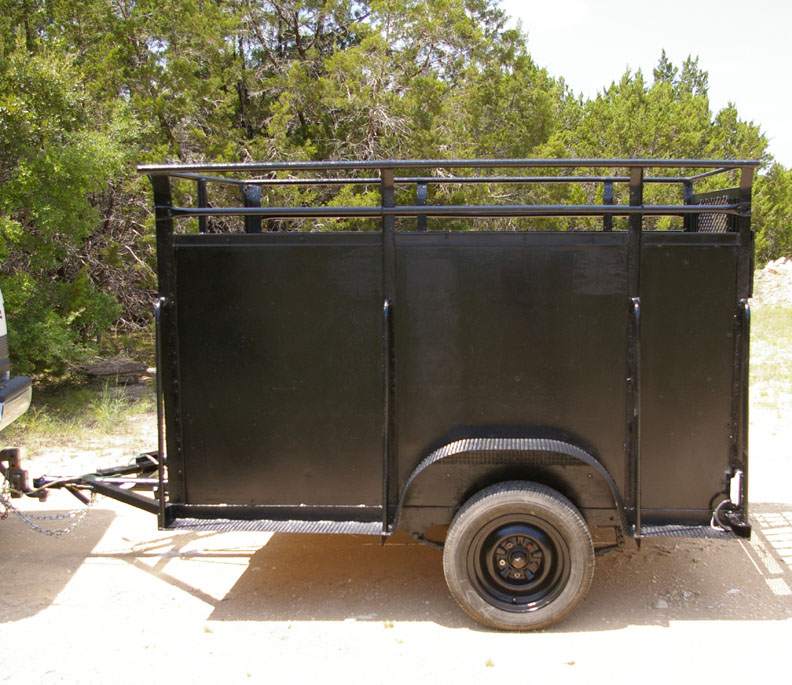

The rebuild is finished and, as promised, I am sending along pictures.
Thanks to everyone offering assistance. The trailer pulls now at 70 mph without any sway. This is what it took to accomplish it:
Twelve inches was cut off the tail end of the trailer.
The swing-out and center lift-gates were replaced with gates made from square tubing. The estimated weight reduction is approximately 100 pounds.
Time involved to make it all happen was about 40 hours.
It is now for sale for $1200. We will see how that goes with this economy.
