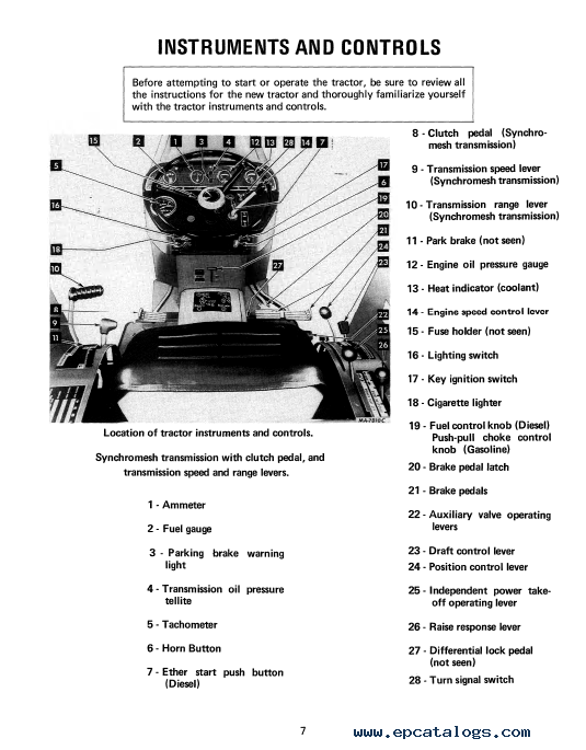

We can i find a diagram of the levers on 574 international tractor

Moss has posted a good picture of the 74 series.
Also there can be multiple remote operator levers for the hydraulics.
You could even have a TA lever (torque amplifier).
Also a mid pto was an option on these.
One of the more important ones is the little lever in the lower middle of the dash panel,
the fuel run shut down lever, it has a start position just about a quarter of the way up from stop.

I was reading the diagram. The gasoline version has the choke knob in the same place.
I sometimes miss my 2500B (industrial similar to 574). Fun times.

#3 and#6 the 1st notch is to ease the pto on rather than hit hard
