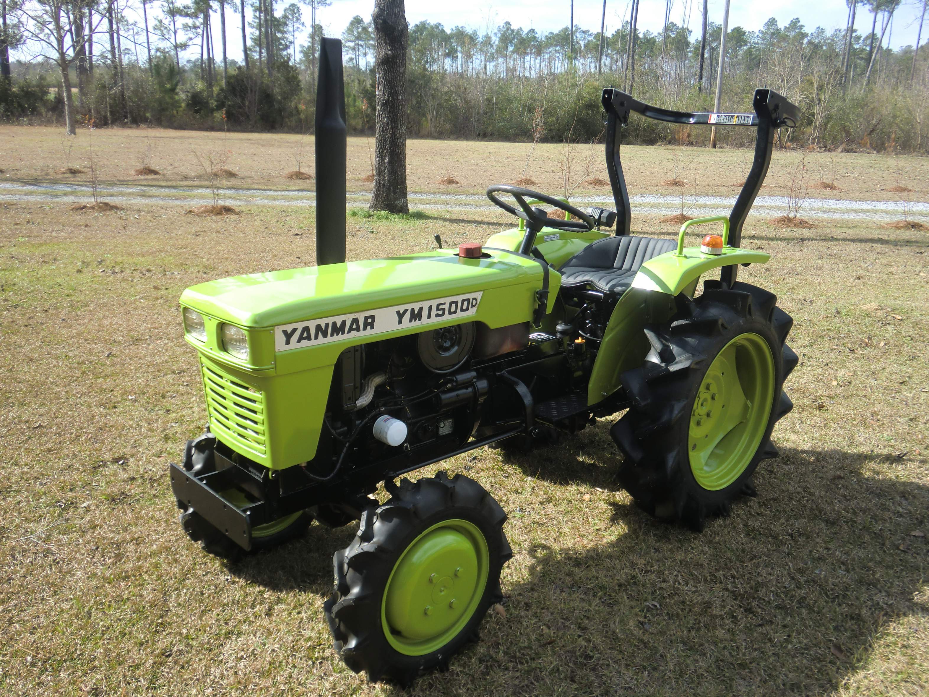

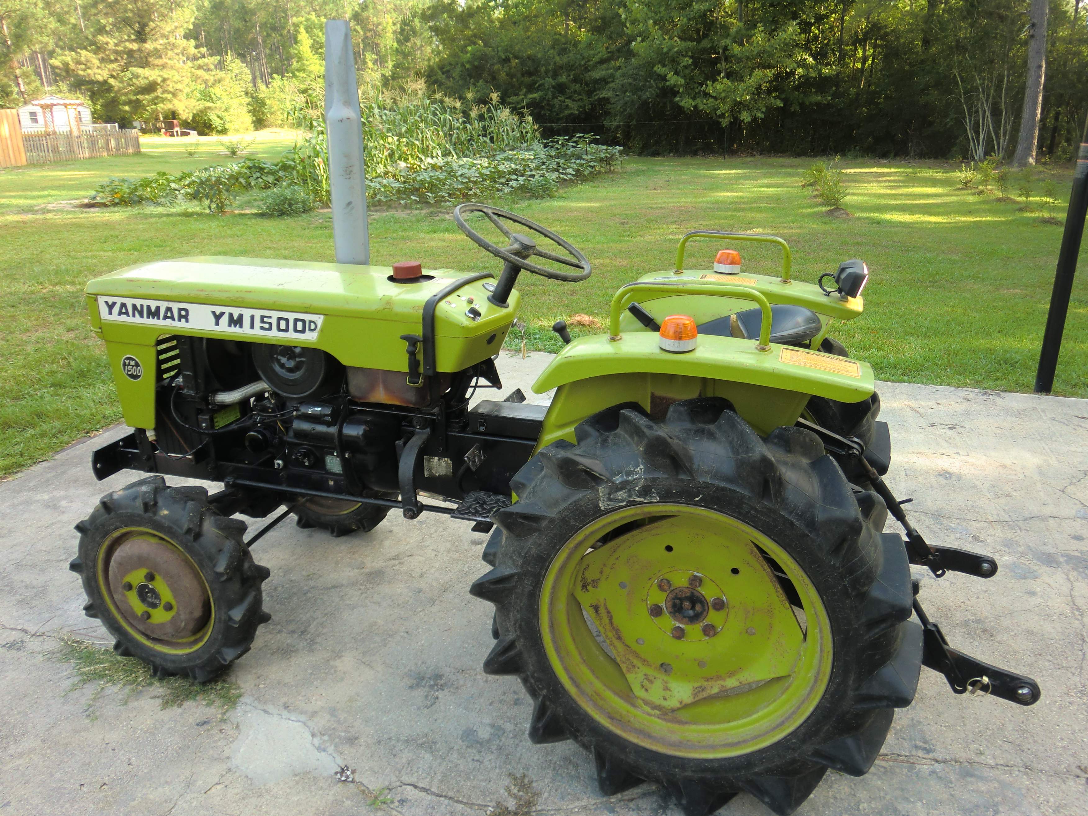

There were indeed YM1500 Green models which were the earlier year models (others here could probably list the dates of production for the Green's). These earlier models had a simple color scheme... Yanmar Green for all sheet metal & wheels and black for pretty much everything else. The brake housings are a very good way to differentiate between what was originally a 'Green' model as compared to the newer 'Red' models. The 'Green' models will also have a stamped (smooth) steel clutch housing as compared to the cast housing on the 'Red' models. My 1500D does not have a differential lock and I assume that is the case with other 1500 Green's (but am not 100% sure).
As California mentioned in a separate thread a while back, a good place to look for the original color is the bottom/inside area of the dash. This would apply to a tractor that someone has freshened up with some 'rattle cans' of paint, as the under side of the dash wouldn't typically get sprayed (not sure if any of the refurb'd tractors get this area painted or not).
I completed a refurbishment (no engine work was needed) and safety upgrades for my YM1500D (Green) early last year. I tried to match the Yanmar Green as closely as possible with it being custom mixed at a local Professional Paint Shop (Auto & Industrial Finishes) to a sample that was left on one of the front rims. I disassembled and sandblasted all green components to bare metal (all sides) prior to repainting. There is a before and an after picture attached. The colors are close, but the green will vary in appearance based on the amount of shade or light. The original paint wasn't in all that bad of shape except for the front rims. Once the rims got a fresh coat, I decided to go ahead with the rest of the green.

Thanks for everyone's replies. BatesBunch, your tractor looks amazing. I wish I had the skills and patience,plus the equipment to trick my YM1500 out like yours. Did you get your ROPS from Hoye and if no, where did you find it.? Was it hard to mount it? I've heard some horror stories.
I also like the seat. I have thought about getting an upholstery shop to do mine instead of buying the new model with backrest.

I saved a picture of your green YM1500 and may show it to prospective buyers, as I have a new to me YM226 to sink my money into now. I ended up with two YM1500's by chance, cleaned em up some and got em running. Now with Spring around the corner, I'm going to have to list em in hopes of recouping some much needed cash and barn space.
Thanks again, and if you can tell me about your seat, ROPS and any other tricks,please reply.

Thanks for the kind comments on my YM1500D. It was definitely a long term project with the refurbishing. There were times that I might go a month without touching it and then there were stretches that were pretty busy. It all started with some the seals starting to leak too badly. As you can see from the 'before' picture, the front rims seem to take a beating and had very little paint left on them.
I purchased my ROPS from Mr. Danny with Parker Equipment Company (Contact Us). He picked it up from Fredricks Equipment Company (Home - Fredricks Equipment) during one of his regular trips to Fredricks. I bought several parts at different times through Mr. Danny. He is very knowledgeable and was willing to ship via different methods to keep my cost down. I am originally from South Alabama and was able to coordinate the ROPS purchase so that family was able to pick up the ROPS during a return trip from Tennessee. This kept me from having to pay a large shipping cost. My son and I had to use a little 'friendly persuasion' to get the ROPS to slip around the rear axle case. It was a tight fit, but installation wasn't overly hard. I definitely feel a lot better with having the ROPS installed and having a properly engineered/approved ROPS was worth the cost.
My understanding is that the only OSHA Approved ROPS for Yanmar Grey Market Tractors are manufactured by Custom Products for Fredricks. I noted that there was little to no difference in price between dealers when I priced the ROPS, but shipping was always spendy due to the size/weight.
