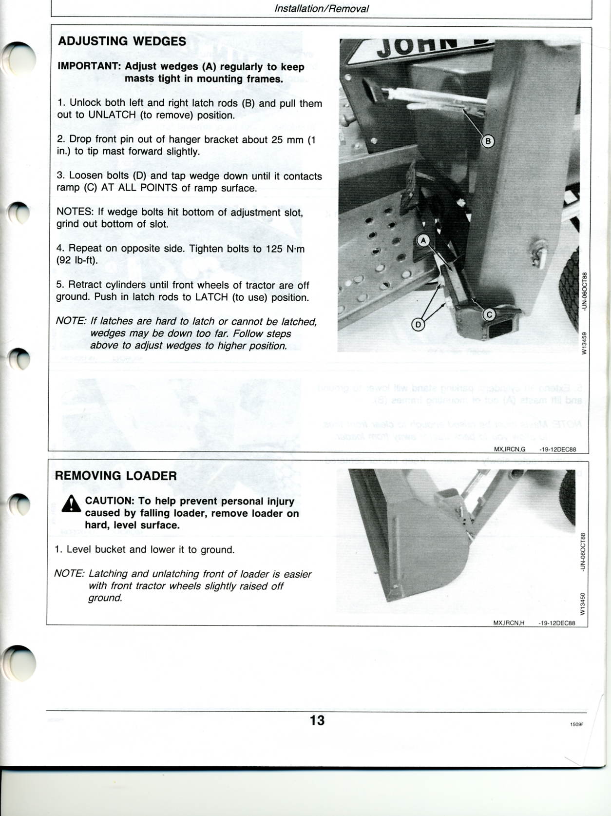

That would be correct and should be done every time the loader is installed on the tractor. The big thing here is the loader has to be supporting the tractor before the adjustments are made.
Wrong - After the loader is re-installed and the wedges correctly adjusted, do not tinker with it. Closely study the position of the wedges, and make a proper permanent note as to where the wedges are. Use a Sharpie magic marker, and put some thought into it.
Once the wedges are correctly positioned, let them alone. They are not meant to be adjusted each time the loader is installed.
Each time after mounting the loader, make a visual check to see that the wedges have not moved. If the wedges continue to shift, then that problem needs to be corrected.
I believe you are in error...IIRC, the operator's manual specifies the wedges to be checked (adjusted) each time the loader was installed. Not much to it...
I had the #60 loader which used those wedges...the thread the Gizmo2 linked to pretty much explains it.
Adjusting wedges isn't rocket science...very simple operation that takes two minutes if you're really slow.

I got it back together. I used a come-a-long to pull it back into place and after some wigglin' and adjustin' the wedges went in and I have them tightened down on the mast arms.
The hydraulics all seem to be OK. I can raise and lower the bucket and it rotates. I'm not going to put it under a load until I've had a chance to go over the entire tractor and do a long overdue PM. I'll need to get a torque wrench and take care of those wedge bolts too.

One more thing to check. Are you sure that the lock cams were fully engaged? I think I once did something similar when I didn't notice that the springs between the lock rods and cams had compressed without the cams rotating into the forward "locked" position. At all other times my loader simply goes into relief if I try to lift something that is too heavy.

I have used a 955 with a 70 loader on it quite a few times. I have removed and re-installed the loader about four times. Tomorrow I will visit the 955 and
check the wedge detail while I am there.
The wedges are a semi-permanent adjustment. Once they are correctly set
they should only need adjusted to compensate for wear. Fiddling with them repeatedly will lead to them not staying tight.
MarkV probably has the correct analysis. When the dealer mounted the sub-frame and the loader, they did not adjust the wedges correctly.
Everybody with a 60,70, 80 loader should check their wedge adjustment.
I disagree with you and adjusted everytime the loader was re-installed. This was done numerous times in the 2-3 years I owned the 670.
However, the manual just states the procedure and doesn't really specify how often....matter of how you interpret the manual, I suppose.
And, they never got loose (referencing your last statement).
(ADDED)The attached file is from the manual. It was an attachment on the thread the Gizmo2 linked to. Note the FIRST (bolded) instruction.
