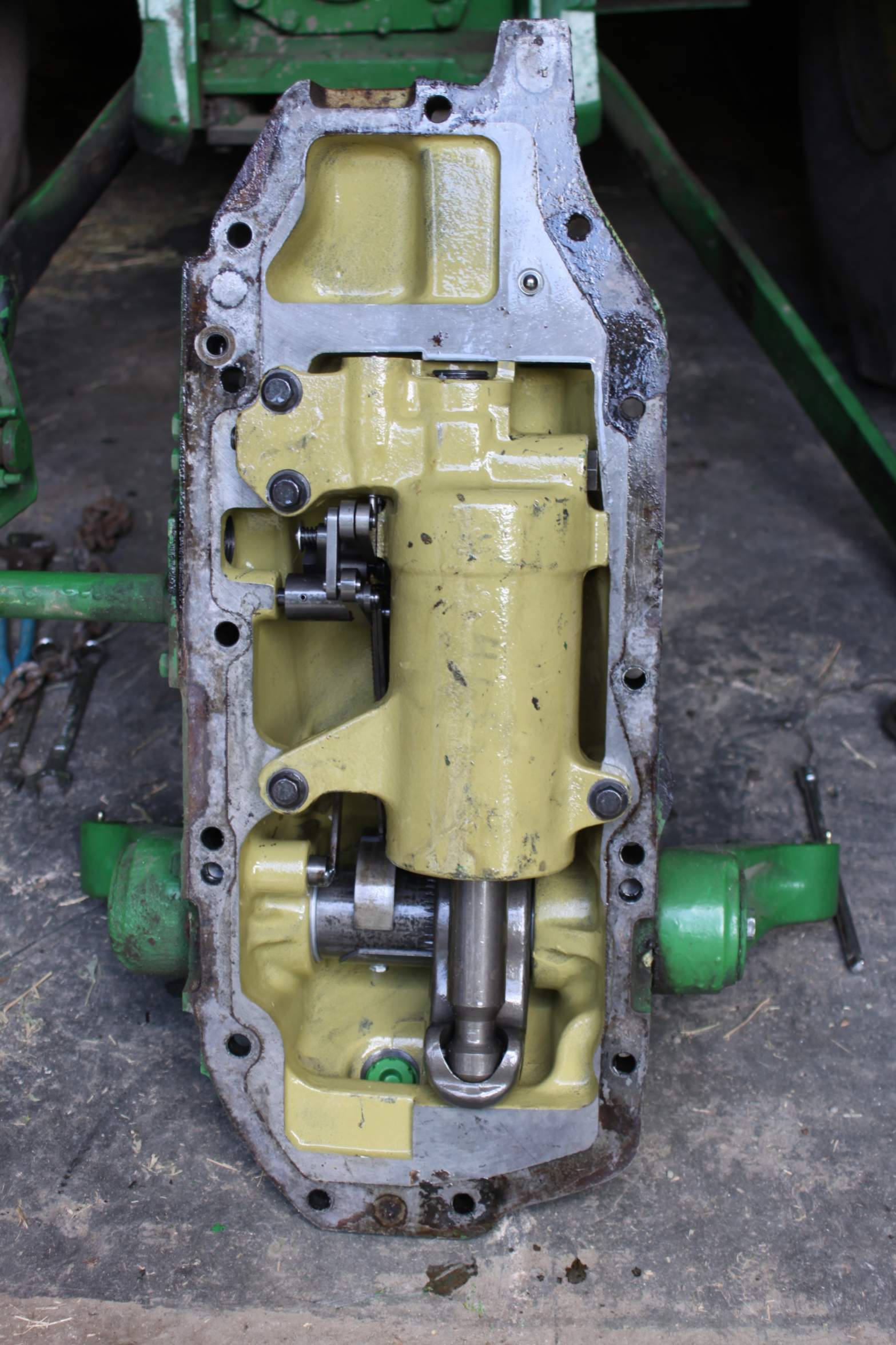

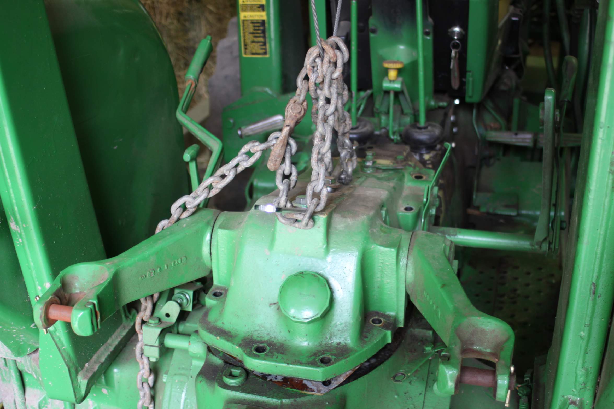

Thanks....sounds like time to buy a service manual.....no chance there is just a cover a person can take off for a look see?
   / Did I break my 3 pt hyd hitch...arms move up & down freely #9
That depends on your tractor and what you consider a cover.

On a lot of ford tractors (shibauras) including NH TC series the lift cover does not need to come off. You can remove the lift cylinder head easily and retrieve the piston and cylinder for rock shaft inspection and or seal replacement.

Thanks gentlemen. I'm probably handy enough to take it apart (not sure I'm handy enough to get it back together:)).

The factory service manual should cover everything. Aftermarket, not so sure, but I would think the 3PH would be there.

I had myself pretty leary before I did my 3PH, but after I got into it, it ended up actually being pretty simple.:thumbsup:
The hardest part with the deere manual was that the disassembly and rebuild were in different sections. Had to jump around a little as I did different things.
