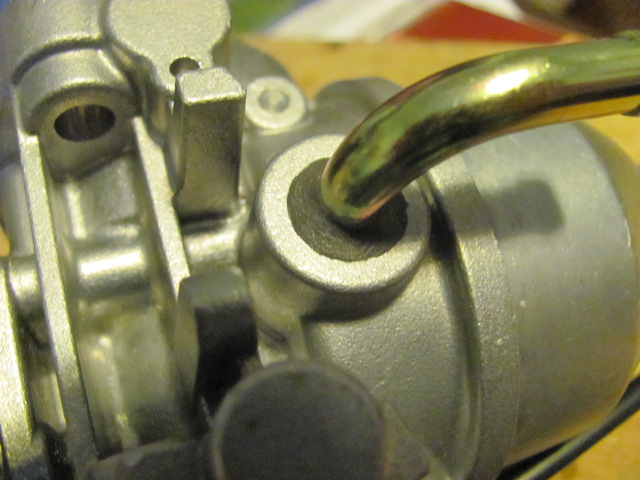

I agree, I have some JB Weld stick I'll put on it today so I can try it tomorrow. I think it will be easier to make a nice neat bead with a little roll of putty instead of slopping the goop around it.
   / Did I ruin my new carburetor for 18hp Kohler Command? #22
if it's not installed, either would work. I've even use dthe putty to make a bead, then top coated, after curing with the paste form, secured in a good position so it makes a clean surface.
remeber.. clean the area first..

Soundguy, ever try this?
After you put the bead down, use water (just dab your finger in it) and blend the bead into the adjacent surfaces. If you're careful, it'll look like a fillet radius.
Or:
Mask the surrounding area (use masking tape)...let it cure for a short time (5-10 minutes) then remove the masking tape. Leaves a nice bead.
I haven't used JB Weld in years, but used it frequently when I was in the Navy. Heck, I think we built an F-4 Phantom II out of JB Weld.

Roy, thanks for the tip with smoothing it out with water. I just want a nice neat finish that doesn't leak and looks good. I have a new tractor so these repairs will be for one that I will be selling so I want the new carb to still look as close to new as possible.

BTW, before you try the JB Weld on your carb, try that water blending trick(or the tape trick) on a couple pieces of scrap metal...it does take a bit of practice to make it look good. But once that JB Weld sets up, there's no going back...it's some tough epoxy!

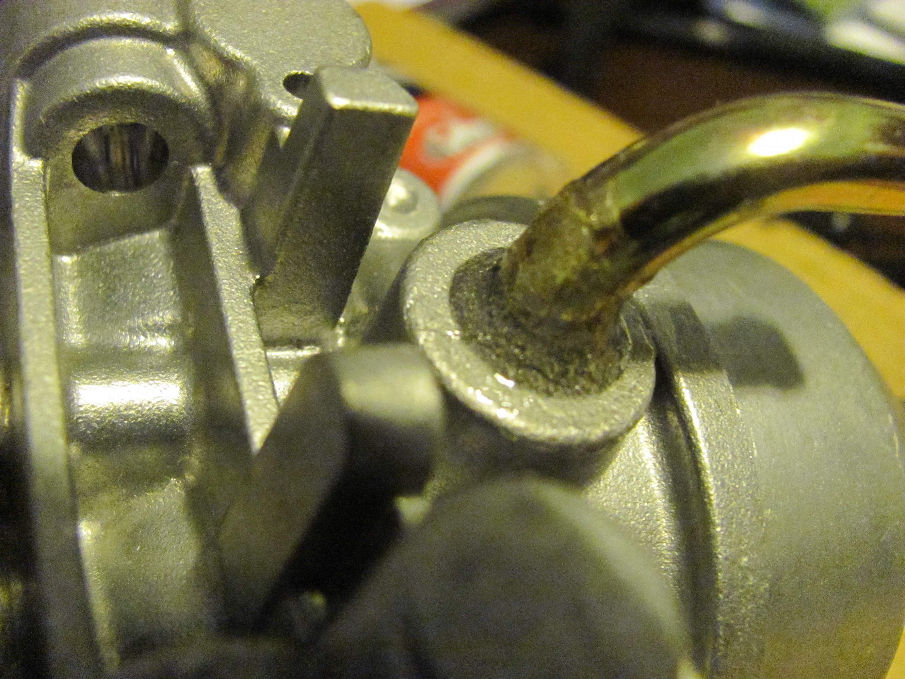

OK, the deed is done. I did the JB weld, let it harden then put two coats of the gas/oil resistant Seal-All over it. I'm not sure if it would have leaked or not before but I sure can't see how this could ever leak now. It looks good, not a hack job IMO. It looked better with just the JB Weld but I figured I might as well put the Seal-All on it too while it's here and clean. I hope nobody ever tries to move this inlet again cause it ain't goin nowhere now.

   / Did I ruin my new carburetor for 18hp Kohler Command? #28
looks great.
NOW you don't have to loose any sleep worrying about it either way.

For what I've been told the selenoid is there to shut the engine off in case you roll over. If the wire was bad then it would have been shutting off fuel to the engine. So it sounds like your original carb is a good back up or parts donor if the fix to your new carb fails. I doubt you'll have a problem though. I think those pipes are just pressed into place and with little pressure on them it doesn't take much to turn them (it could have some sort of barb to prevent it from coming out). I would keep an eye on it though for the first few times you mow, just in case the vibrations cause it to leak.

I'm pretty happy with how it came out and I'm fairly confident it will work well but I'll keep my eye on it. A new $270 carb for $45 and some JB Weld and Seal-All makes me very happy!
