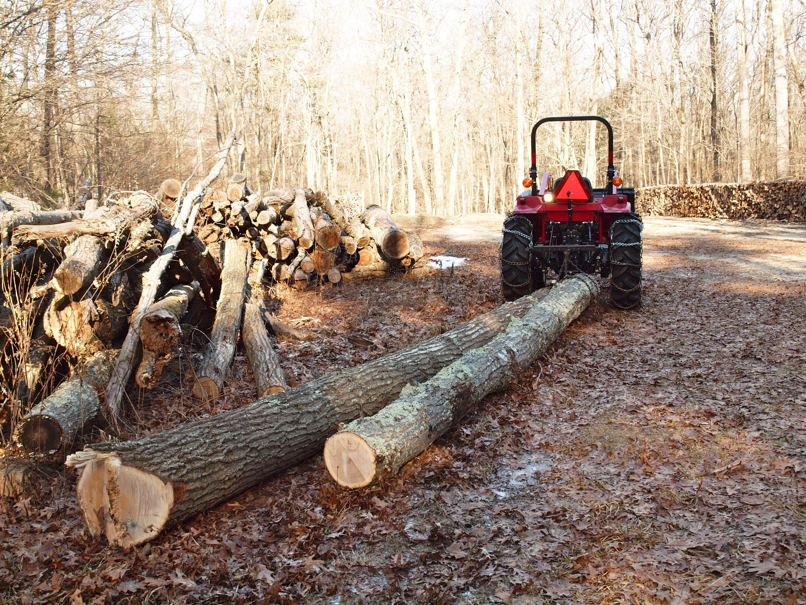

What kind of serious failure? I can show you just how the loader is mounted to this tractor and you won't believe me when I show it to you.....1" thick steel plate for a material source before they start bending, cutting, welding and drilling (holes for mounting to the tractor frame). Pin holding the loader frame to the tractor mounted receiver is Cat III (removable loader). Loader is rated at 2000# at pin fully raised. Accessory to loader attachment is standard skid steer quick change and the chain was wrapped around the rear of the attachment meaning that 4 Cat II bolts were holding the frame to the loader arms. I can double stack heavy, 5x6 rolls of hay on a semi trailer without grunting.....the loader and mounting design was another reason for buying Branson. I doubt that I was exerting 2000# of force......the chain was 3/8 and didn't break, or even stretch the links.
When it happens you will know. Too late. But you'll know.
As to the strength of your tractor and FEL. Everything you stated is intended to push and lift rather than pull and pry.
As to the load you were pulling, no way to know. But since you were able to pull it out without lifting the rear tires and/or spinning indicates it was a very light load. Tends to give a fella an abundance of confidence. Which can be dangerous. :)
Without yanking, your tractor doesn't have the traction weight to break a 3/8 grade 70 chain. Probably can't break a 5/16".

I attempted to lift the end of the log so that it wouldn't dig into the ground as it came up the embankment before the ground leveled off where I was but the only thing that happened was that the front end of the tractor started squatting and with all going on, didn't want to break something in the front axle.
I don't know the grade of the chain. My 2400 elongated the links and broke ⅛ or 3/16" chain didn't measure had just bought it from the hardware store, pulling logs out of the water.
Pull was straight line and the tractor was on level ground....just before it broke to the slope of the pond bank where dug. The rears were full of ballast and the tractor weighs about 6k#.

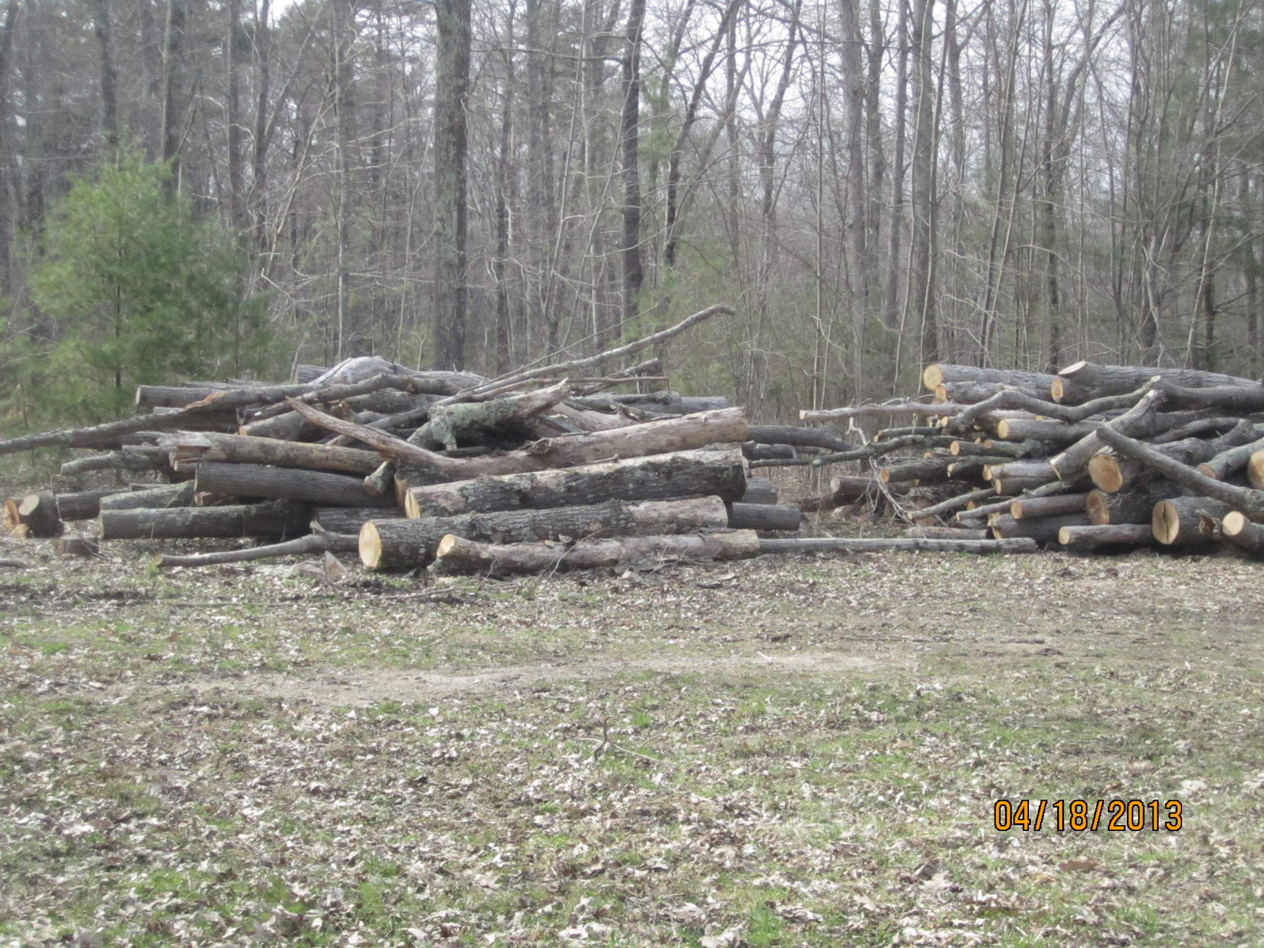

I've logged for 40 years with a 1/4" chain.
