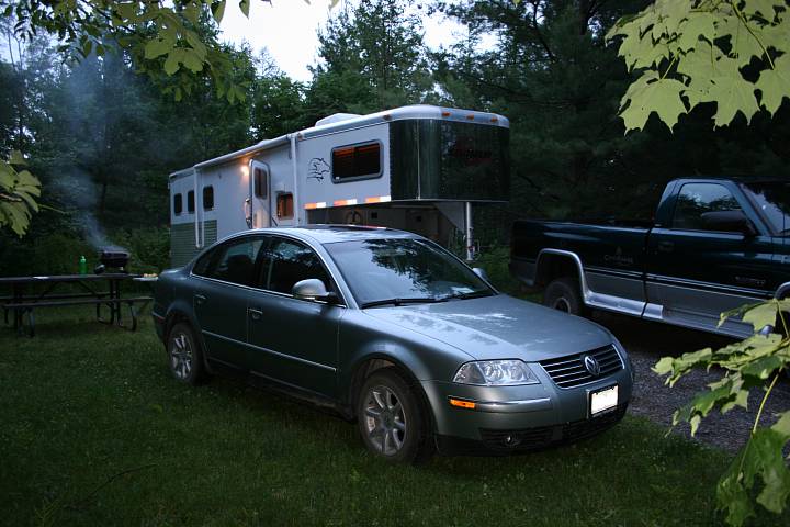

I currently drive a 2004 VW Passat TDI with the 134 hp/247 lb/ft BHW 2.0 DOHC 16 valve pumpe duse engine. The car is a true autobahn cruiser that gets an honest 5.6 L/100 km combined driving.
The car is built like a tank (this version of Passat known as B5.5 body style shares platform with Audi A4. So this car is like driving a diesel A4.
Driveability is excellent and apart from some initial turbo lag at launch, it is a seriously gutsy performer especially mid-range torque for passing and merging on highways.
The car has not been entirely problem-free. The sunroof drain plugged which flooded the floor under the driver's seat, coincidently, that is where the BCM is located. I was driving to work and the car went haywire! All the lights started flashing and the alarm horn in the trunk started blaring!
Had to replace the trunk motor - yes there is such a thing on these cars.
Diesel engine related problems - none experienced, however that said, this BHW engine has an Achille's Heel, sort of like the Killer Dowel Pin on 5.9 cummins.
The balance shaft module is chain driven and the oil pump is driven by a short hex drive shaft from one of the balance shafts.
This whole deal is a sorry piece of engineering in that the BS chains are prone to breakage. A serious weakness in what otherwise is a rock solid engine. VW TDI specialists recommend swapping out this BSM with a gear driven unit at first timing belt change, which I did.
Engine should be good for a long life now, fingers crossed.
A bit of a tough pill to swallow - drop about 4 grand to upgrade and "fix" an inherent design flaw in an otherwise perfectly running engine.
Would I buy another diesel car? Yes, definitely. Even if only for the superior engine dynamics and enhanced driving pleasure that comes with it.
