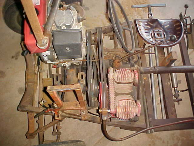

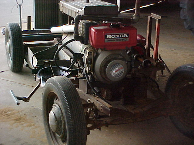

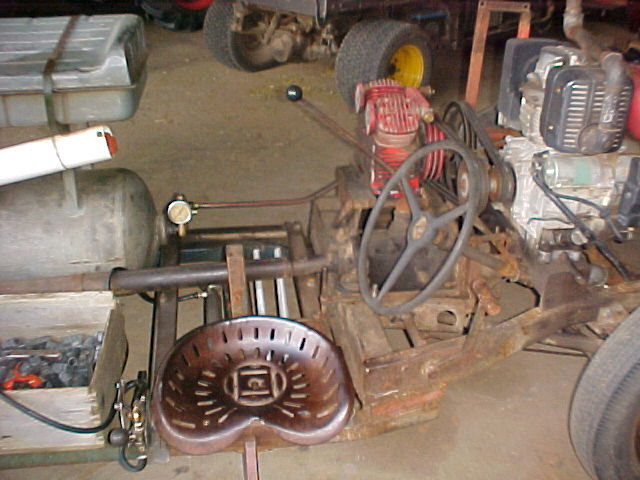

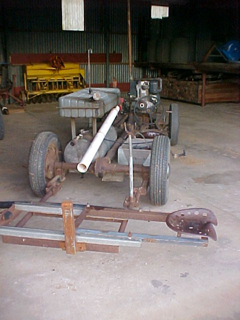

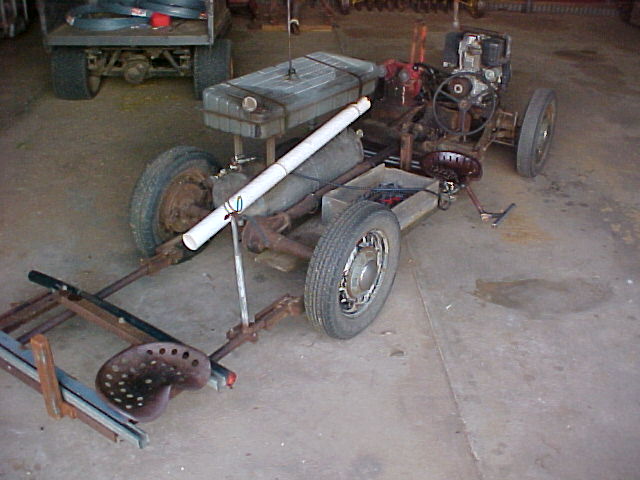

Jake98 and Blagadan, as promised some pics of the buggy.
The seats are spaced 8' apart as that is the spacing I always plant vines and tie up drip hose.
In one photo you'll see two return springs for the front seat and the air cylinder - none for the rear as yet.
Hard to see in the photos but there's a belt running from the idler shaft (for gearing down) down to the front of the gearbox. When the front seat slides in there is a linkage that automatically tightens the jockey pulley of that belt, to move the buggy along until the seat is slid out at the next or second next vine.
Behind each seat you'll see a 3 x 2" RHS about 1' high, these are fixed - not sliding. They have two right angle frames of about 5' high and wide dropped onto them in summer, these then have 4 30"x 20' sheets of corrugated iron (2 at the back and 2 on top) attached to provide shade.
Have considered mounting all of this to one of my little Kubotas, to avoid all the belts and pulleys and rust. Figured out in my mind how to do most of it but gave up when I thought of the roof which could cause a Kub to tip over or in a gust of wind, blow away.
The gearbox is original Ford Prefect 3 speed, but it jumps out of second, have had a couple attemrts to fix this but have failed.
For the most part 1st is good for down the rows (slow walk) and third for running to and from the blocks (jogging speed or revved up, running) .

Now that is a thing of great beauty. You gotta love it. Jake
   / Diesel exhaust as compressed air? #17
Most ingenious! Good on you, mate! I really like to see examples of putting stuff together in ways never originally intended in order to nicely fill a need.
Oh, and my guess is worn synchronizers in the tranny are the root cause of not staying in 2nd gear.
Pat
