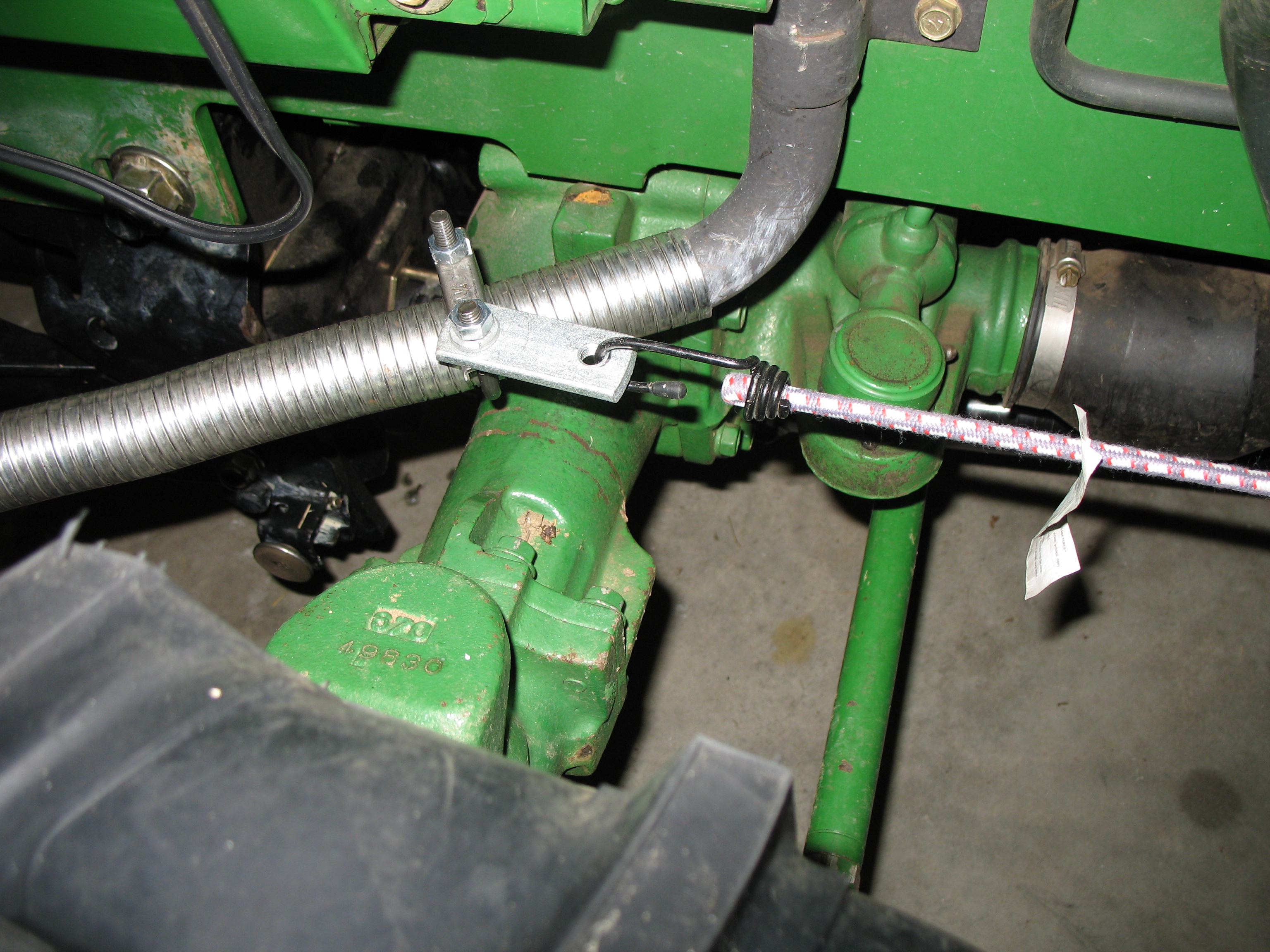

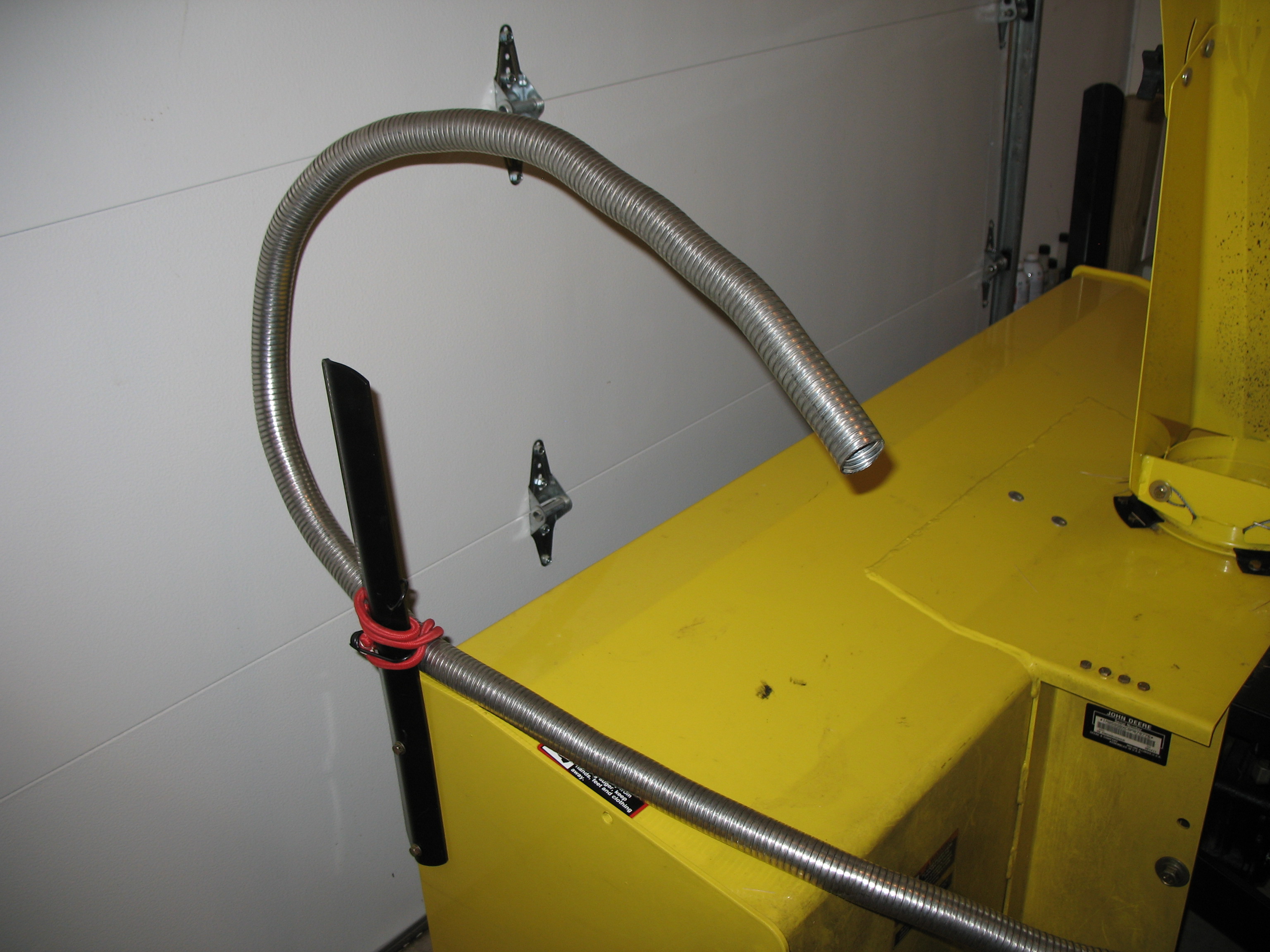

Per my previous post ended up getting the 1-1/4" ID Walker Galvanized Flex Hose (more like 1-3/8" ID) and took the approach last described. We're getting 8-10" snow today and another 6-8" tomorrow so can't wait to try'er out. As you can see in the Pics, I attached the Exhaust U-Clamp to Flex and added a two-hole tab, one side attached to clamp bolt and the other used as an anchor for the Budgie, the 2nd PIC shows the Flex Bungie'd to the Drift Blade and At-The-Ready, once that garage door goes up I'll flip out the 3' length. I suspect I'll take it off once I get outside because the 3' it isn't rigid enough to stay horizontal but thinking about next Mod, devising a brace to slide over the Drift Blade, perhaps a PVC Pipe with a tee fitting and a 2' extension

Don't see that you will get much relief unless you are going to be letting it sit inside and warm up (in which case your bungie cord on the blower will melt from the heat.

beenthere, The lower exhaust angled stub on the 790 is dead center to the back of the Front Mount JD59 Blower and despite the garage door being fully opened the initial start-up smoky blast comes right back into the garage. As explained in a previous post, the garage is attached to the house and that smoke/smell is not welcome inside the house.......... By coming-up with this easy-to-remove Exhaust Diversion after being safely away from the garage and doors closed should eliminate that lingering Diesel............I agree, we'll see how it works............

So if I understand correctly, this is only in use for the first few minutes, until your tractor is running and outside, at which point the bungie cord is released and flex pipe removed? Sounds like it should work just fine. The pipe will likely not get hot enough to damage the bungie on the blower... I think you have found a workable solution to your problem.

dieselcrawler, Pulled the tractor out this morning to address the half frozen snowplow mound at the end of the driveway. Opened the garage door, started'er up and was delighted to see that initial Black Smoke Puff go shooting outside and away from the opening. Got the tractor a good 30 feet from the door, quickly disconnected the flex (sliding off the exhaust stub) then took the piece back into the garage and shut the door. Before returning to the garage I shut the tractor down, did my tuypical broom the snow off and out of the blower, then reconnected the flex and rolled it back in the garage and staged for next snow event. Just to be sure no melting, etc., disconnected the flex in the garage. No smoke what-so-ever in/out of the garage, mission accomplished. PS...Wife is a Happy Camper, the important thing.....
