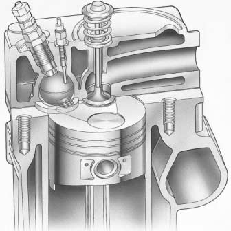

<font color="blue"> Skypup, I'm having a hard time visualizing the pre-combustion chamber. Where is it in relation to the valves and combustion chamber? Is it just a scalloped out area within the cylinder head? </font>
Attached is a diagram of Kubota's IDI precombustion chamber. It is Kubota's Successful Triple Swirl Combustion chamber design to reduce carbon monoxide, hydrocarbons, and nitogen oxide emissions to meet current Tier II emission regulations

This attached diagram depicts Kubota's current entire IDI combustion chamber design.

Excellent. Where'd you get that. I'd love to have drawings and schematics of my tractor's engine.
   / Diesel for Dummies #25
Kubota routinely publishes their engineering developments in peer reviewed journals, this was from a CD-ROM from the Society of Automotive Engineers Off Road Engineering section:
Development of the Small-Sized IDI Diesel Engine Kubota 73.6mm/78.4mm Stroke Series
