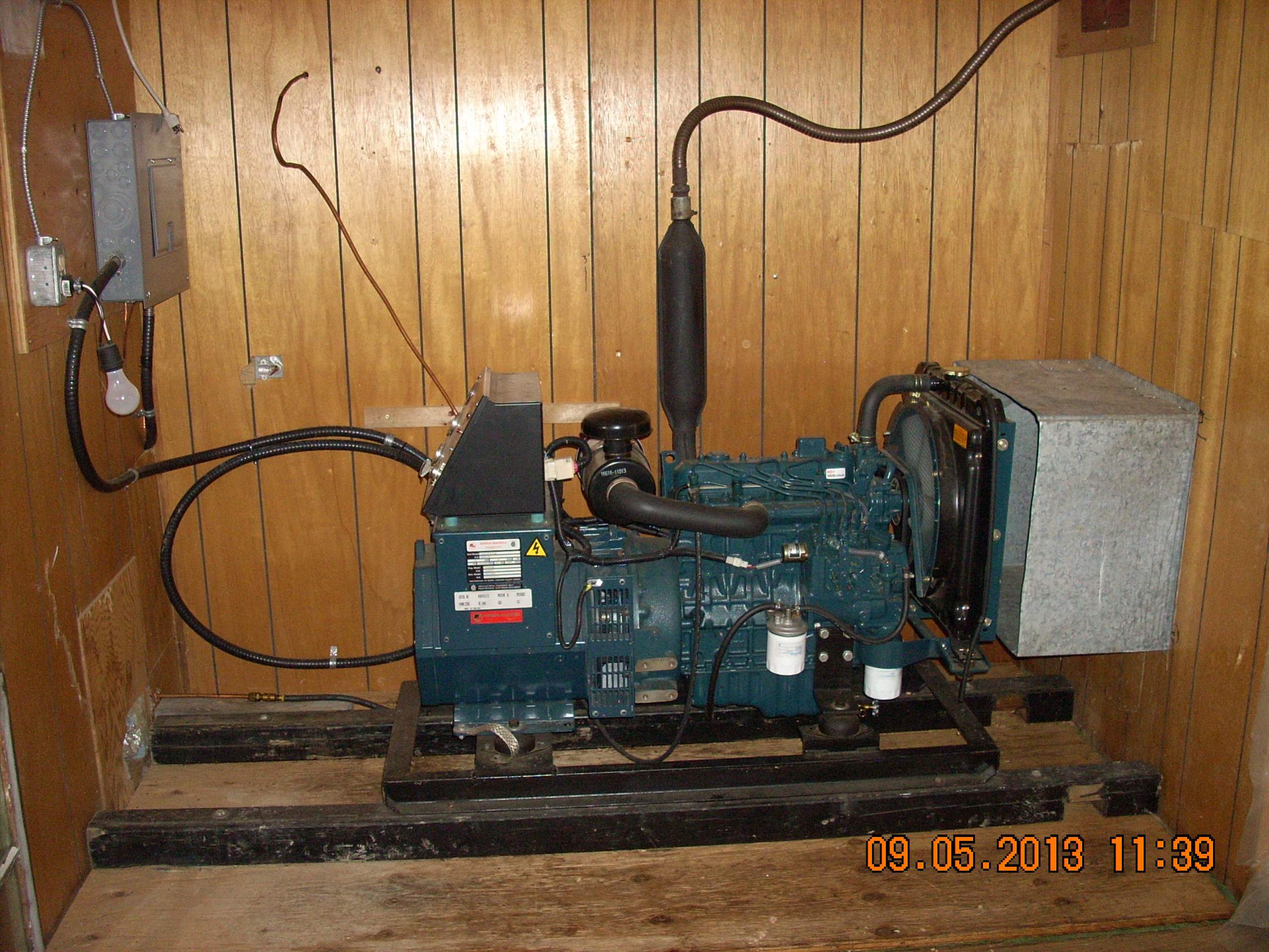

I have a 12kW Kubota system installed at my house. It sits in a shed and has a mechanical change over switch - all installed by an electrical company.
This was installed by the previous owners.
In the time the previous owners had it, it was never run on load or serviced. When I bought the place I replumbed the fuel system from the 250gall. storage tank and got the machine running properly. Changed out the oil at 4 hours due to it's age and replaced with new oil. The generator now has around 140 run hours and another oil and filter change etc. at 100 hours.
This machine has run without any problems and supplies all the power the house needs during a blackout. The 12kW is enough to run heat pump, electric stove etc and based on my calculations, uses about 1/2 gallon of fuel an hour at around 60% load.
I don't know what the previous owner paid for the setup - I am sure it wasn't cheap. However, I am more than happy with how it works.
Sorry I can't answer some of your questions but thought you might be interested in my setup.
   / Diesel generator for home back up use #77
Nice setup Jim! What is that used for the exhaust piping -- a flex tube and through-wall thimble? Does it just poke out the other side?
   / Diesel generator for home back up use #78
Definitely not cheap...nice setup!
