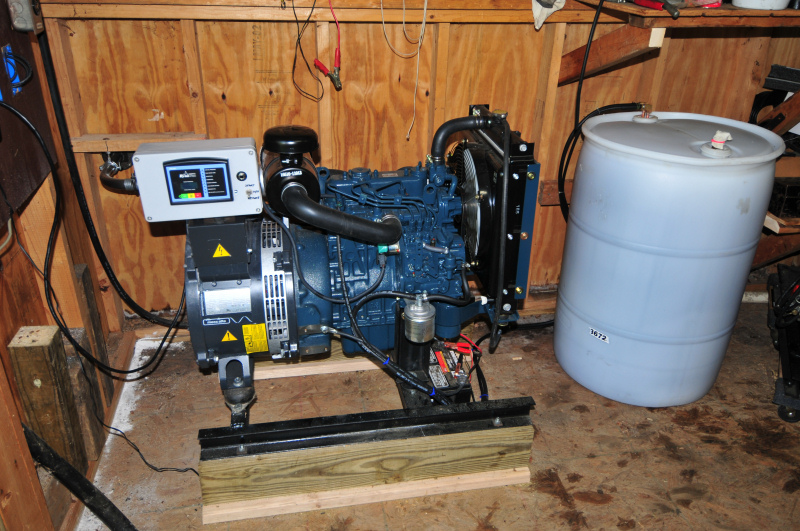

You are correct, a good diesel unit will last a long time. Another advantage is that diesel can be stored for years, and if you have oil heat you have a built-in supply of fuel. I have a 10 KW diesel that powered my whole house (2 fridges, 3 heat pumps, freezer, well, etc) and I burned an average of 1/3 gallon/hr over 4 days. Compared to propane you would be using 1.5 gal/hr.
To truly benefit from a diesel, you should look for an 1800 RPM water cooled unit with a name brand engine: Kubota, Isuzu, Lombardini, etc. I would not go with an unknown name, imported diesel if you want life and reliability.
Check out: Diesel Generators for Home Power or Off-Grid Electricity
They have a nice selection at reasonable prices. Remember these features will cost you more than the "traditional" big box store generator.
paul
