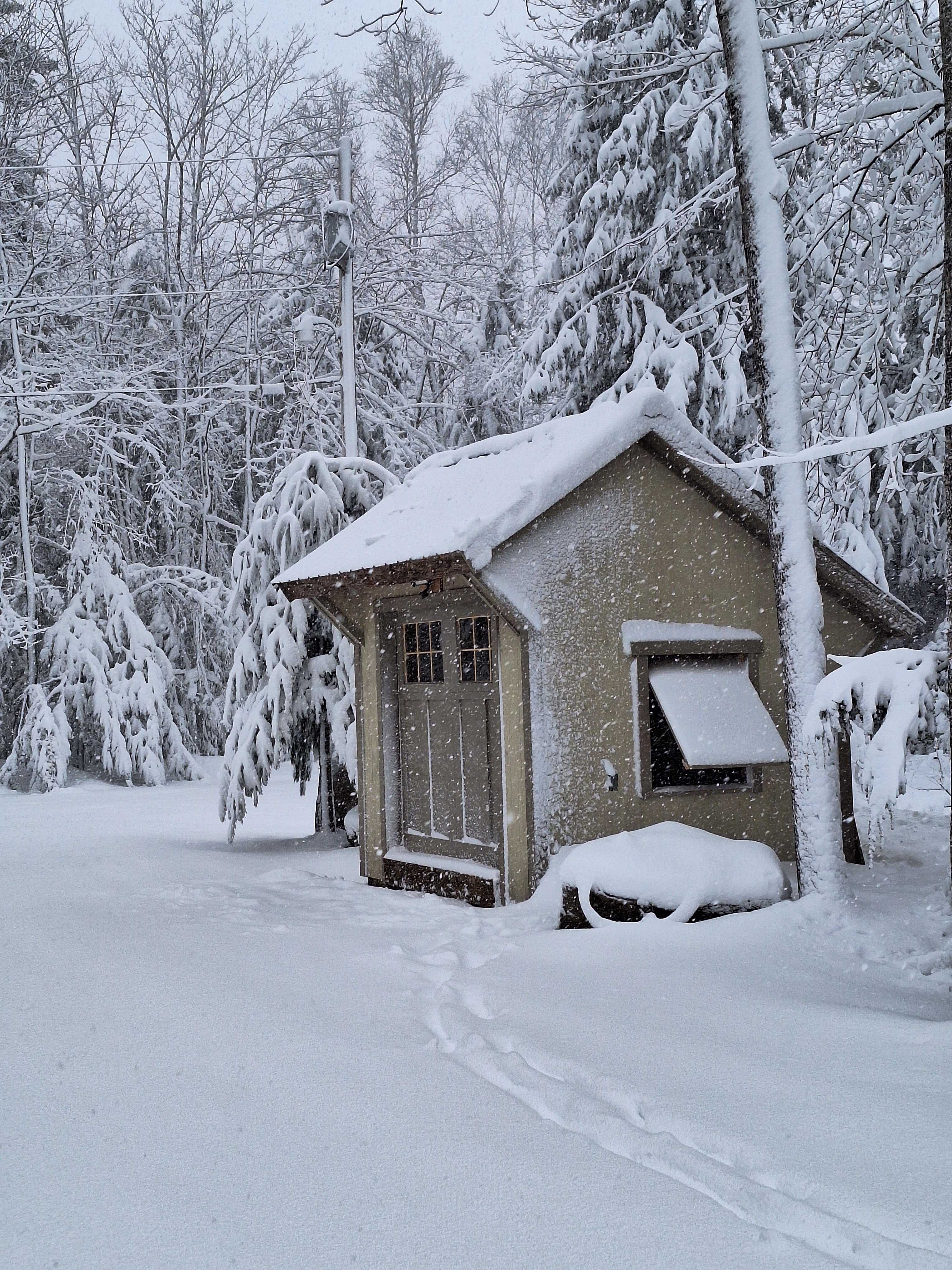

I installed it in the back of my barn and control it from the house. I elected to use manual start over an automatic transfer switch. My wife is definitely not mechanically inclined but I had little trouble teaching her how to use it. We test run it once a month and she starts it with my supervision.
Here is a link to a post I made on the project:
See post #7099
Since I presently fuel my tractors from a pump at the house, I'm currently working on a project to transport fuel to the generator in the barn.
