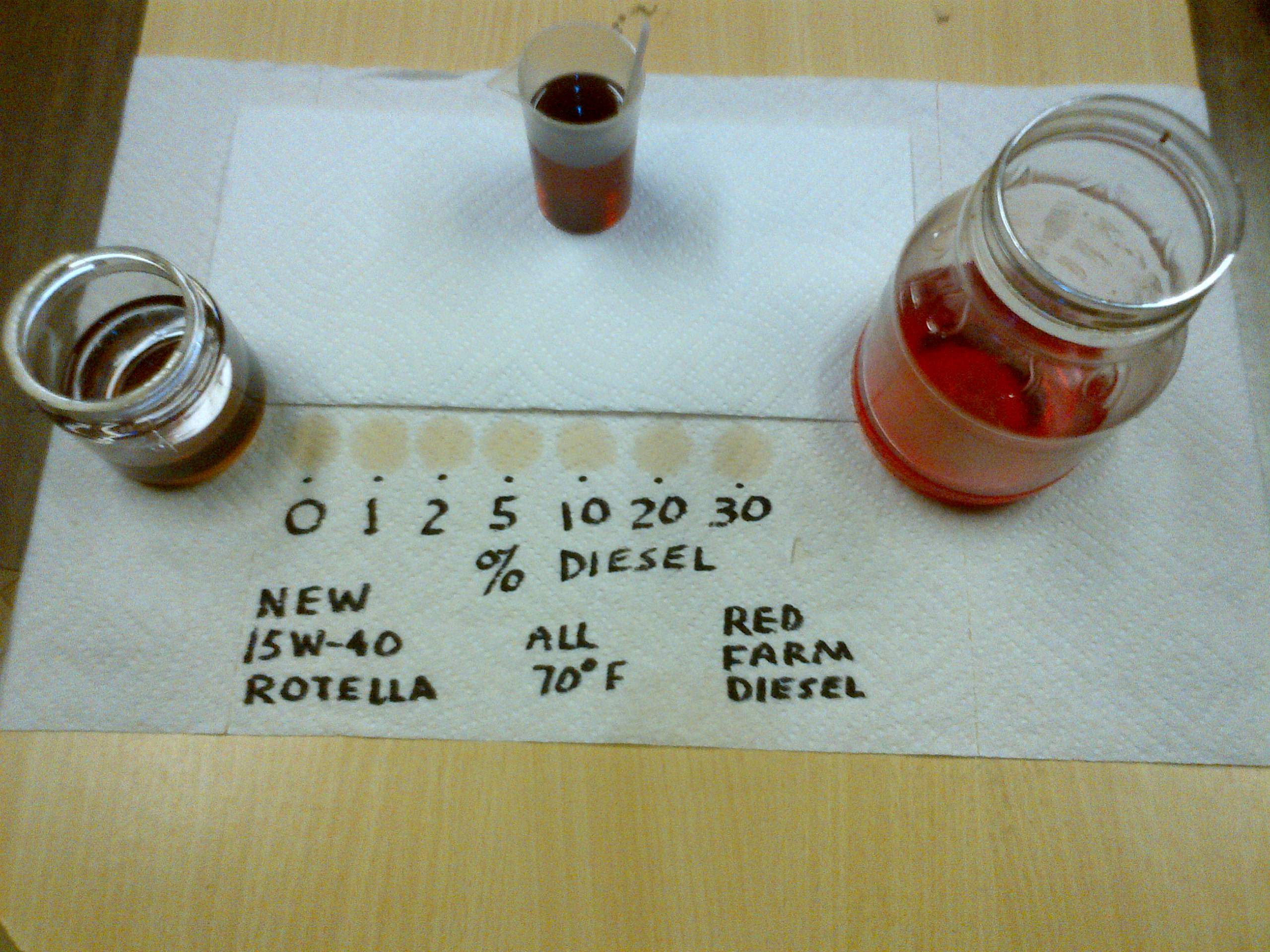

I wanted to believe that the paper towel test for the presence of diesel fuel in engine oil was a quick and easy way to detect a serious problem. The presence of diesel was supposed to be detected by an expanding ring from a drop of the mix on a paper towel due to a reduction in viscosity of the oil. It continues to be touted in several forums, but this test shows the technique is without merit - it fails. The picture shows it all. There is no detectable difference in the drop samples of mix from 0% to 30% diesel in oil. IMG-20131012-00006[1]DieselinOil.jpg::(:(

I hadn't heard of that test, but it sounds bogus to me anyway. Two similar petrochemicals aren't going to separate that quickly or easily..........

The "Bounty" test is a new one on me, too.
The "sniff" test has worked for me for gas in the oil.
Haven't had a situation (yet) where it was needed for diesel.
Keeping my finger crossed on that last one.

I've seen the paper towel test touted also. I never knew if it worked or not but it never sounded all the great to me. I know on common rail diesel injectors can fail and get quite a bit of diesel in the oil. Also vehicles with DPF can get quite a bit of fuel in the oil from the regen process.

I am not saying the tissue test works, but one poster said paper towels doesn't work. That you need tissue paper or toilet paper - thinner and more 2 dimensional. I think a used oil might show more as well.

The only way to really know for certain is to send a sample to a lab. As little as 2% fuel dilution, and many oils will shear out of grade. At that level of dilution, the lab is the only sure way to know what is going on.

I have used the blotter test with white 3x5 index cards to check for excessive soot content in our test cell diesels and my own vehicles. Paper towels are too porous to illustrate any differences in viscosity.
Placing several drops of oil in the middle of the card and setting it aside for a couple hours or days in a warm environment will allow the oil to slowly be absorbed leaving the insoluble’s behind. Excessive soot will show up as a shiny spot in the middle of the test area.
Fuel dilution may work with 3x5’s because they are thicker and more dense thus slowing the absorption rate. I would think testing for fuel dilution would be a timed event.
As with any method you need to have multiple samples & data to determine what is excessive.

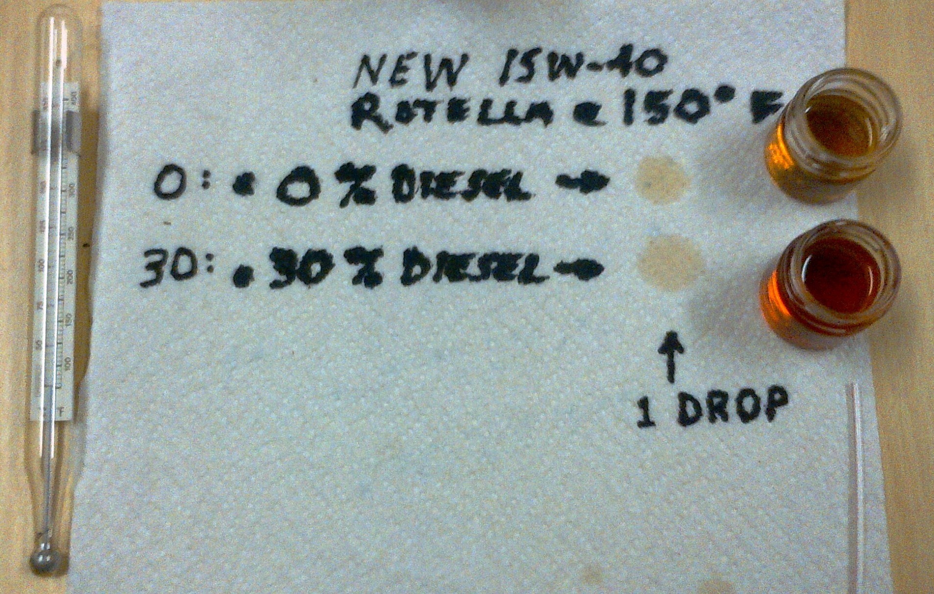

OK, thanks for the comments. To address concerns about temperature, I repeated the 0 and 30% diesel tests at 150 Deg F (attached). Again no difference in the samples with and without diesel. Others may have a point about used oil, "soot loaded" - perhaps there is a chemical presence in well-used motor oil that will produce a real difference with diesel. Another test?

How about on some tissue paper?
