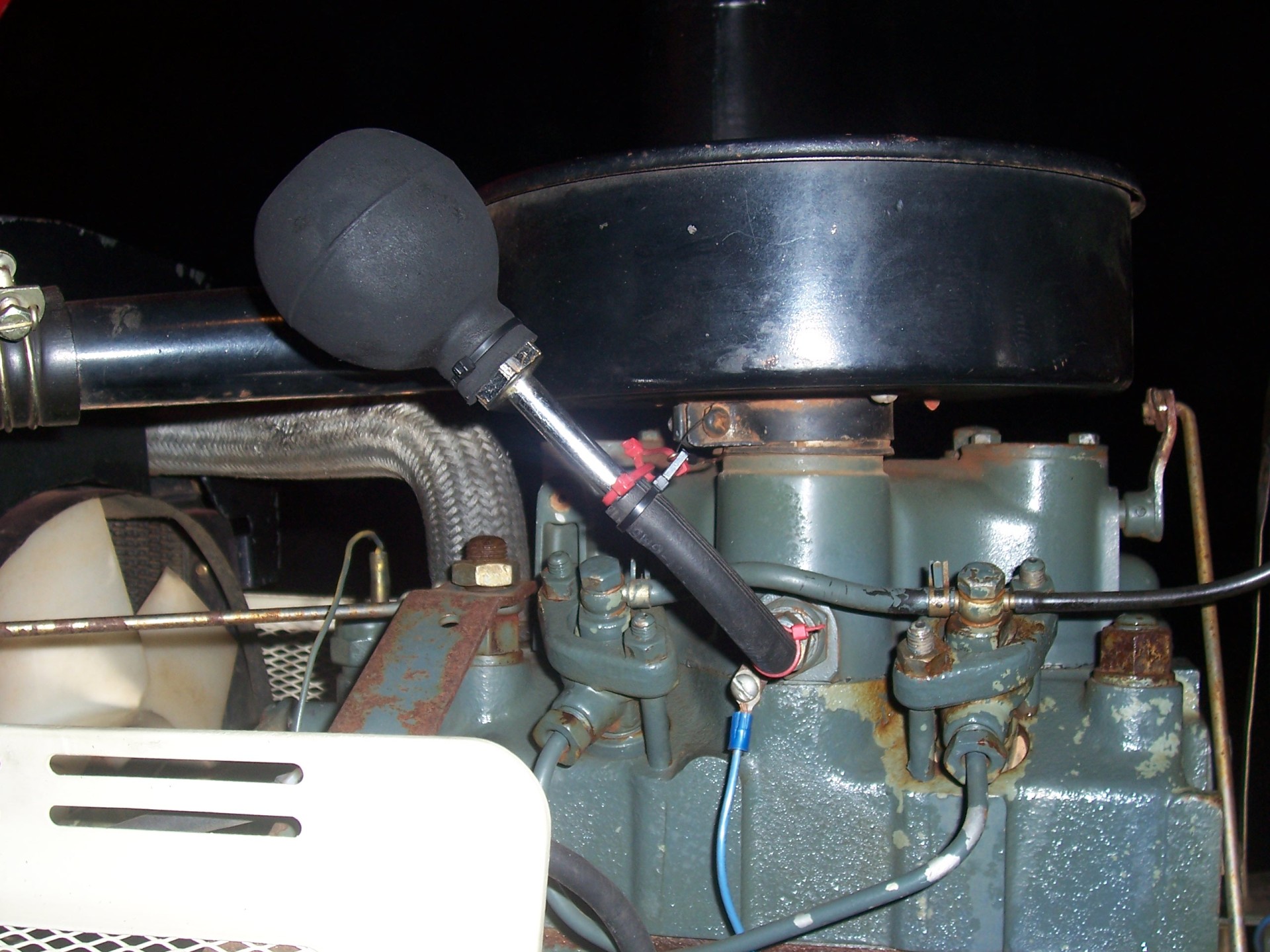

Along with Barry, my bet would be on the Thermostart module leaking. It's simple to replace.
Sounds good, I've got a thermostart and filter on the way along with manuals. We'll see how that works.
   / diesel in the air filter housing #12
Along with Barry, my bet would be on the Thermostart module leaking. It's simple to replace.[/QUOTE
And most likely If the Thermostart is leaking Diesel it would be sucked into the motor not blown out of the intake into the Air Filter. No way that much Diesel from the Thermo will end up in the Air Filter. It prob. wouldn't even run if that was the case and the first time he used the TS would most likely be the last if it worked. I mean "Catch on fire to say the least". LM?O :heart::heart::heart::cloud9:
#13
And most likely If the Thermostart is leaking Diesel it would be sucked into the motor not blown out of the intake into the Air Filter. No way that much Diesel from the Thermo will end up in the Air Filter. It prob. wouldn't even run if that was the case and the first time he used the TS would most likely be the last if it worked. I mean" Catch on fire to say the least". LM?O :heart::heart::heart::cloud9:
When I fill up the thermostart tank, the tractor smokes until it's uses the whole tank. Hoye says that means the thermostart is leaking. I guess I'll start there then on to setting valves and compression test. There were a couple gaskets in the AF housing, that made the air filter fit, so maybe the previous owner wasn't using the correct air filter and used some gasket to make it work.
   / diesel in the air filter housing #14
Remove your Cup and line to the Thermostart. I Don't have one on mine. And you just fixed all your problems then. Yeah! My TS works just no cup. This is my Rig. Made it when I checked to see if it did. Still have the one I ingenuitised. I just never Use it in Ga.. Rarely now and then.
#16
I put in a new thermostart and now no diesel is getting into the AF. Thanks for the help!!
