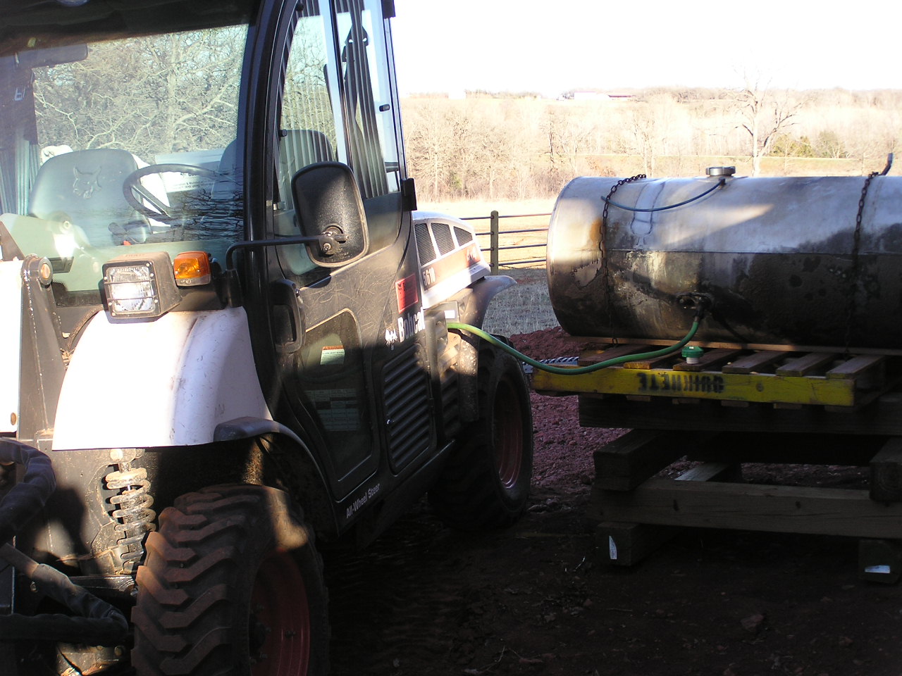

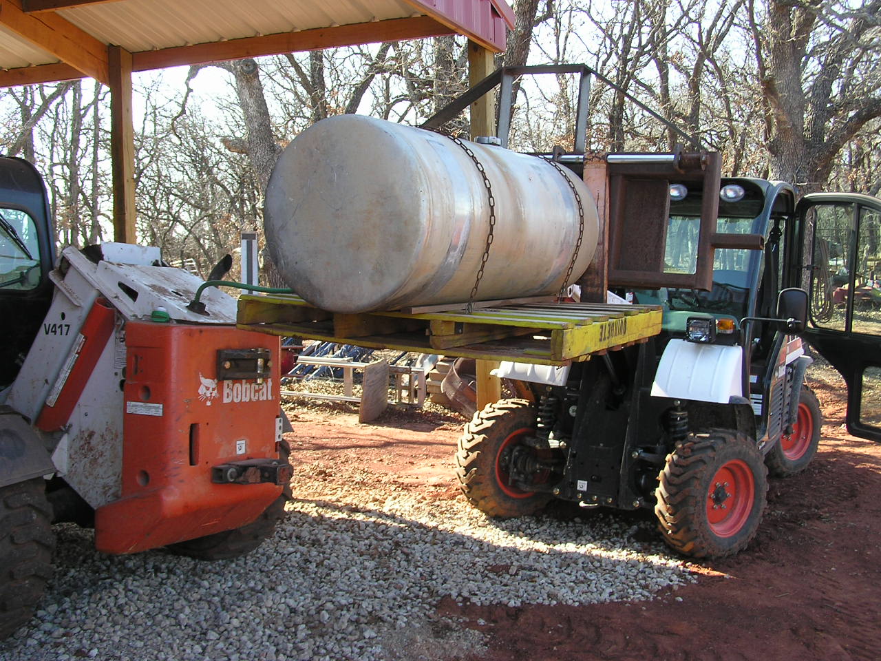

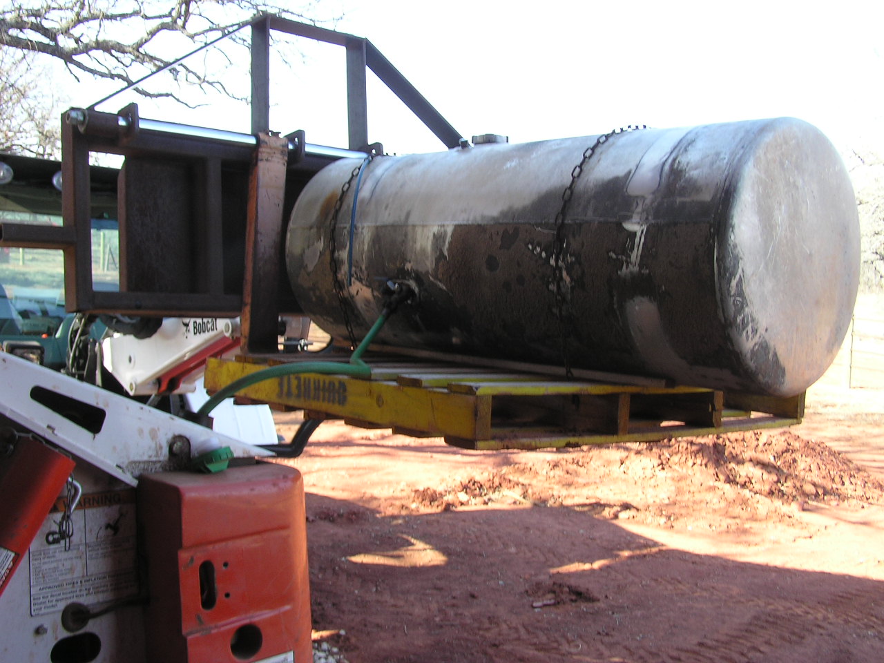

I found this 100 gallon saddle tank on craigslist, for $100.
When it gets low, I put it in the truck and go drain my wallet! :D.
But I did save $30 compared to on road diesel. Over twenty years that is a lot of $. :thumbsup:
