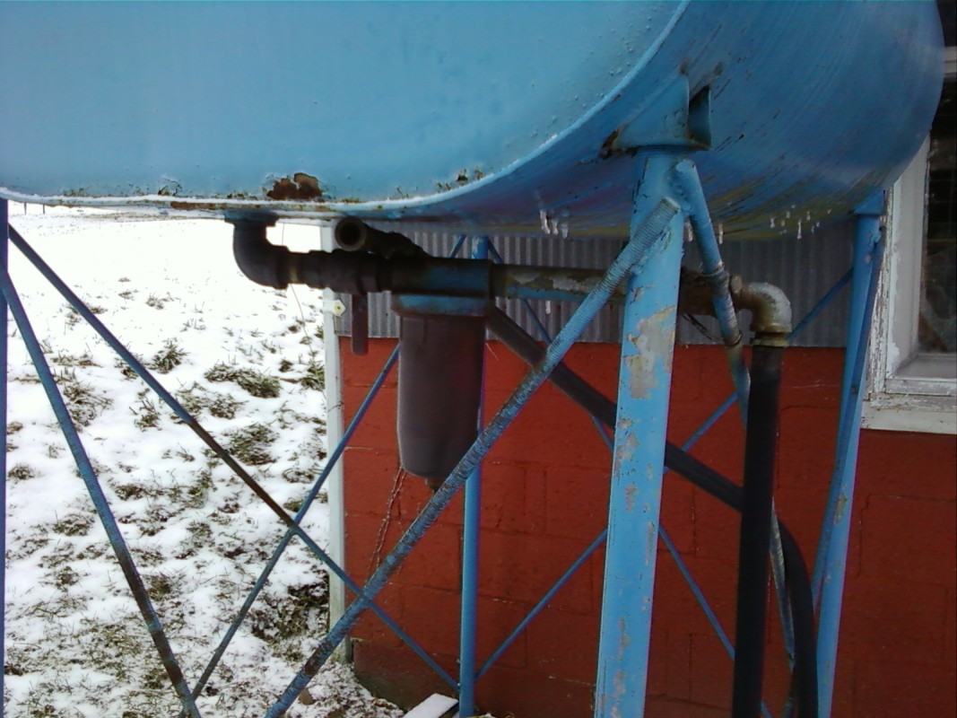

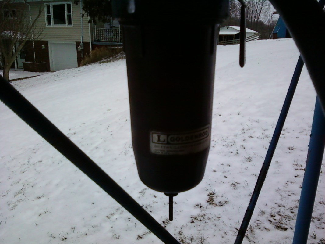

I had one last question to go along with this....what is this filter? Do I need to change it, drain it and clean it, or leave it alone? If I need a new element where is a good place? Thanks!

Fiuel filter with water trap. I would clean up the filter bowl so you can see any trapped water in it. TSC has several filter elements that may fit your filter housing. I would opt for a water absorbing filter element when replacing the filter element in this one. It looks like it hasnt been changed or cleaned in a good while.
   / Diesel Tank Inside #18
The photo is not real clear but is the filter hooked in-line with the pump hose so the fuel runs through the filter on the way out? I would presume it does but the picture is difficult to see.

Yes 6dogs, it goes from tank to turn on value, to the filter, then into the hose.
I have never cleaned it...I will do so and pull the filter element. It took me 3 years to use all the diesel and now I am going to sand and paint the rust spots on the exterior and move it inside the blue barn before having it filled.
Any conditioning I should do for the interior of the tank? I read on here that they most often corrode from the inside out. Thanks much.

Here is what I did.
I turned the tank upside down with my loader and emptied it out.Then I put the wand on the end of my shop vac --might have made an PCV extension--and vacumned the inside out. Blew compressed air in with a wand too. I painted the outside with Rustoleum aluminum paint. Don't bother sanding if you use that paint--it's like water.
For the pump setup, I used two filters in series --one is a waterblock and the other a regular filter. It MIGHT be overkill but I have seen what one grain of crap can do. I run a vented cap, have a fuel meter and call it good. My 150 tank in the barn is on rollers and I have a static wire hose.
