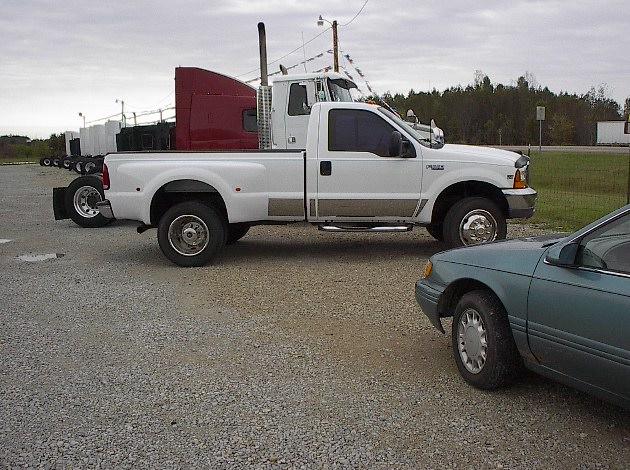

It's a '99 F550 PSD 6spd. XL trim level. At some point, someone shortened the frame and put a dually pickup bed on it. Asking $15,900. I think he'd go to $15,000. Odometer says 46,000. Could be 146,000 but it seems very clean for that underneath.
Still considering it, but I'm not sure it's what I need at this point.
I have no doubts I could get a CDL, finding the time to go take the course and so on is my problem.

Is it a regular cab Scott?

I have the GM equal to the F550, it's the C5500. We just took it on three thousand mile vacation and it was comfortable. My wife says it rides better than son in law's 2001 2500HD.
If that truck has it's original springs it has to to ride like a rock. Think about it. Truck probably weighs about eight to nine thousand pounds but has the springs to carry nineteen thousand pounds.

Seems all I can tow is a 7,000 pound trailer. So, the hunt continues for a 250/350. Neat truck, but a little more than I really need with some niggling problems.
looks neat though... /forums/images/graemlins/cool.gif
