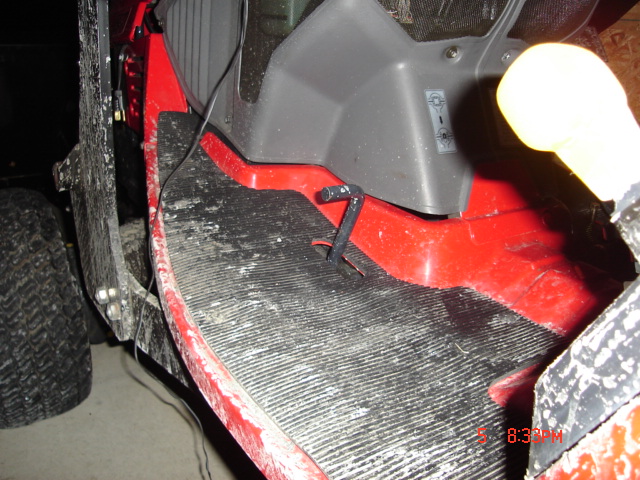

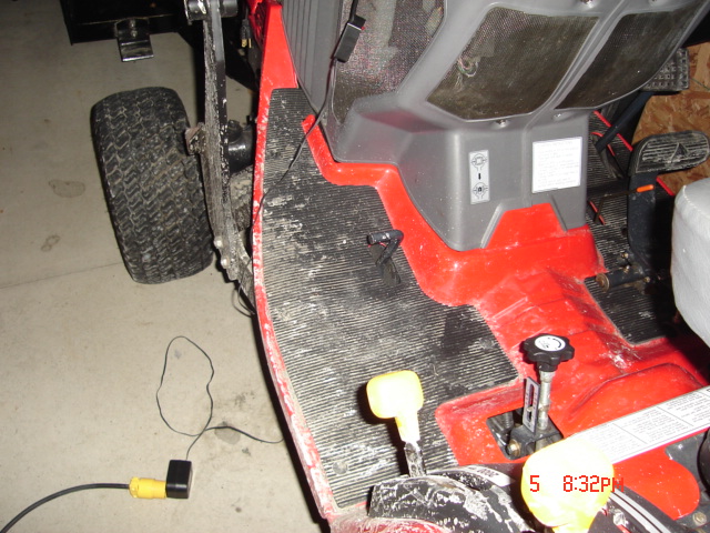

My Massey-Ferguson GC2310 MAY be completely different, but it's made by Iseki...
The 2310 uses a mechanical device to lock the rear differential, a metal rod on the left side of the floor pan that has to be pushed by foot (with some patience, at times), to engage the diff. lock- could yours be the same?
I find that I have to apply steady pressure to the floor pedal, while gently engaging drive; when pedal drops to floor lock is engaged. Hope this may help--

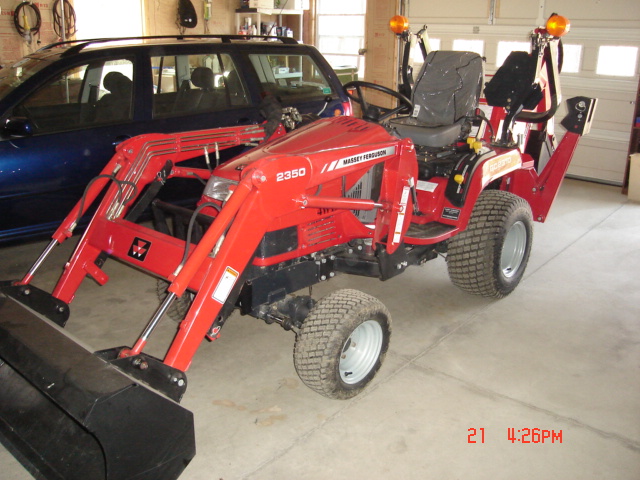

How 'bout a photo of yours?
