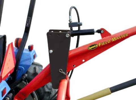

Just trying to guide the auger. It has a hole in it where we can put a rod or pipe & kind of manhandle it into going the direction we want after it's started boring off in the wrong direction.
   / Diff. between "Cold Finish" & "Hot Rolled" steel? #19
What I was trying to get at is use a solid bar for the hole then weld a pipe handle on it . If you have an old pry bar (crowbar)it would be perfect size for a 1" hole and then you could size up to a 1.25 or 1.5" pipe that is necked down (heat and beat) you should not be bending the pipe or the crowbar stock.
   / Diff. between "Cold Finish" & "Hot Rolled" steel? #20
I only have limited experience with my PHD, but it seems to me that you have to move the tractor a little as the auger goes down or it'll drill crooked every time because of the geometry. Maybe attach a level onto the pipe..
