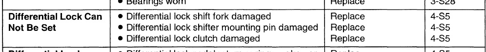

Go to this site and download the shop manual.
Index of Kubotabooks/Tractor Owners Manuals/

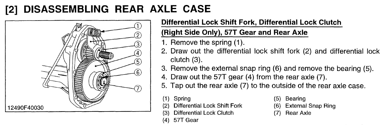

Unless you engaged the diff loc when things were spinning, it is hard to damage the mechanism. However, if you did then be prepared for work to remove the right side axle case.
Physically check the linkage under the floor first.

Contrary to what Dave said, and this is with all due respect to him and all his contributions to the forum, You do have to pull both axles to get the diff. cage out.
When you get to the point of taking it apart be very careful or you can open up a lot more than needed and spill bearings, gears,shims,and it is scary. I learned this the second time around when I had a young friend helping me who got impatient with me taking so long and jerked the rear case out spiking everything out. This assembly rides on 2 or 3 shafts and the fit is pretty tight so it takes time and patients to get it separated at the right spot.This was one place the manual came in real handy.
Please understand that I am not bad mouthing the manual and would never be without one but as I was told by an old Kubota parts man these books were printed assuming that the user has been through th company schools and has a good basic understanding of what he's doing.
