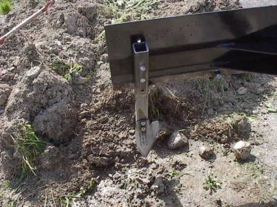

</font><font color="blue" class="small">( This is almost exactly what I need. I need to cut small drainage ditches alongside and/or at the base of hillsides. Does any one make a middle buster that is offset to the out side of the rear tires? Sort of a “side buster.” )</font>
This is what I did. See attachment. Gerard

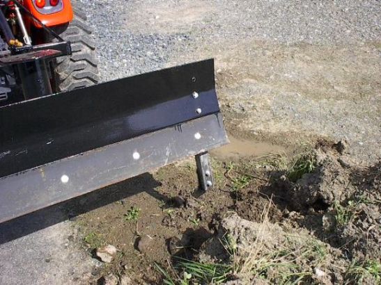

Another view. Gerard

Gerard, how deep can you get with that? That blade looks very familiar, what did you fashion it from? I like the concept of what you did to offset it by attaching it to your blade.

Hmmm, very interesting. I was thinking of something similar. I had thought of attaching a blade similar to a round nose shovel to the bottom of a grading blade. I need to dig fairly large trenches right up next to fairly steep hill/mountain sides. Short of a backhoe I can’t think of a good method.

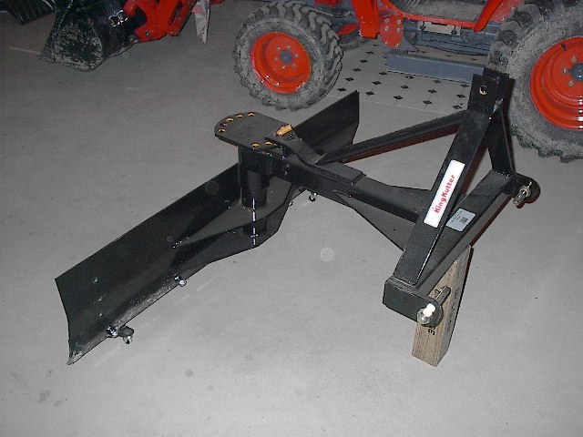

</font><font color="blue" class="small">( Gerard, how deep can you get with that? That blade looks very familiar, what did you fashion it from? I like the concept of what you did to offset it by attaching it to your blade. )</font>
Bob:
With this particular set-up I can go about 16" deep. As for the blade (see attachment) it's a KK. I painted it with gloss black rust-oleum. Hated the mustard yellow. Gerard
