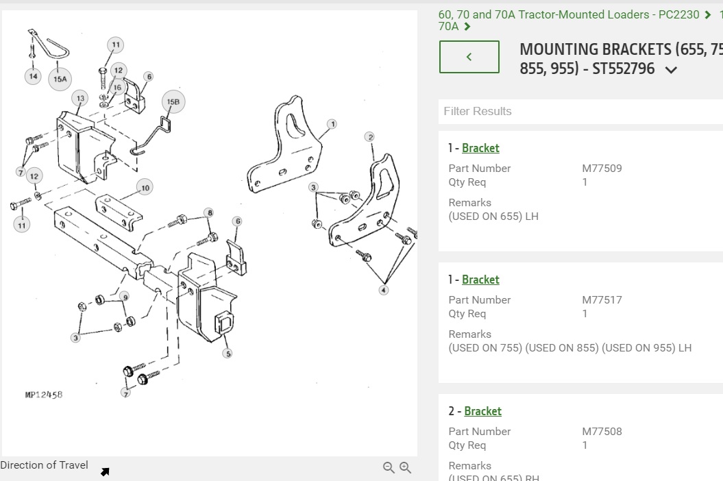

I'm new to this forum, however, I need some help with a friend's John Deere 755 & 855. Everything says the FEL (Model 70) is interchangeable, so he upgraded from the 755 to the 855, but when we tried to put the 70 FEL on the 855, it doesn't fit. Tried finding the specs to see what the differences might be between the 70 & the 70A FEL's, but have had no luck. Can anyone help me with this?
/ Differences between JD Model 70 & 70A FEL's?? #9
:welcome: to TBN
Go to the JD parts site, and put in the model 70, scroll down to the loader and view the different bracket parts to match up what you have and what you may need different.
Quite a bit of information there.
https://partscatalog.deere.com/jdrc/
/ Differences between JD Model 70 & 70A FEL's?? #10
Sample of what you should see when in jdparts and have put in the model 70 FEL and looking at mounting brackets.
/ Differences between JD Model 70 & 70A FEL's?? #11
Beenthere. Thanks for your reply. The only issue I have is the parts site doesn't give dimensions, so I don't know if ithe new parts will correct the issue. The loader mounts in same rear brackets, however, the front monits are about 4 1/2 inches further forward. Yhe loader buckey doesn't clear the longer front end on the 855.
