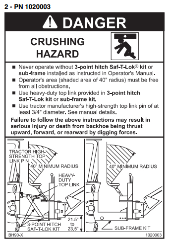

When I was looking to put my BH70X on my M4700 Woods gave me a part number that I gave to my dealer and my dealer told me it was a 3 point hitch saf-t-lock/HD toplink used w/ a BH90X.
From the BH90X manual
Apparently bigger tractors can handle the 3 pt stress.
/edit - that was still going to cost about $1,000 list.

I have a BX 70x with thumb on my 4200 john Deere. Went with the subframe mount. Also use the tractor hydraulics. I wouldn't want to use a 3 point backhoe on my small tractor. I know people have had good luck with them. But, the subframe stiffens the whole tractor, distributes the stress over the whole tractor also. I use mine from cleaning up fencerows, digging clay gravel, stumps, picking up and sawing logs. Regular trenching in light soil doesn't stress one that much. It's all the other things that you'll use it for that will. My little tractor is a hydra-stat transmission , I put it in neutral and don't leave the backhoe seat to move the tractor around when I am working it. This is just my opinion, I grew up running a 580 superk case backhoe and have countless hours on one in a full size. Hope this helps LUTT

I've told this story before somewhere on TBN. I had the top link break digging a 6 Ft deep hole. I road the seat down, face first and the control levers luckily didn't puncture my gut. It was a wild ride seeing the bottom of that hole coming up towards my face. I also broke one of the lift arms which just about threw me off the seat when the left side of the hoe dropped suddenly.
I got a frame mounted bh on my new tractor. It is much more stable and doesn't swing back and forth like the 3pt. Much more pleasant to operate.

Dang! My neighbor that's a shop foreman for the local New Holland/Mahindra dealer has seen several 3 point related incidents when it comes to backhoes. They won't hardly sell one on a 3 point because of this. Thanks for sharing that. Glad you didn't get seriously injured. LUTT
