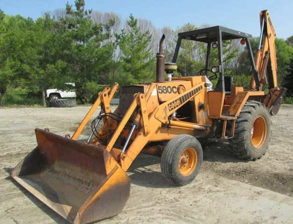

I grew up using a backhoe for a loader, first a Case 580C, and then an old Ford. The loader buckets on them are roughly as high as they are deep.
I noticed on many Ag tractors the FEL bucket is a lot deeper than it is high. What is the reason for this?

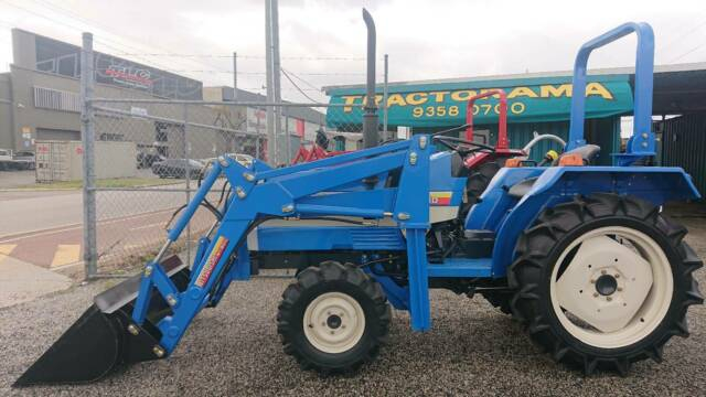

The bucket pictured is shallower than any I have ever seen and I have had numerous loader farm tractors over the years. Buckets were shaped like the one on the 580 without the backsplash addition.

Many of the lower long buckets are more in line with the skid steer buckets.

I’ve never seen a bucket like that on a tractor. That’s pretty standard on a skid steer. The advantage of a long bottom bucket is they scoop a lot better than a half round bucket. The main reason they do it is so you can see over the top of the bucket. The disadvantage of a long bottom bucket is they lower your loading height and reduce breakout force.

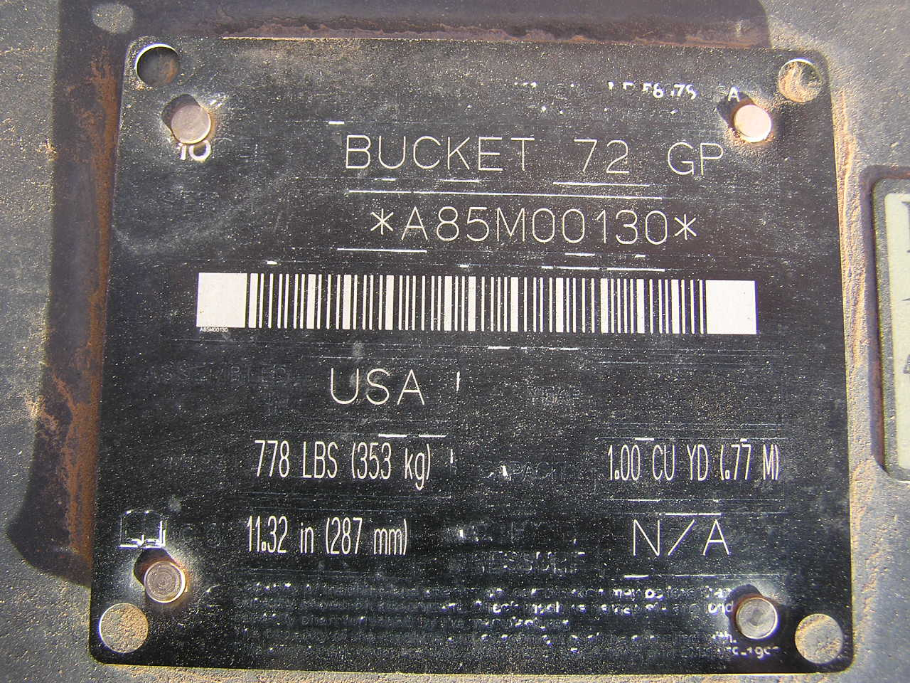

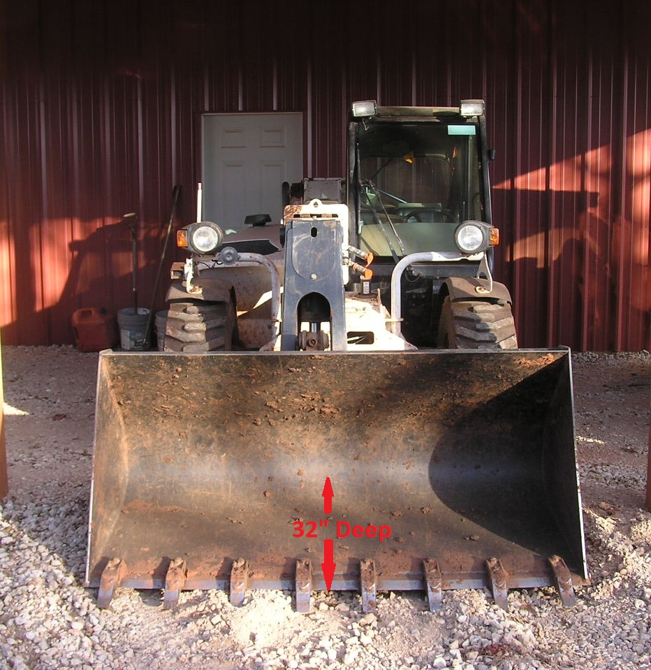

My 72 inch bucket is unique, made for the Bobcat V417 compact telehandler:

That bucket shape is semi-common, called something like a snow or sand bucket. That iseki/Mitsubishi is probably near somewhere that has a damp season. Possibly that bucket is wider than it should be, compared to a more symmetrical one.
