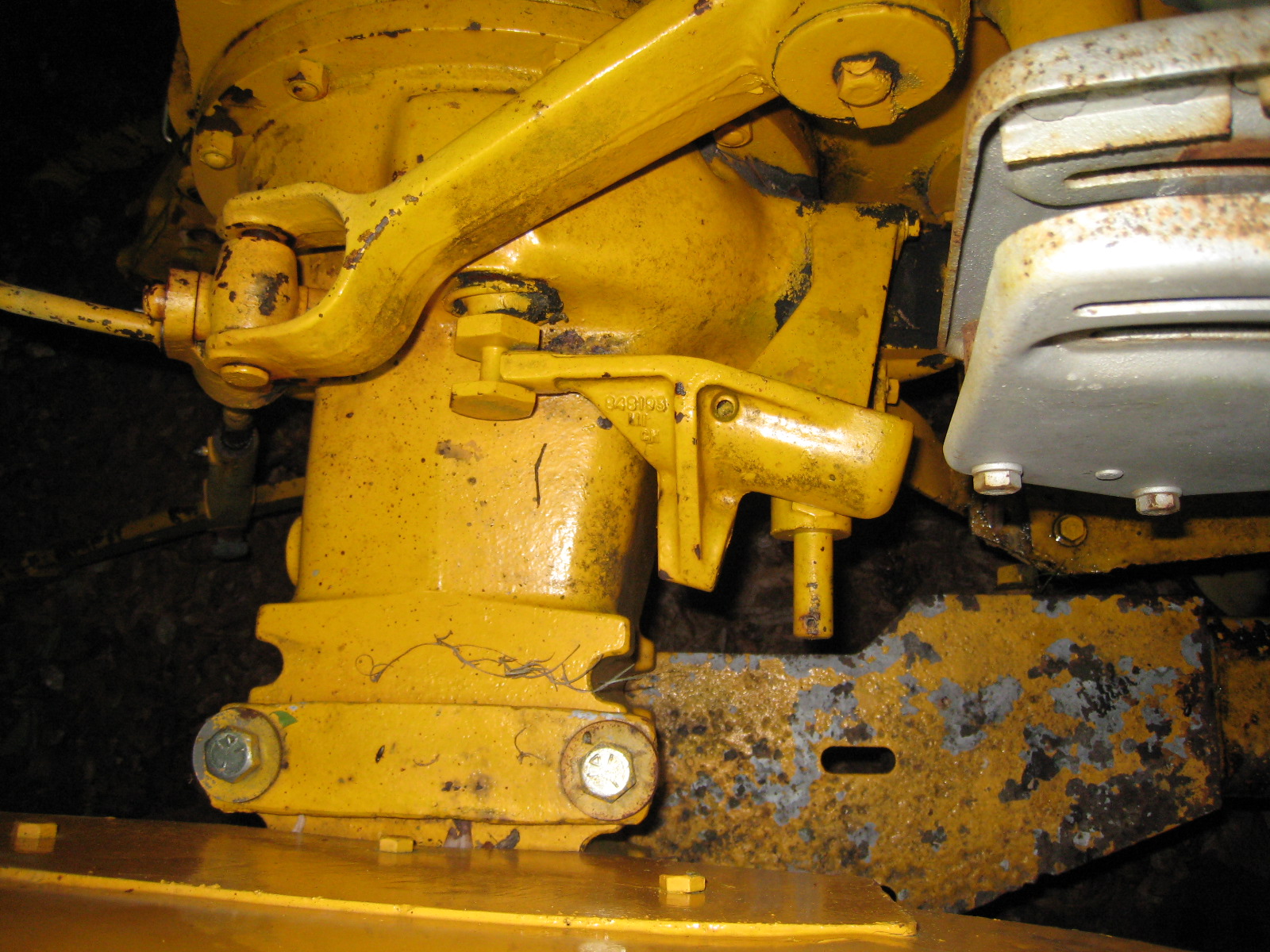

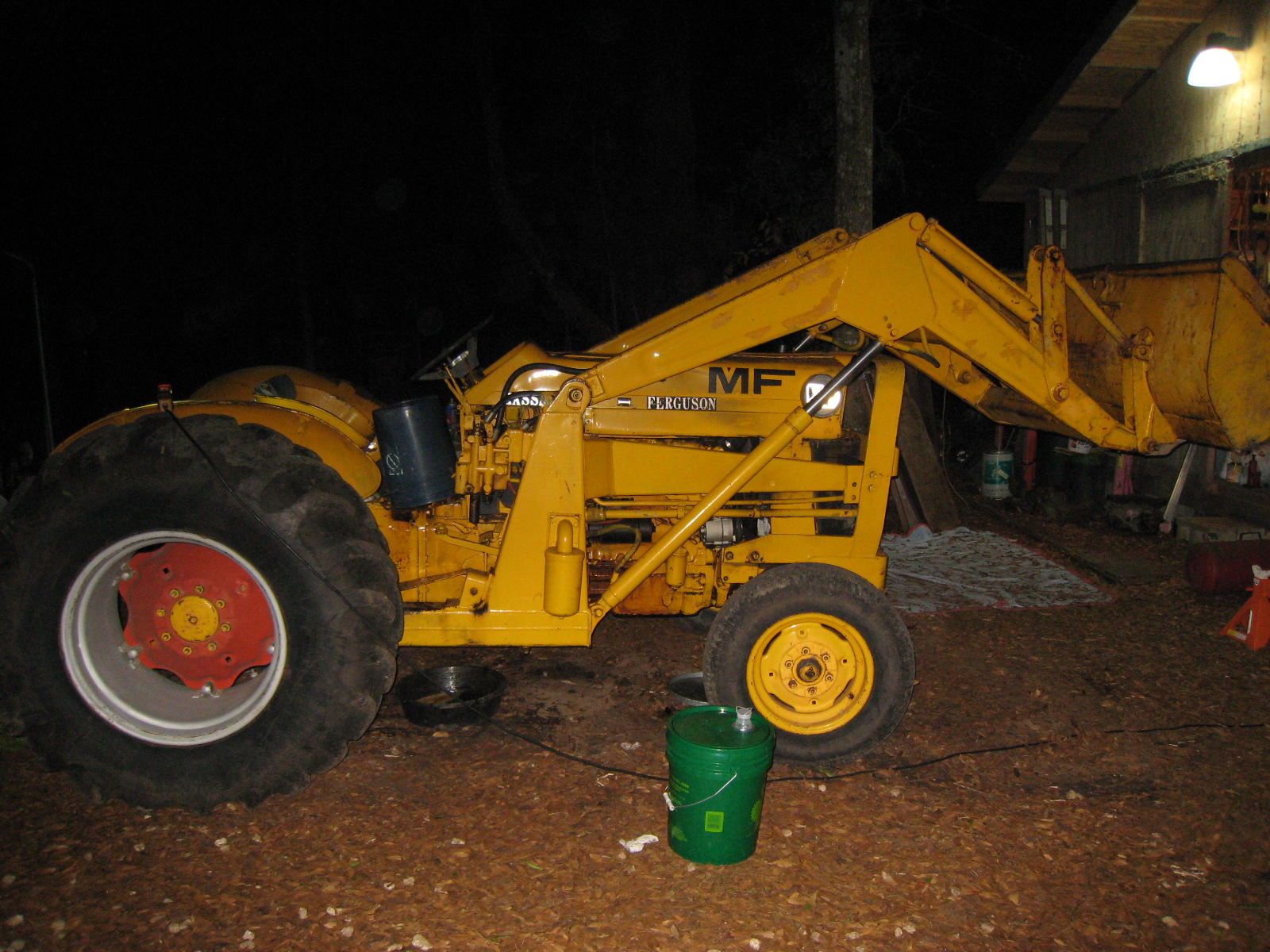

Hi,
Brand new to the list and also to what I believe to be a MF 3165. But I am puzzled. While waiting for my manuals to arrive I am learning everything I can from the material on the net. One thing I know I need to find is the differential lock lever and pedal. From all the sites I have searched I cannot find one that shows the parts that are on my tractor. I have attached three pictures in hopes that someone here could advise. Do I not have a 3165?
Thanks
Dean

/ Differential Lock #4
Isn't that a picture he posted of the diff lock shaft guys? Missing pedal, but it appears to also be on the right side in his pictures, unless I am mistaken. Or is that something else?

Guys,
Nothing on the left side of the seat or elsewhere on the rear axle. I can work the piece up and down with a long screwdriver with causes the plunger to move in and out. Just puzzles me why I can't find this type of assembly in any of the part books/websites. It will be interesting to see what is shown in the manual when it arrives. I hope to test it tonite using the screwdriver and see if it will actually lock the differential. If it does I hope I can get it unlocked!!

/ Differential Lock #7
Some of those had a big ugly handle you used to lock the diff. it was just a rod that you pushed by hand. I would go easy as the shaft may be sticky and get stuck in.
/ Differential Lock
My guess is that the shaft that enters the diff housing needs to move into the housing to engage the lock. At least that is what happened when I tested with the screwdriver and that would correspond to pressing on a pedal or lever in the vacinity of your right heal.

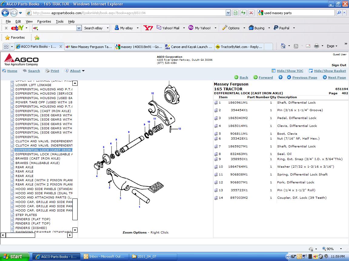

/ Differential Lock
Found something very similar listed under MF 165 cast iron axle. The actuating lever/pedal is a bit different but the theory and operation is the same.
D

/ Differential Lock #12
I have a mid-1980's MF250. It has the same axle lock. Pedal on the right engages and, if working properly, it should disengage easily. Mine does not so I leave it alone.
/ Differential Lock #13
The MF3165 is the industrial version of the MF165. That cast axle is the same one your tractor has and those pictures are of the differential lock.
/ Differential Lock #14
That looks VERY similar to the diff-lock on my MF250. It appears the pedal is missing.
