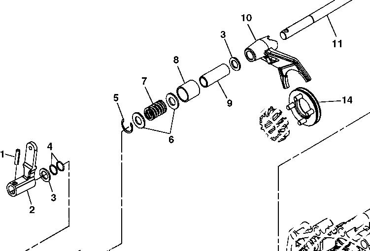

Seems awfully difficult to engage prior to any wheel slippage. To get the thing to engage you really have to stand on the pedal. This is on a 3520 cab tractor. Things are setup alot different on cab models than the open stations so I assume there would be a difference. Sometimes if the rear wheel is already spinning, it will go right in. However, it would be nice to engage beofre spinning (and not have to blow out my knee trying to engage)when you know its gonna happen. Any info on this feature would be great or is it something it needs to be looked at next time it goes in. thanks

Think of it as a pin going into a hole. The hole and the pin need to line up. If you are headed into a soft area, try gently turning the left or right while gently pressing on the diff lock. Making a slight curve is often all it takes to get one wheel traveling slightly farther than the other to make the lock engage. I wouldn't be trying to lock the differential with one wheel already at speed and the other not moving.

But I do find the diff. lock (at least on my 4300) to be tentative at best. Sometimes locks well and other times just doesn't seem to line up. But I try to avoid engaging it while one wheel is spinning, as it is a positive mechanical movement of fingers engaging without a clutch allowing some slipping. Too easy to break something if engaged while moving.
Best seems to be to come to wheel stop, push/step on pedal, and then begin forward/reverse movement easing into it as the mechanical fingers align and engage.
jdparts might show how your 'fingers' are engaged through the linkage with the pedal.
Here is shot of the pins that have to line up for lock. And I hear that they can shear off. (ouch!) (item #14 )
Item 7 is the spring that pops it out of 'lock'

Well here has been my experience.. you have to have a tire moving slightly most of the time to get the lock to engage, BUT you don't want to be really spinning one tire rapidly and let it hit with a bang either. So what I do is press down moderately on the lock pedal, and then move forward or backward, gently until it engages and starts to yank you out of the hole. Then release the pedal and the pedal will soon disengage by itself and you will usually hear a pop or click when it does. There are just so many slots for it to engage into and you have to find one of them. But it can be damaged if you hit it too hard. I have never had any trouble with any of them on the 5 tractors I have owned, but if your experience is different, then perhaps you should have it looked at.

On my 3320 I find it best not to stand on the pedal. Just put some light pressure on the pedal and it will engage when it needs to, it just sorta drops into place. On places that I know I will need the lock, like backing out of a hole with a loader load of wet dirt, I start the engage even before entering the hole. The thing will lock up going in, allow me to really dig into a pile of dirt, and let me pull out with no issue. Works for me.

well it all makes sense now and seems to be operating normal. Just that my first time having this feature with a tractor. It works as all of you suggest. Turn the wheel a little and using somewhat light pressure. All your suggestions seem to work. I thought it was just supposed to glide right in easily under any circumstance but i was wrong. Thanks everyone for all your input
