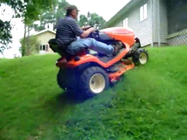

The GR would work well up to 30deg up or down.Across slopes I bail past 25 deg or so.The only way I would buy an early model,2000 or 2100 series is if all the uprades were done and documented.The 2110,2010 models or newer should be fine.
To determine whether you need a 4WD you need to do some measuring with a $10 slope finder and a scrap of plywood(so you don't have to put your nose on the ground to read it) and walk the property. A good 2WD machine w/locking rear will handle slopes up to 25 deg,up,down or sideways unless extremely wet.Even then,additional weight will be needed on the rear to minimize the rear tires from sliding on the downhill runs.This is me mowing the 30 deg bank with my GR; Video
http://vid498.photobucket.com/albums/rr342/locknut-1/MOV00014.mp4

Locknbut- that is pretty steep, but still short. I have steeper than that, from what i can tell from pics, and longer runs too... FWIW

Just so you know, flipping over backwards on a slope like that won't be any fun. And it can happen very, very quickly. just sayin....
Happened to a neighbor about a mile down the road last year.
Don't want to lose anybody.
