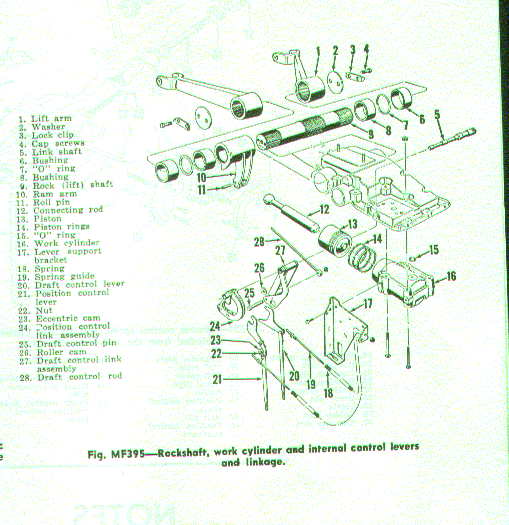

I put the hydrolic housing back together. I only need to put the piston housing back on. There are two claw hands. When I took it off I did not see where they grab onto. They are the control levers for the three point. They attach onto two half circles that are each two spaced 1/4 inch apart peaces of metal that the claws sit inside and hold a small circle that moves them around. One claw is about 4 inch diameter and I can't seem to find how it holds into place. See picture 23 and 20 fit ontot the bar but does it fit in the circles or just on the bar?

#19
Down to putting the top cover off. Then I find that the top plate has a side vent to check for presure. It was cut off on the new one. So I have to drill it out and rethread it.
