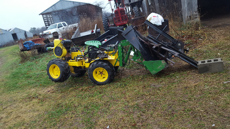

I also say if this^^ I idea wouldn't work use a small tractor like a steiner, dingo.
Here is my mini loader. It's kinda like a Steiner but from the sounds a Steiner is 4ft, but this one is smaller
Ignore my over loading and tipping it. Really need to get the rear weight bracket built

That looks like an old burkeen or vermeer vibratory plow
