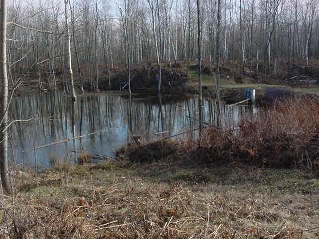

As mentioned by others, building a small dike at the end of a swale, etc, isn't too difficult and if your soil will hold water (clay, etc.) may be the way to go. Yours looks like 0.2 acres or so, will post a few pics of one I built a few years back this way, floods about 0.75 acres. PONDS ARE GREAT - TOO MANY WETLANDS DISAPEARING - CREATE MORE.
penokee /forums/images/graemlins/smile.gif /forums/images/graemlins/smile.gif
   / Digging a small pond with FEL? #19

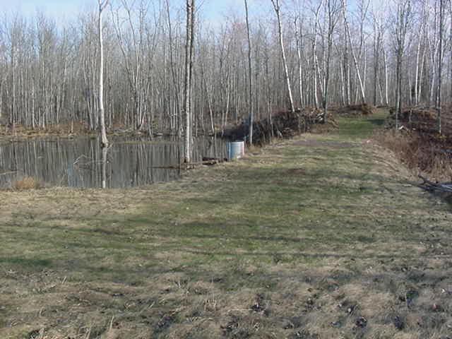

Put in a Cotrol Structure so I could draw it down (Haven't done it). Also may need an Emergency Spillway if you anticipate any seasonal increase in runoff.
