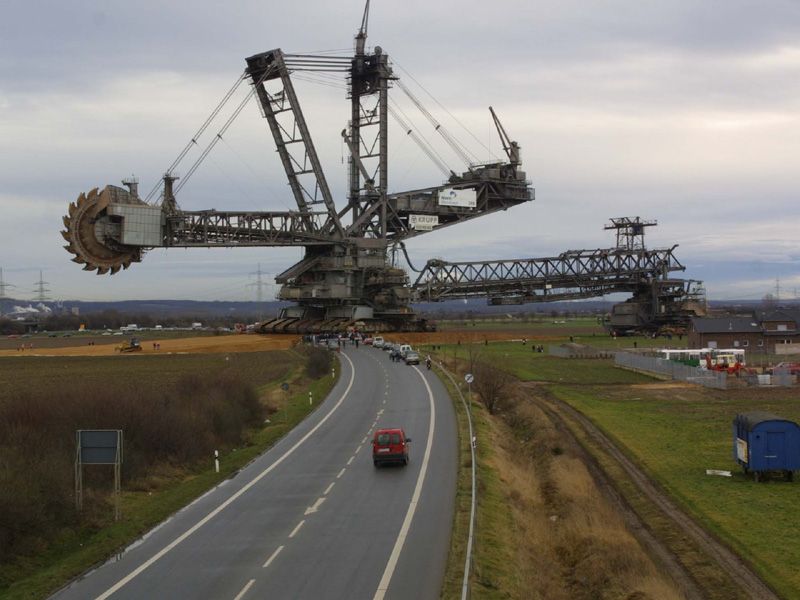

Hey Wushaw...I am trying to make a deal on this machine. Do you think it will dig my clay? :)

I wonder how much the oil and filters would cost for the 50hr. service!!!:eek:

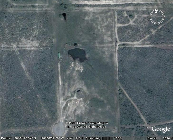

Here is Google shot of my place, the one big pond if you look to the left that is a 40ft conex so to give you some reference of the size of it, though this shot must be about 2yrs old not sure when they are going to update this area.
