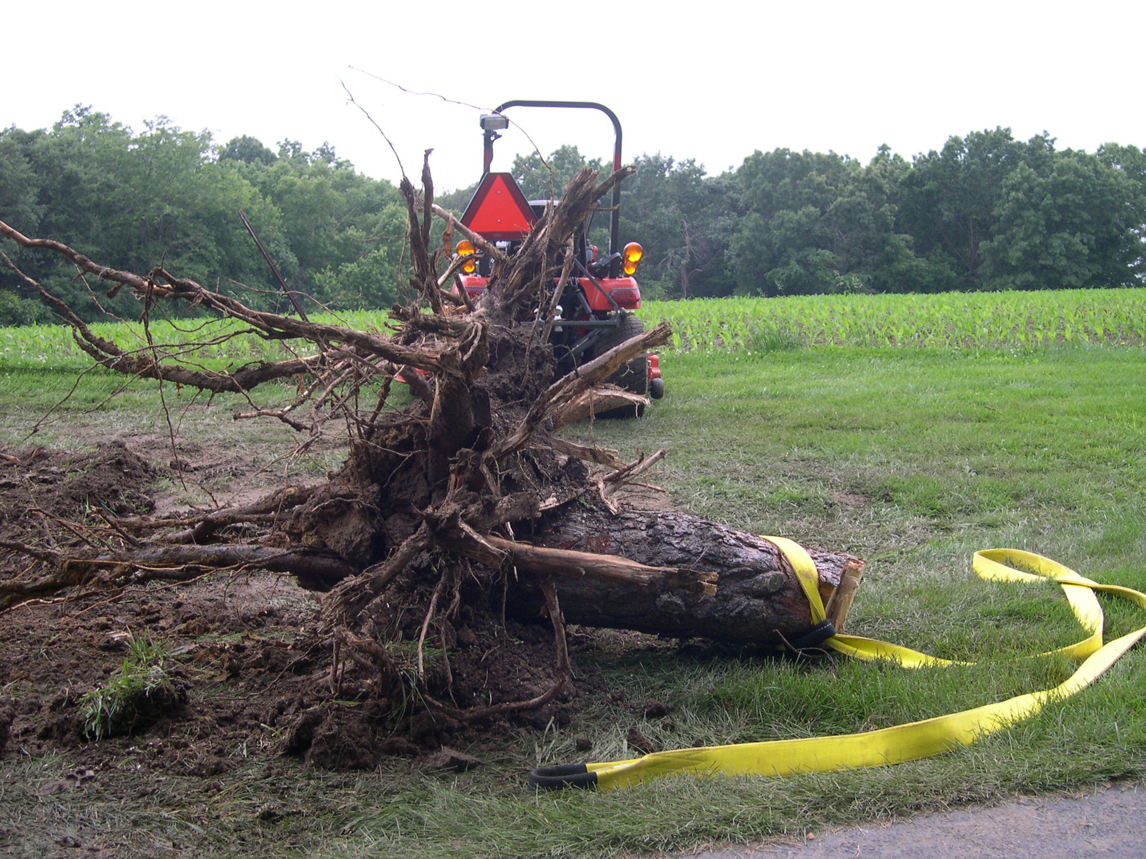

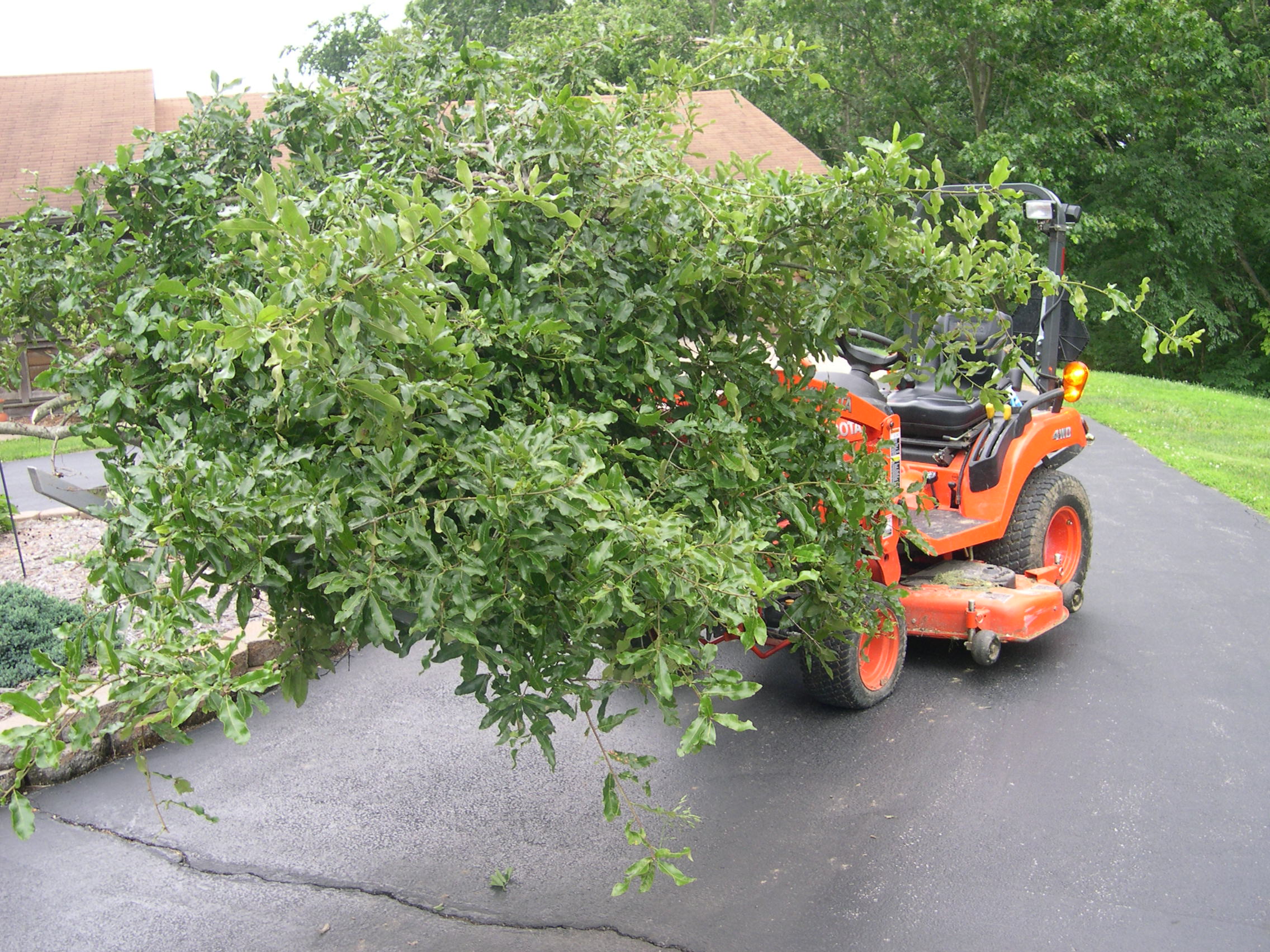

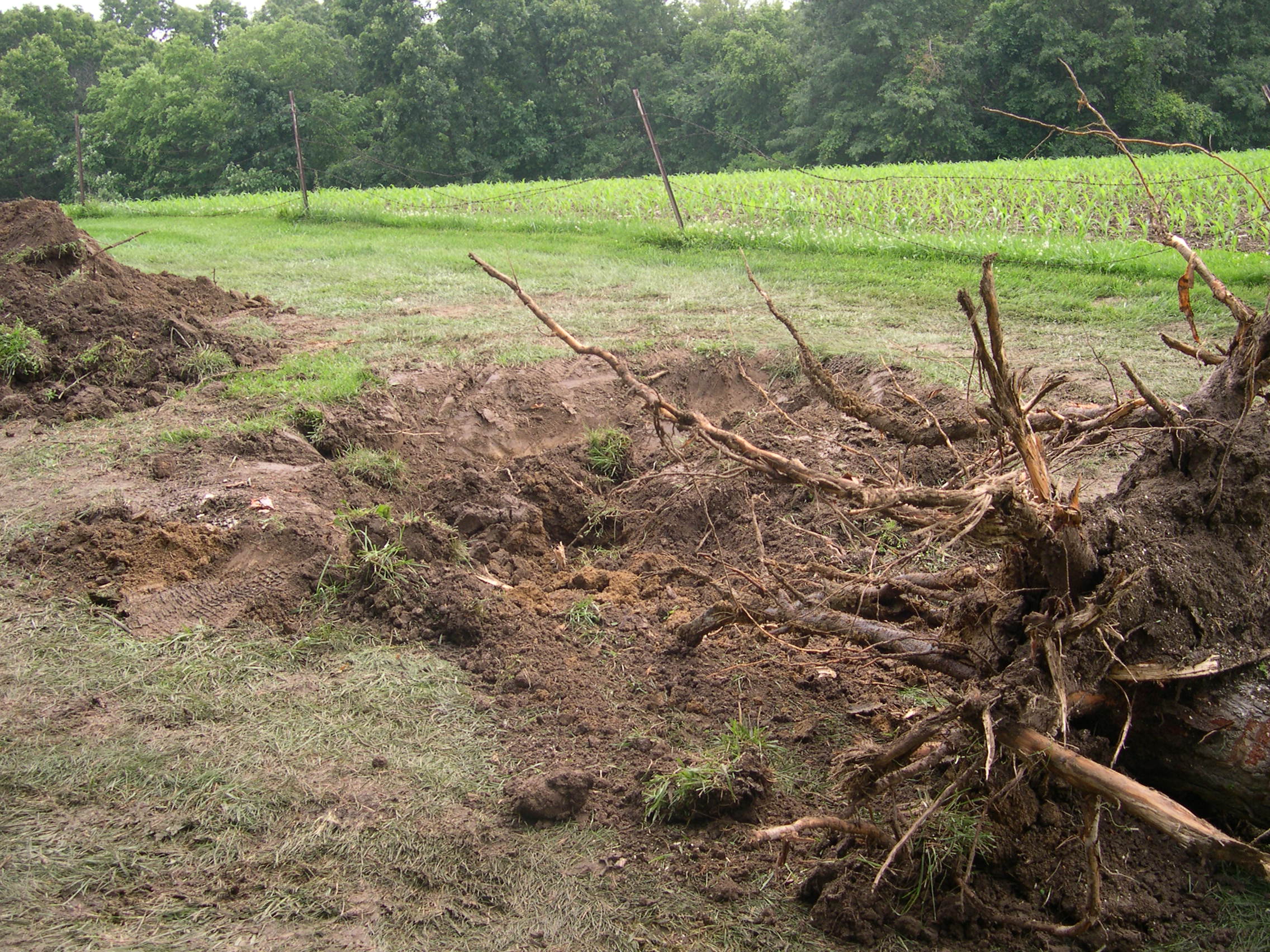

I was able to dig out a stump yesterday with my BX2350. I had read posts about people doing it with a backhoe and didn't know if I could do it with just an end loader or not. I just kept digging out around the base of the tree, maybe 18" deep, and cutting roots. I ended up using my truck to yank the stump out, I'm pretty sure the BX wouldn't have done it. It took maybe an hour of digging to do the job and the tree was about 12" diameter at the stump height. I also included a photo of my use of BXpanded bucket forks. They are really handy for loading up the FEL with the loose brush and limbs.

It was actually quite a load for my truck to yank the stump out. The problem is that there are roots that more or less go straight down that would be pretty tought to get at and cut. I actually got the stump yanked most of the way out from one direction, then had to turn around 180 degrees and finsih pulling it out from the other direction.
