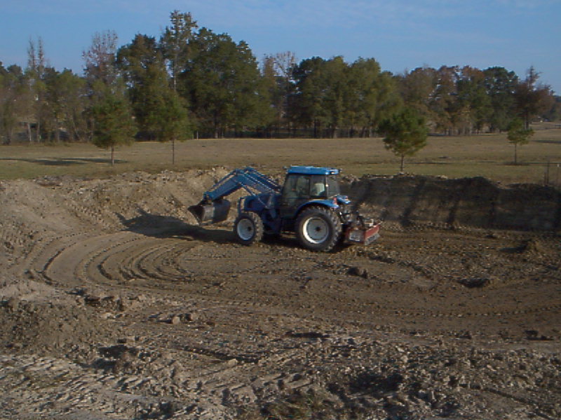

I dug my pond and it's a small one by most comparisons here. It's roughly 80X70ish. Due to slope with my tractor getting in and out and building up the dam, the best I could do was get the deepest spot to be about 8.5'. And that is not for a large distance at all, once again due to the slope. As other's have stated, a lot of what I dug ended up in the core trench and dam, but that will also depend on your terrain. I'd estimate my left over spoils were roughy 3 to 4 triaxle loads of dirt. I actually could have used more of it (maybe half) on the outside of the dam. I will be doing more work building it up at a lesser angle than I currently have.

I did the bulk of the work on a long weekend before Christmas with my L3800, mainly using the loader (with tooth bar). I'd guess your Dozer will be much more efficient and stable making much shorter work of it.

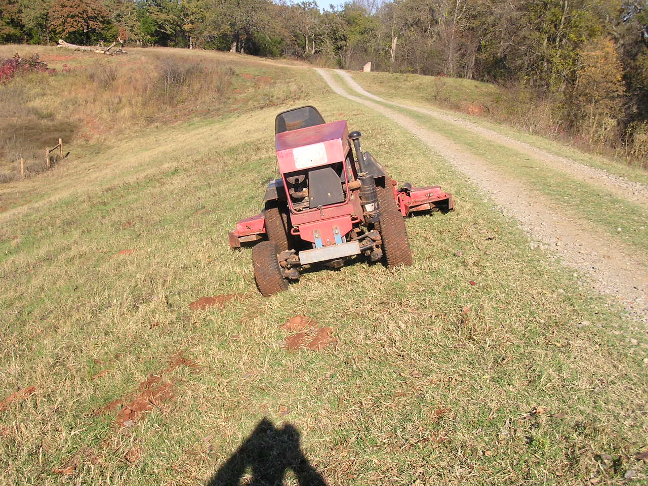

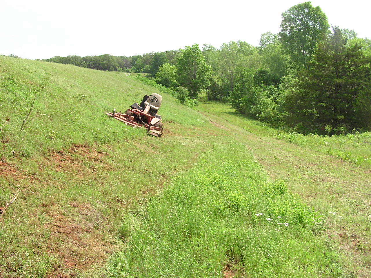

View attachment 370657My advice is to make sure you have plenty of dirt on the back slope with not less than 3/1 slope (4/1 is better)so it has plenty of strength to hold back the force of the ponds water and to make it easier to put some grass on it to prevent erosion then mowing will be easier also.
Totally agree on 4-1....that's 4' wide for every 1' of height. The custom dozer guy that built my dams suggested and provided 3-1 and I find that too steep to feel comfortable mowing with any mower of any height; even with ballast in the rears. Also agree on the interior sloping.
Mark
/ Digging Pond questions #35
Mark

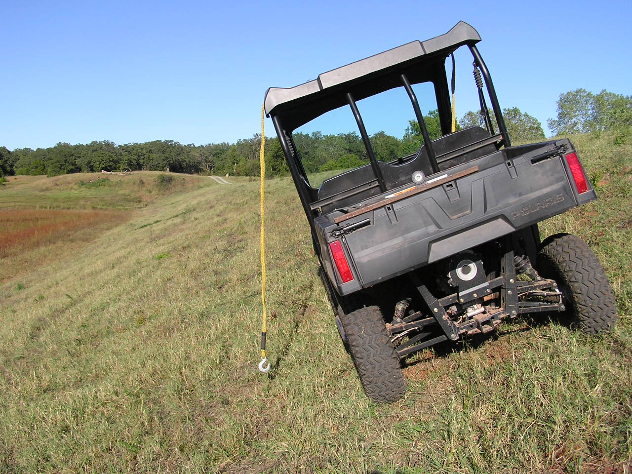

Here is what 3-1 looks like.
Not too bad to mow, but have to have 4WD.
And 2-1 on the back of the dam.
Even with 4WD, the mower tends to slide sideways downhill. :eek:
