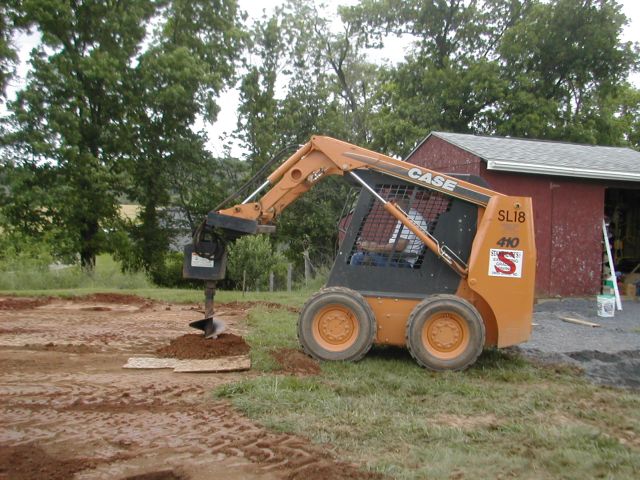

I'm about to start construction on a 36x48 monitor style pole barn. I had to special order the 24' poles for the center section and they're supposed to be ready for pickup in 3 weeks.
My site has been leveled and layout finalized and the next step is to drill 20 15" diameter holes for the posts. I'm planning to bury the posts 42" deep and I want to start out with 48" holes to allow for 6" of concrete under the post.
What has me stumped is whether I should buy a 3-point hitch auger or rent a skid steer with auger. A 3-point hitch auger would definately be a good investment and have other uses around my property, but I can't figure out whether it would have the ability to drill a 48" deep hole.
Can someone who's "been there/done that" give me some guidance on the right tool for this job?
Save your money....rent a small excavator...you can then use the excavator as a hoist to help place and support the poles as you plumb them....

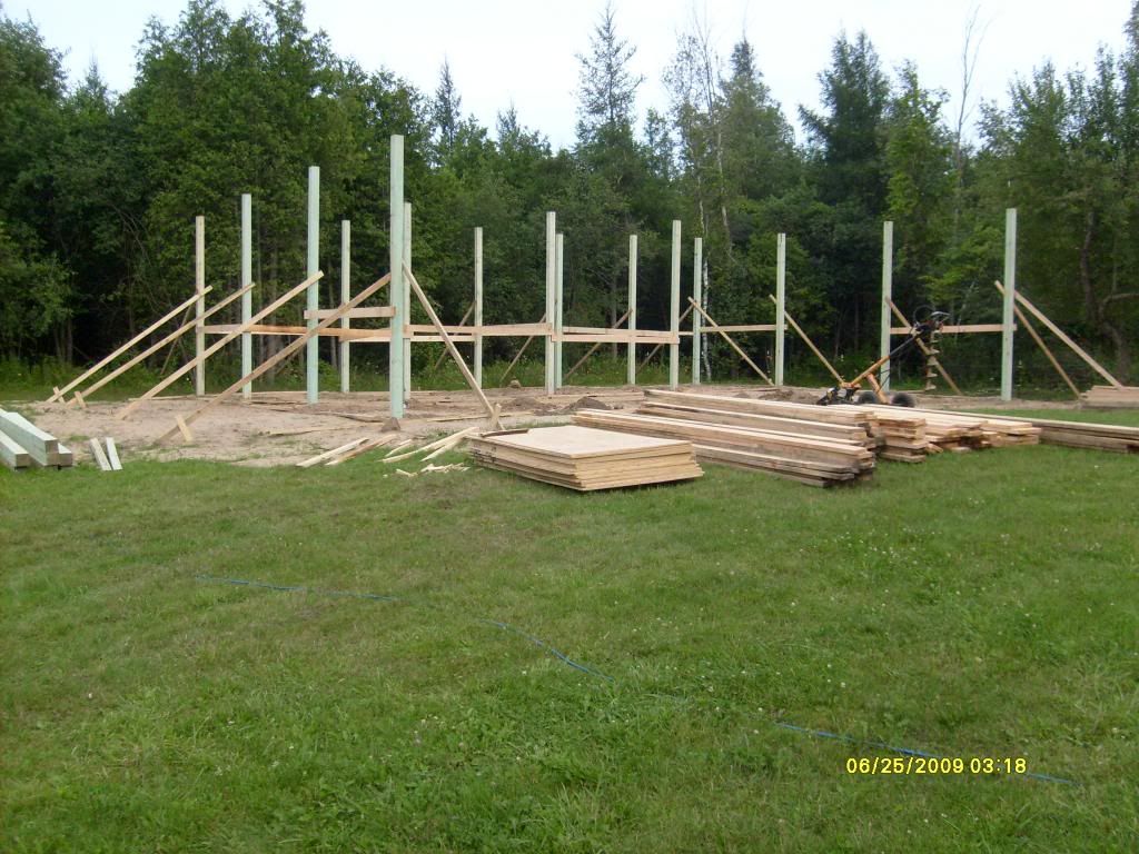

One idea for drilling your hole's for the poles is to rent a hand held/towable. worked great for me. only used a 10" hole. you can use two 1x4 boards nailed together in a V shape to guide your pole into the hole with out knocking the walls into the bottom of the hole. this is a pic of the begining of ours. 36'x48' and 6x6 poles 12' on center. instead of having to buy extra long 6x6's you can frame in a floor on your middle section and save some $$$ on the pole's.

The skid steer will be easier and far faster. You may want to take a manual post hole digger and have a go at it to see how easy your soil digs. You are going to need to do some manual digging regardless of the auger method. As mentioned, augers that measure three feet will need an extention. Fifteen inches in diameter is alot for a three point in hard to dig soil. I have dug hundreds of nine inch holes usually to four feet but to five on occasion for posts with my 3pt and trust me, it is not fun especially if you have hard soil. Not to mention, if the three point jams, you need to take a four foot pipe wrench sometimes with a piece of pipe to unscrew it.
Still, if you have the need, a 3pt might be a consideration.
I agree that the precast concrete "pills" will do just fine over ready mix. Regardless of footing, tamp, tamp and tamp some more. Are you going to pour ready mix in around the posts? Lots of opinions on this. Some say the concrete accererates rot. I had a builder use this method in the past. He used the pads then poured around the posts. His theory was that since there was a "seam" between the pad and the concrete, that the water would be able to drain away. He had built many barns like this.
Good luck and have fun. Nothing like a new barn to warm the soul.

Thanks for all the information- looks like a skid steer rental is in my future! Also, it looks like I'm going to have 18" holes since rental place doesn't have a 15" auger.
I response to a couple of the questions, I've already ordered the 24' posts and they weren't that much more expensive than the shorter lengths that were in stock.
My strategy for the footings is to drill my holes to at least 48" and carefully pack/tamp the hole bottoms. Before I set the posts in the hole I'm going to nail a horizontal 2x4 brace 42" above the bottom of the posts; when I set them in the hole that will be hanging 6" above the bottom of the hole. Then its just a matter of pouring the concrete and tamping it thoroughly to make sure that it flows up under the bottom of the post. After all the posts are set I'm pouring a slab, so there will be approximately 4' of concrete supporting each post.
