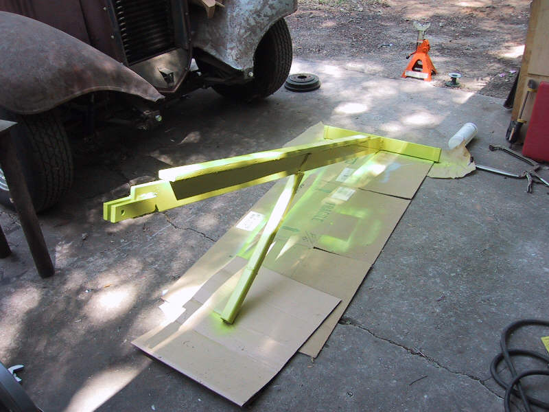

I added the reinforcement to the top the bar as seen in the attached photo. I also beefed up the support bar. Since I only had short pieces of thick wall square tubing I welded three pieces together over the exisiting bar. The weight of this thing about doubled and it is pretty heavy now. I had yellow paint available so that is what I used.

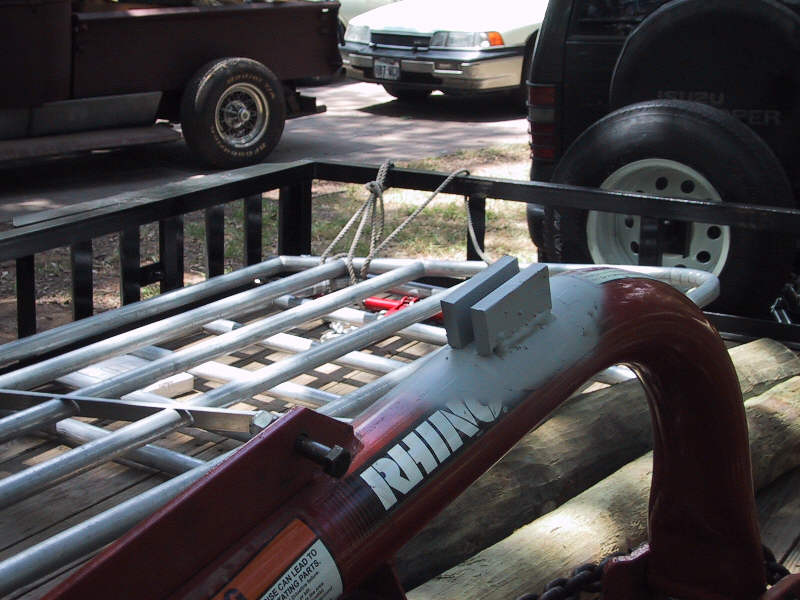

I welded the two pieces of bar stock seen in this photo to the PHD boom to keep the weight bar lined up with the center line of the boom.
