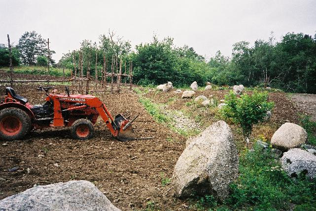

Against all opinions so far I'd try making the trench with the loader. Make it full bucket width and work downhill. I'd start at the bottom and work back uphill as this gives you more gravity help.
My little Kubota B7100 has survived this type of treatment.:D
Picture shows a trench just in front of the tractor. It's about two feet deep and full bucket width. The rocks you see were all moved by the little tractor also.:D
