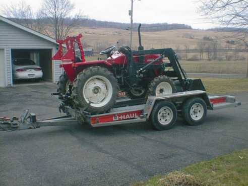

So, with a loader the JM204 is over 3500 lbs? I though the tractor weighs 2500 or so and the loader weighs 600?
Thx,
Dave

Northern website has 2469lbs net weight, 2739lbs minimum operating weight, and 2970lbs shipping weight. If the loader is 600lbs, you can be very close or over. Anyway, its close enough to have to get the details. Good catch Buck.
An alternative is to rent a dual axle car carrier trailer from U-haul or equivelent. The guy who purchased my first Jinma, used one. Only issue he had, was using the car tire straps, forced the tractor toward the front, and too much weight on the tongue. Recommend using other straps to get the weight over the axle. The U-haul did not have adjustable tracks, so it was a good thing I had the front wheels in their wide position. Need to check with a 204, before renting.
   / Dimensions of 20hp Nortrac with FEL? #14
I believe your 5x10 trailer is rated for 3500 lbs gross vehicle weight. It will have a 3500 lb axle. This weight is total weight with the weight of the trailer included in the 3500 lb. The next axle size is 5200 lb. /forums/images/graemlins/confused.gif
