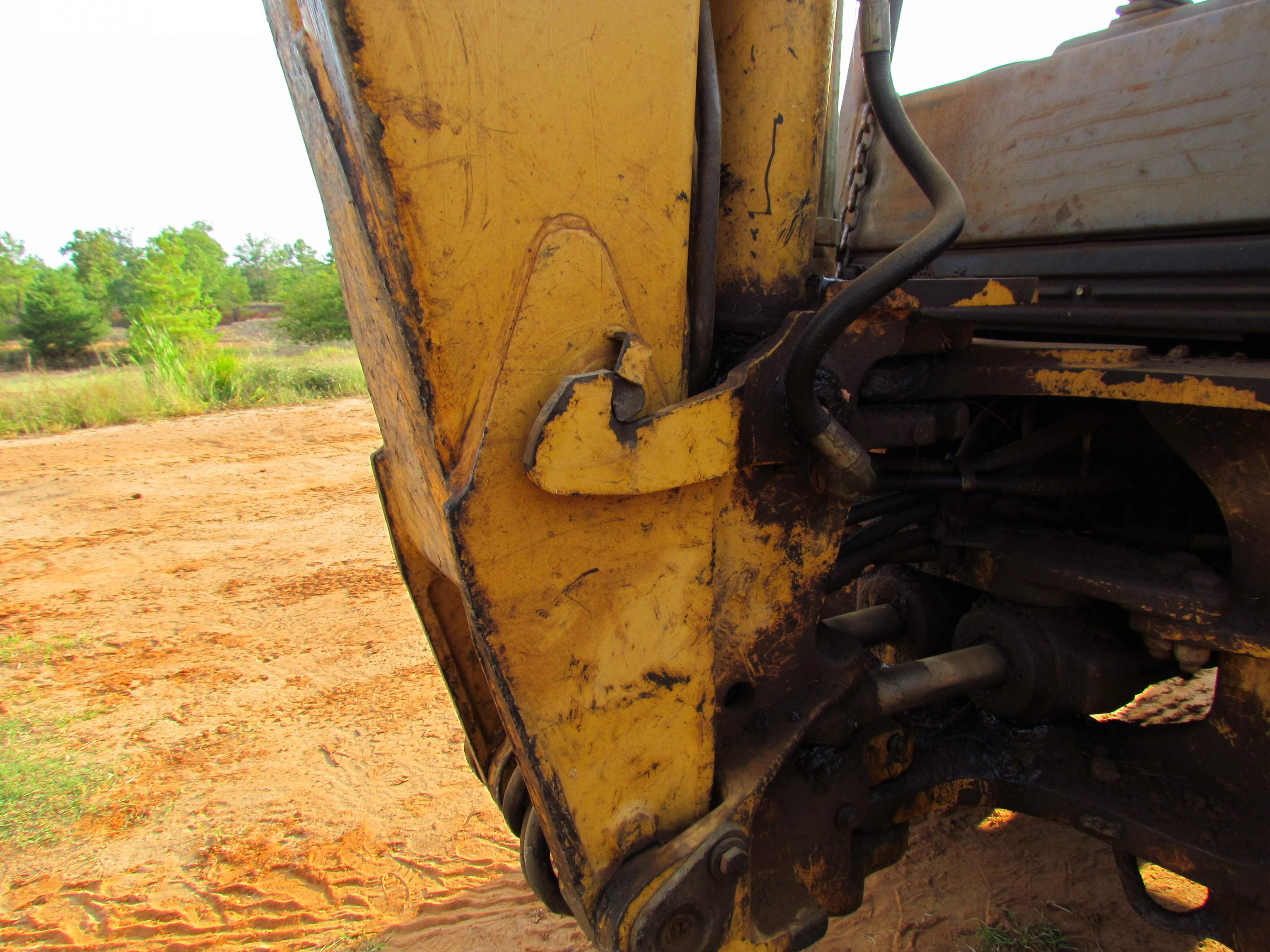

I could be mistaken but I do believe Dads 1960's Ford 4500 has 1" lines running to ALL of the stick cylinders. And I could be wrong, But I was not aware that valve had a PR in it. Either way, we arent going to chain anything to the hoe and tow with the tractor. If it is chained to the hoe, the hoes own hydraulics will move it, if not, we will chain to a solid point on the tractor.
Not to raise a fuss, but you are mistaken. The hoses are measured by ID and not OD. A 1" hydraulic pressure hose is like 2" across.

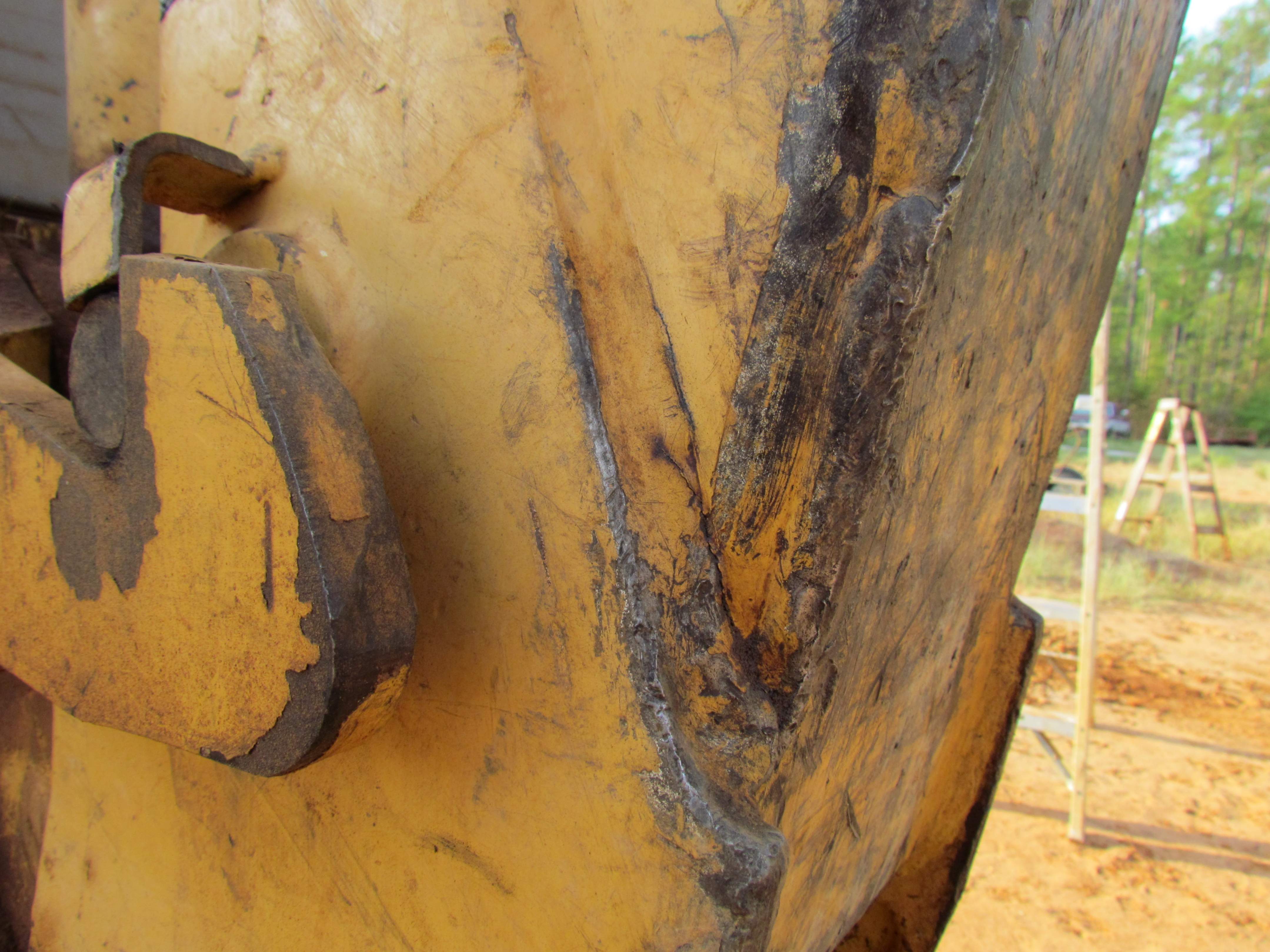

IMO, those are not in need of attention at this time, you could watch them but I doubt there would be any failure there.
I'm curious what others will recommend, but that's how I feel.
If you were gonna weld it I don't think drilling would be required either, just grind it and lay a hot penetrating bead in there.
JB.
JB, Those cracks are like your pants fly. When they are just open a little bit, they stay that way for a long time. But they get more and more open until all at once zipppp!. The dipper stick probably didn't look much different the day before it broke...

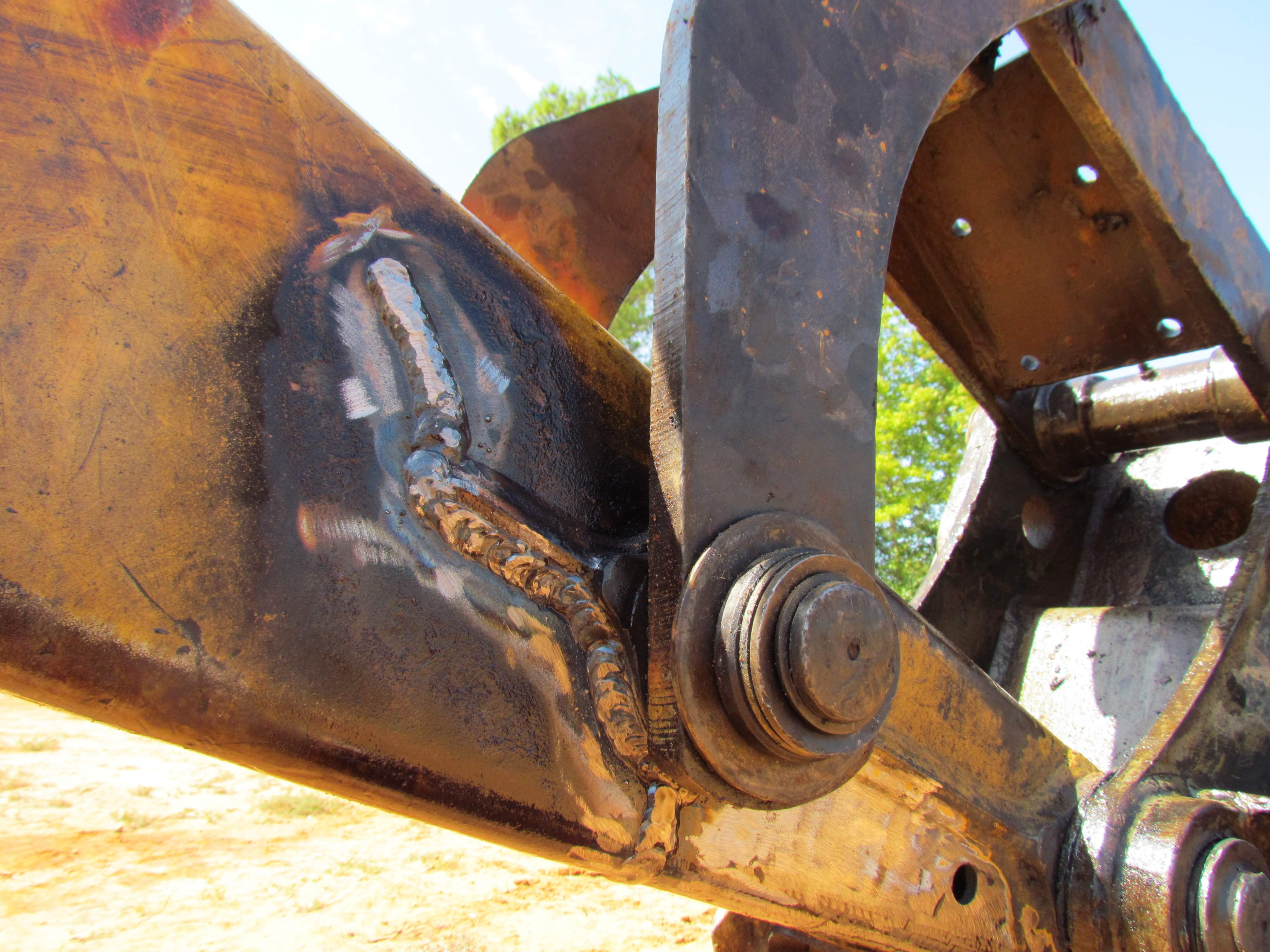

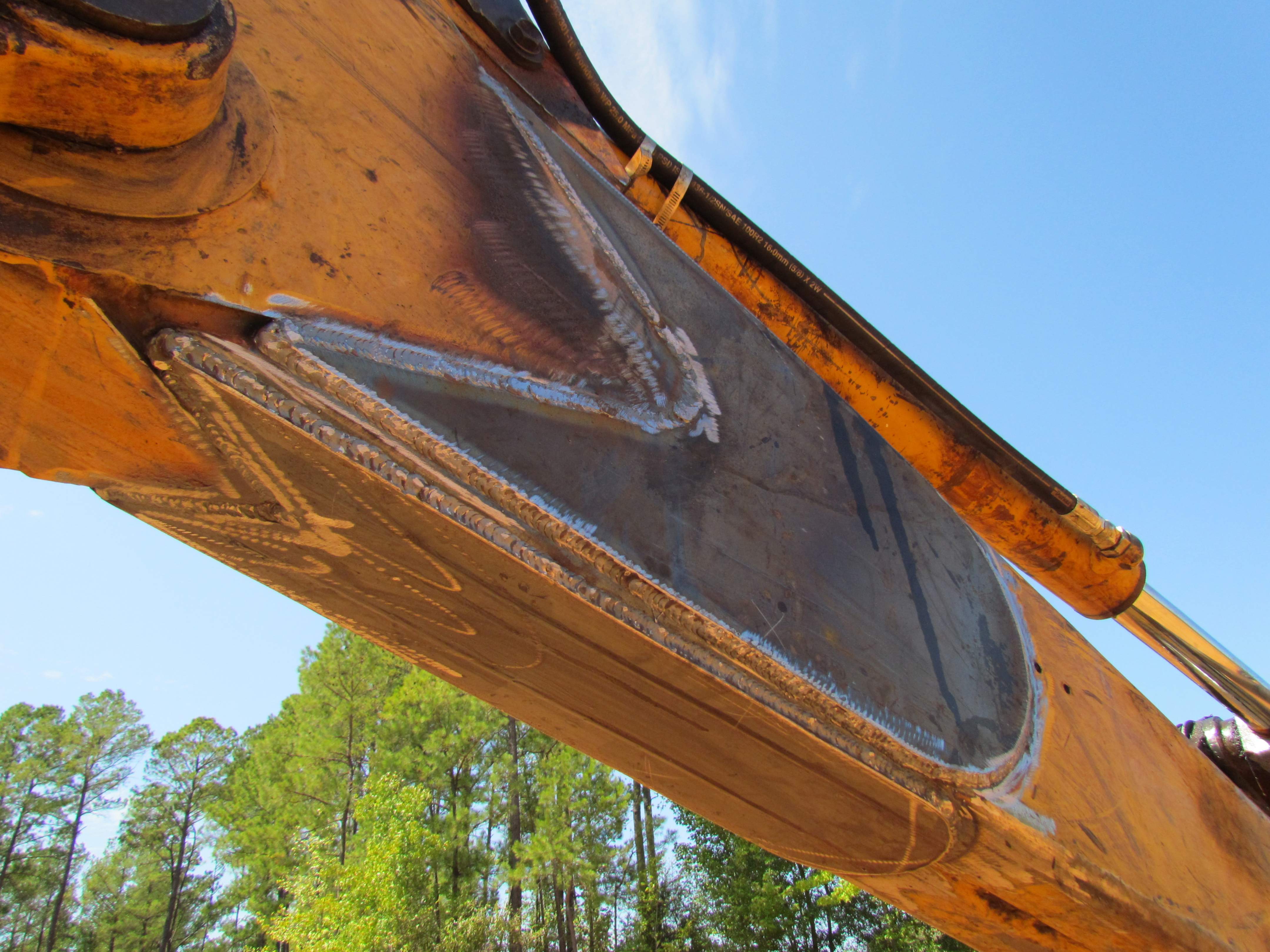

Lew's called and said the Dipper was ready to be picked up. Cost will be $600
I'll post pics when I pick it up in the morning.
Eddie
Good looking repair. Probably worth it if you are concerned about your welding. But, given your other abilities you would probably have done fine. The money spent was all in the prep work they did. The pro's know what to do and don't mess around where us farm boys take longer and waste weld!
Do you know if they also put an internal support in place? I would have, even if it was just 3"x3/8" angle in the inside corners.
I would just hand Dad the keys and let him rip any way he wants. The repair cost is under $100 a year -- why worry about that? You can't get a helper that does as much as he does for that kind of money!
   / Dipper Stick snapped in half #187
Darn good looking welds, like a stack of nickels. :drool:
On a welding site that would be considered somewhat of a putdown, now a stack of dimes is a different story! ;) Considering that this was bench work at a professional shop I'd have expected prettier welds but overall the repair should outlast the rest of the machine. I would however be happy if my welding looked that good. MikeD74T
It would be so simple to grind them out and reweld. don't think you would gain much except peace of mind, but since he already had a catastrophic failure that might be well worth it.
It's not really a crack, it's a separation of the edge of a weld, may of been the 3rd pass? (As mentioned might only be the paint) I know it's still a crack I guess, but different from a crack across a structural member like the dipper must of shown evidence of before it let go.
I'd probably zap it just for peace of mind, but I wouldn't get crazy just grind out the edge of the weld till there was no more evidence of the crack.

You did dam good to get such a good repair for $600. :thumbsup:
That is it in a nutshell. $600.00 for that.....all day long.

I haven't really followed this thread closely, but I have to say it appears the welder did a jam up job on it. The $600 sounds like a lot, but the welder is putting his reputation on the line with the repair job. That's not to say it will never break again, but it's easy to see where the next weakest link is in that dipper stick now. Does that welder know he's somewhat of an "internet sensation" on TBN lol? Plus, he's getting lots of free ad space. I hope your dad learned a lesson from it and won't abuse it anymore!
