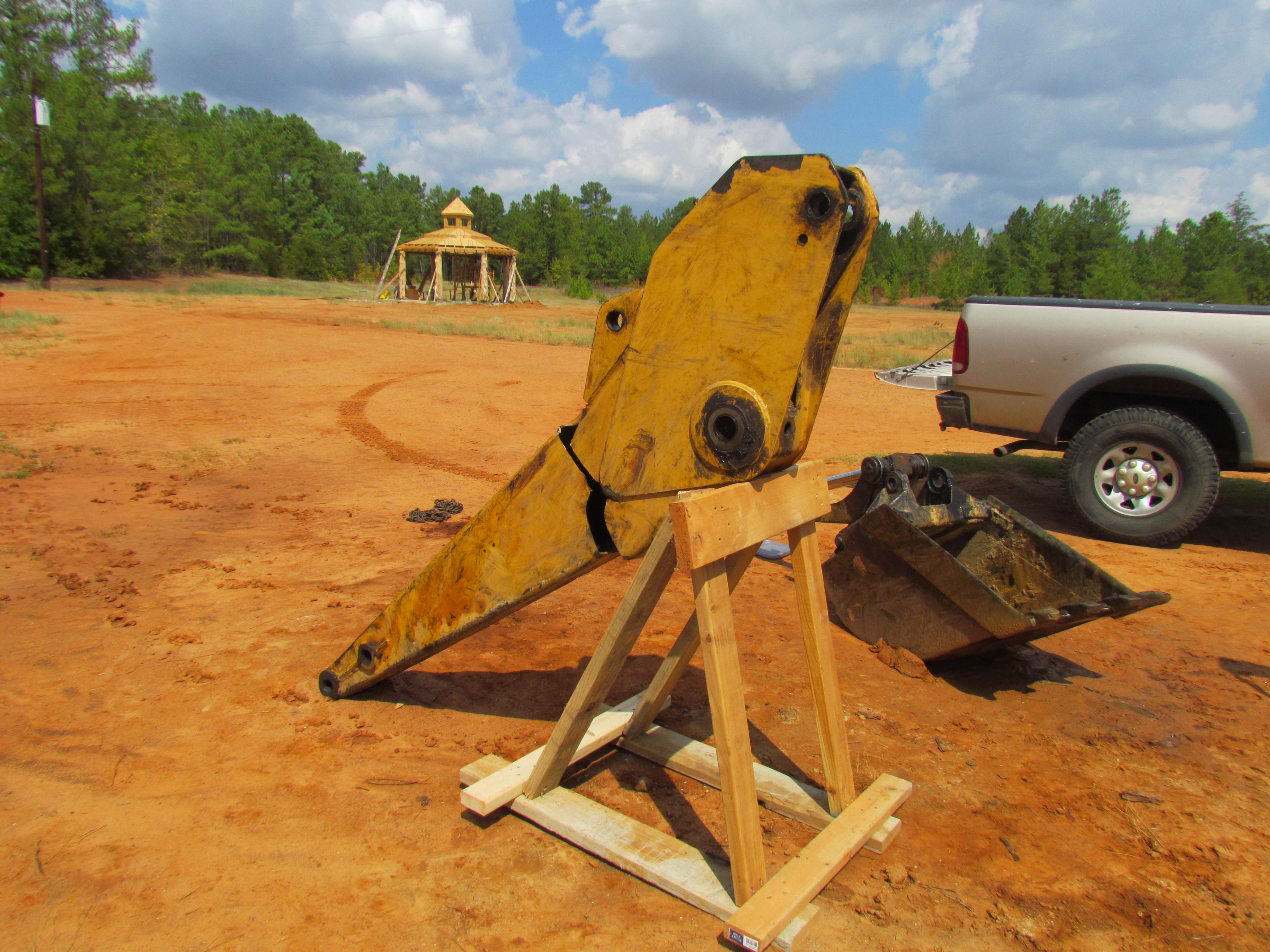

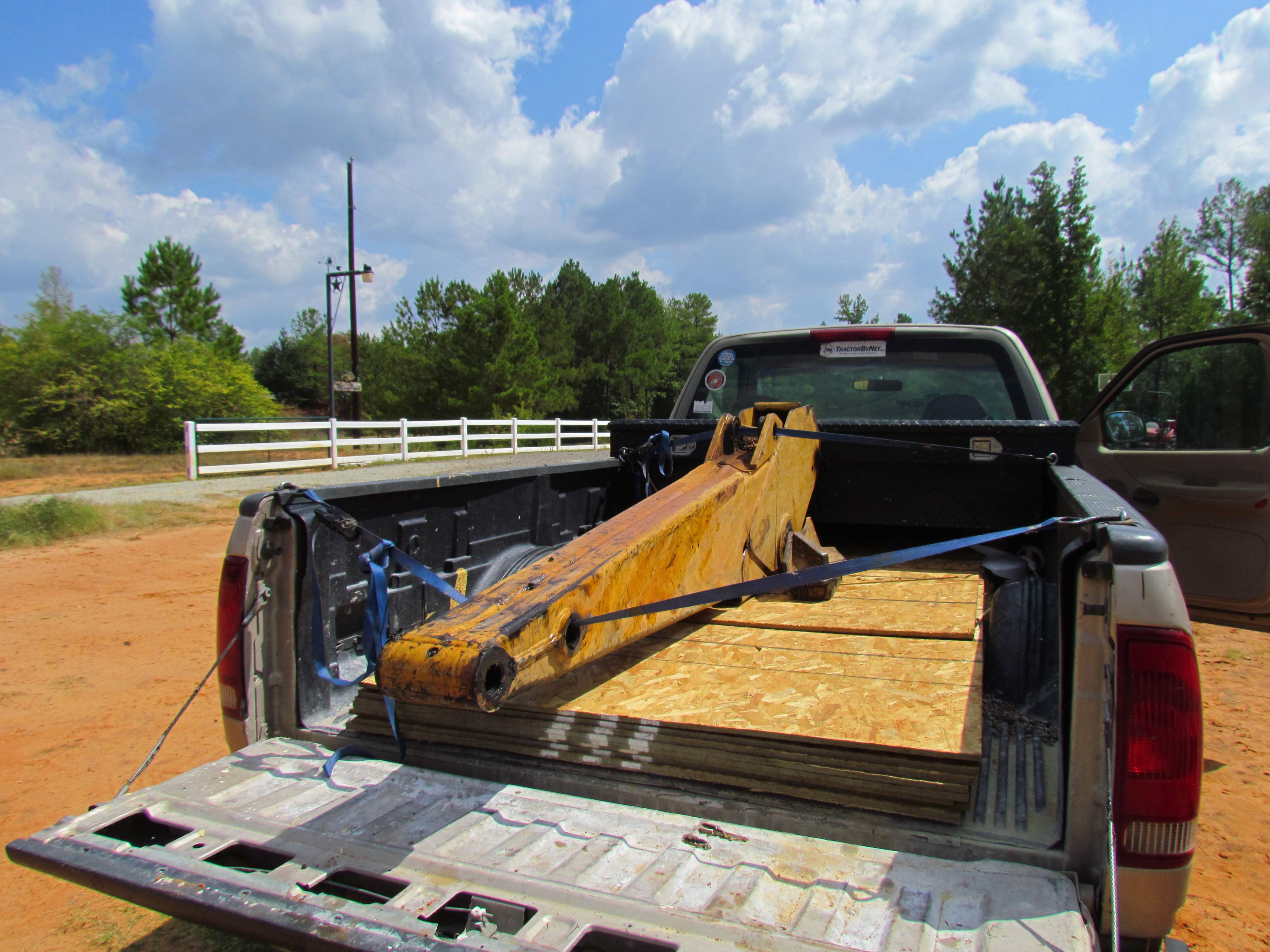

I took off the bucket and then moved the boom over and rested the end of the dipper on the dirt. Then I built a stand to support the weight of the Dipper and plugged the hydraulic lines. After it was all disconnected, I had my dad lift it and put it in the back of my truck.
Eddie

   / Dipper Stick snapped in half #76
Holy cr@p!! Look out Eddie!!!! Your dad's driving your tractor again!!!
   / Dipper Stick snapped in half #77
Thats one way to hold the osb down in the bed of the truck. There are much easier ways though for the future Eddie :laughing:
I'm glad it came off fairly easy for you and hopefully it will be fixed and back together quickly.
   / Dipper Stick snapped in half #78
FWIW, I would have strapped that down quite differently in the bed of the truck.
With any heavy object the real issue is not preventing it from sliding backwards, it is preventing a forward slide.
The brakes are ~3 times as strong as the engine, and there are situations when you have very little control over how hard to apply the brakes. There is never a situation where you must accelerate hard.
