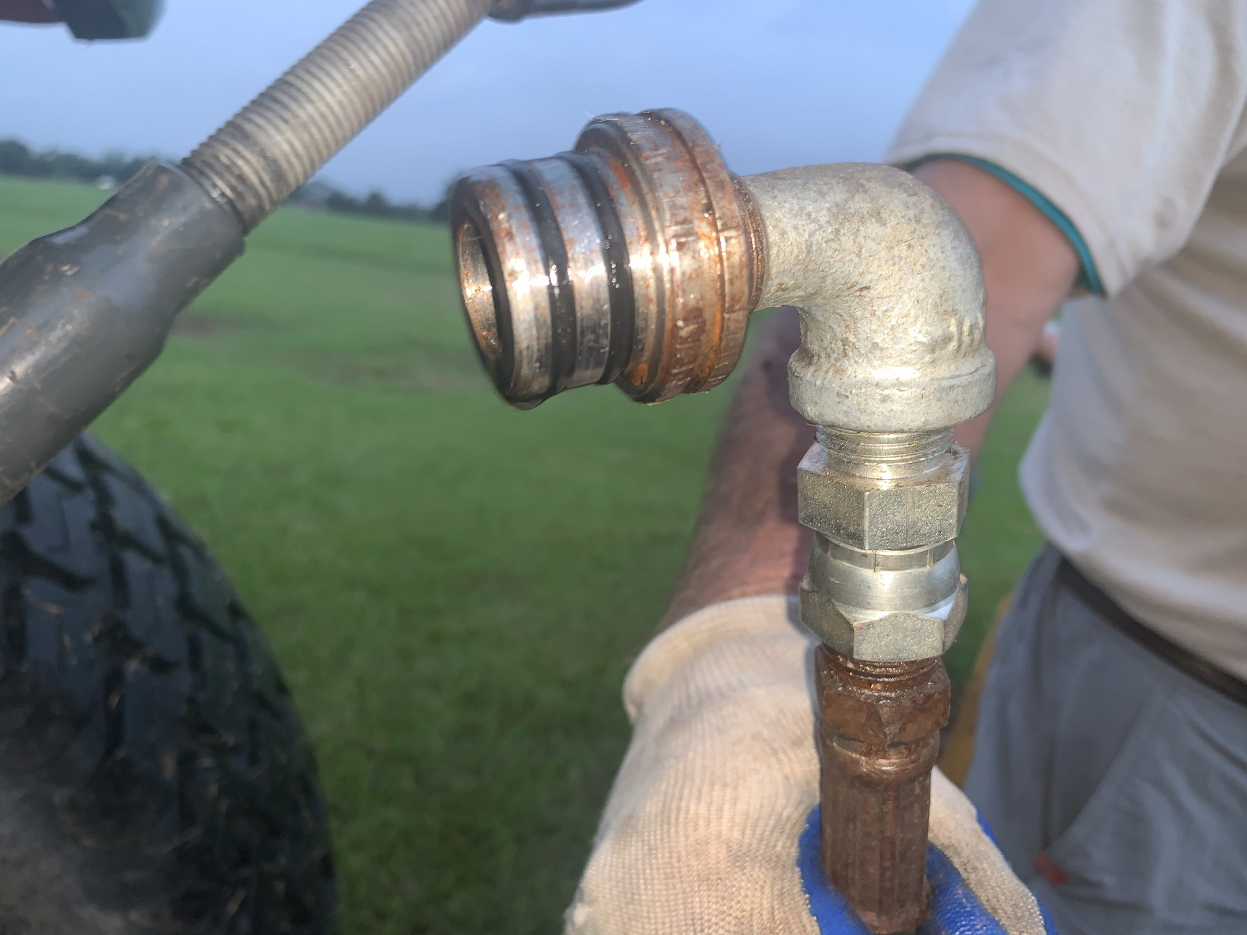

How are you powering it? 3rd functions and remotes all usually have both supply and return lines?

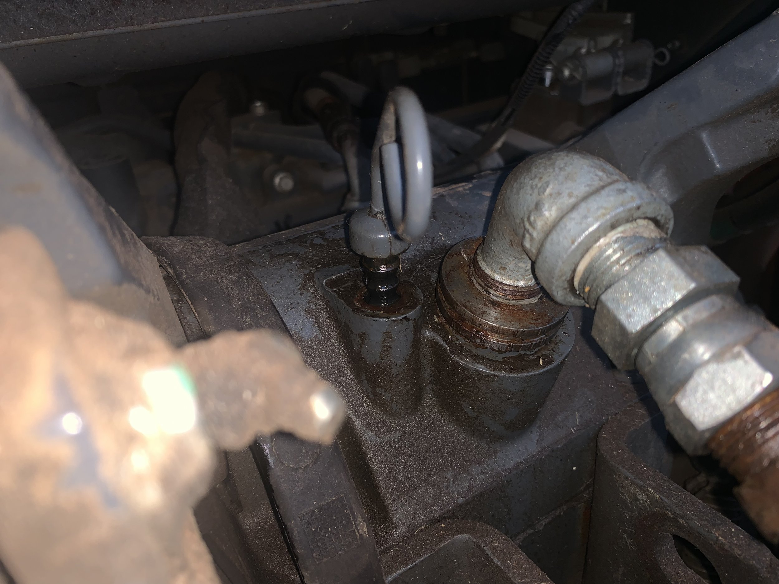

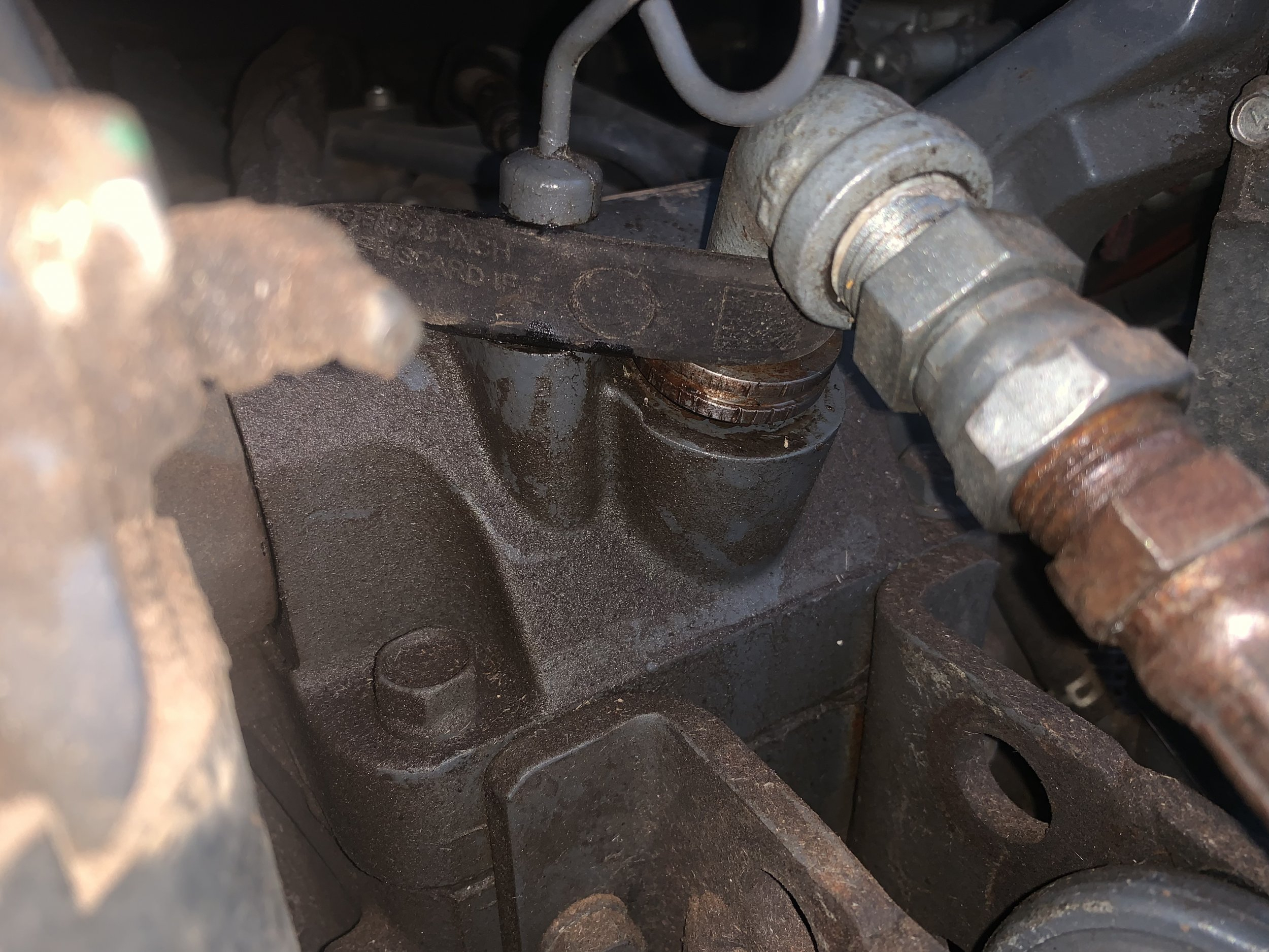

It will get pressure from the rear remote. Laneshark says the return must be direct to protect the tractor pump. That plug with the 10 mm goes direct but appears to be a very odd size.
   / Direct sump return line on Kubota L6060 #12
I tried to find a place to dump on my 6060. I asked the dealer mechanic, and had my machine shop guy try to find a place. No luck with anyone.
I had the same issue on my L5740. I even ruined a $750 valve on my laser grading blade because I had just plugged the return back into the quick coupling. It created up to 800 lbs back pressure on the valve, which blew out the o-rings.
I'm going to try to find the thread I started on the issue with my L5740.
I know this doesn't help you, but the way I did it works for me.
   / Direct sump return line on Kubota L6060 #13
Here is a link to the thread I started years ago with the issues I had with dumping oil back into the tank.
It's a long thread, but it may help you. Go to post #77. It shows the fitting on my L5740
