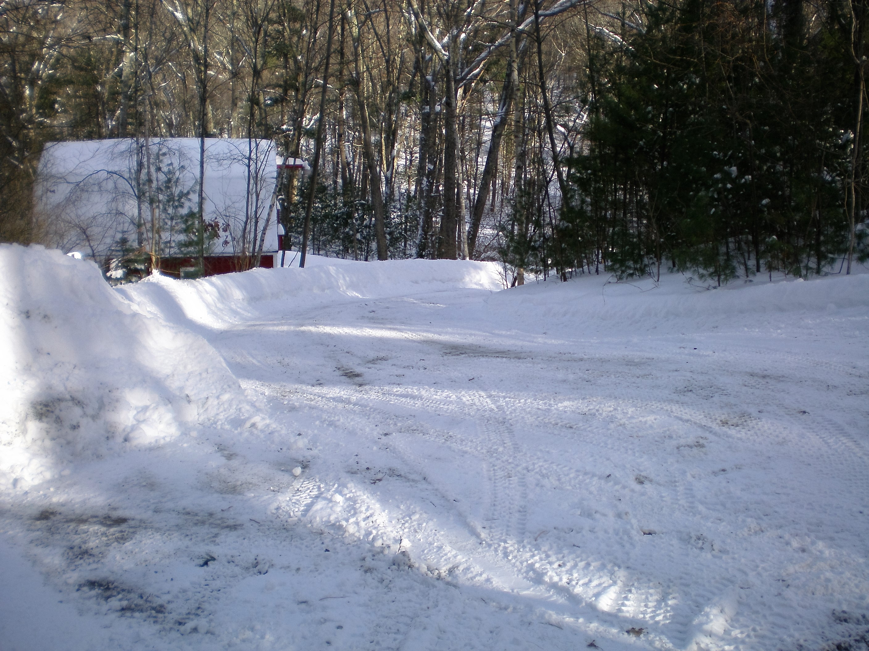

So I would need to box blade the driveway and get it flat as possible again , and then Gravel Gravel Gravel?
No sir not flat as possible again.Mistake first time of that is the case.
Due to angle of pic not sure how wide the ditch is, as road curves left. But it seems as though ditch on the left part of curve is not wide enough and deep enough for water run off.
Two tools needed if your up to it. A blade with off-set so you can cut ditch and add depth of the slope for water run off on the left side.
I could not get a good read on the right side but if you can also cut a ditch on that side also with same slope for run off.
Then the road needs to be crowned for run off from the center of road and eliminate standing water.
The Box Blade can help by pulling in dirt to fill and level out those ruts. Then road can get a final pass for a crown and you should be much better off in the future.
This would be your foundation, then 3 to 4 inches of crushed gravel will have an even depth of gravel as it will follow the contour of the crown you just built.

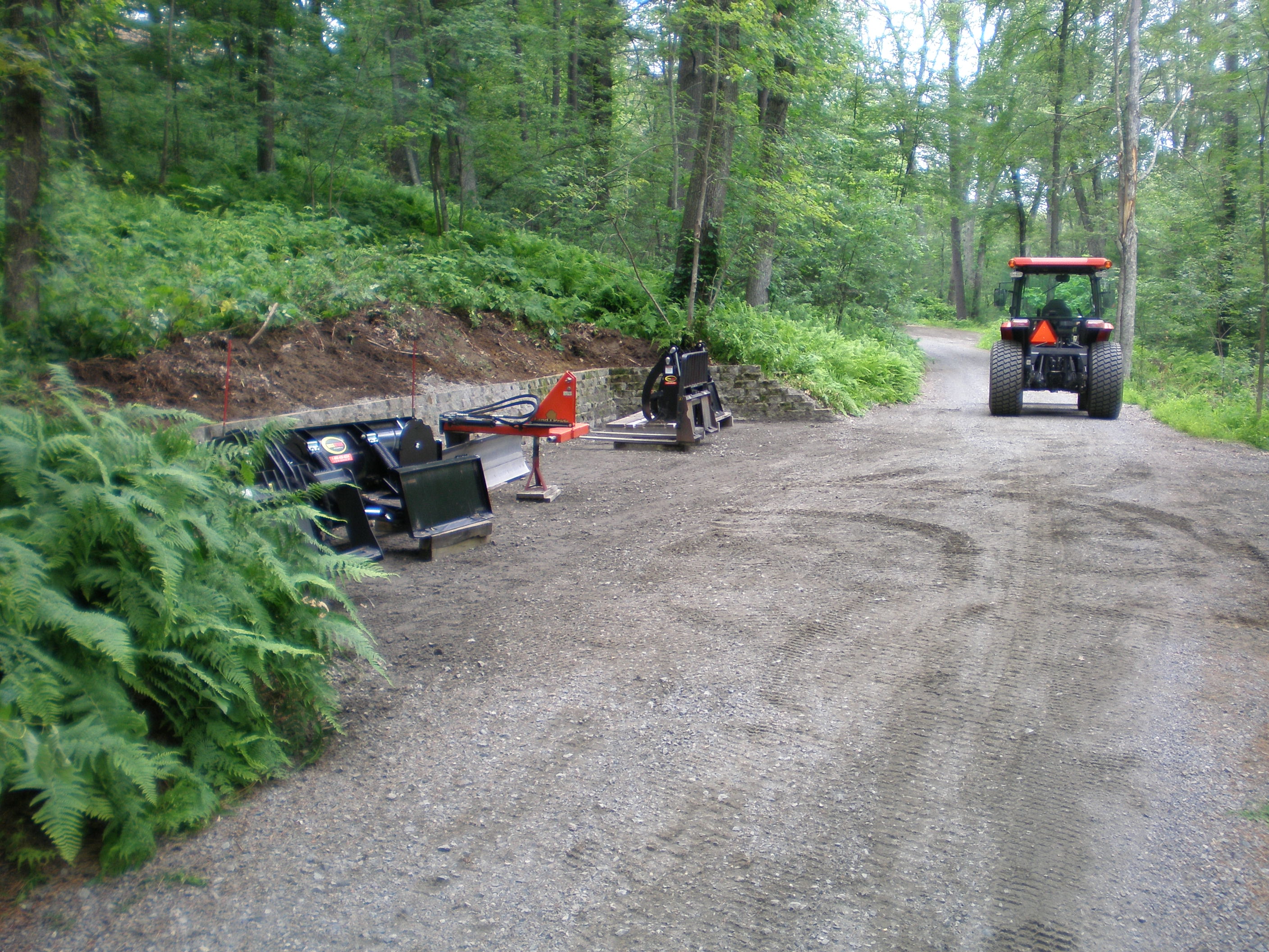

I have a 1000' driveway and it meanders thru the woods and up hill to my house. On the hill the excavator put 'rip-rap' and pushed it into the ground by driving his TLB over it, then used 3/4" 'crush-n-run' over it. the hill continues to was out looking like the Grand Canyon but I use my grader blade on my Kubota to drag it back up the hill and back grade it to smooth out and fill in any ruts left. That said, the longer flat run I use the 3/4" 'crush-n-run' for stays in place fine. Like you, the original drive was dirt and clay, and I try to build up one side so the water runs off to the side that has wet land. P7040010.JPGP1280009 (3).JPGI know the snow picture doesn't show the gravel, but you can see how steep the hill is.

The problem is I can not take anymore trees down from the right side to add a ditch to the other side of the road.
Would it be a better idea to add more dirt to that side so that the water rolls to the left of the road? I mean, I suppose that would be my only option at this point.
What is a tin whistle drainpipe?
Why can't you take any trees off the right side of your drive? Is it a property line?
Best to approach this by getting back to the basics:
Water will go where water wants to go
Be a fanatic about about your driveway contours and elevation so there never any standing water. That can mean a crown, roadbed sloped to one side, deep enough ditches, swales, etc. Whatever you decide, it probably has to be a little more pronounced than you first think.
Have good material on the roadbed
I will leave it to others to chime in on base, fabric, gravel, etc. That said, get the contours and ditching/swales right first. Standing water is your enemy.
