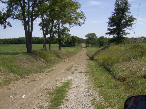

Around here a "dirt road" is just that, DIRT, the next option is gravel (crushed limestone). I prefer nothing bigger than 3/4", then when packed good, my drive gets only 3/8" "chips". The 3/8" makes a much better surface for walking, but I wouldn't use it on a long drive or "lane".
Picture is the county line road at the farm! ~~ grnspot
